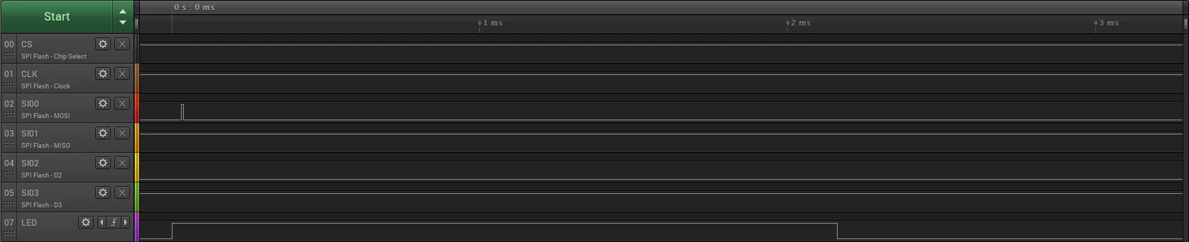

STM32L452 QSPI no output
Hi
I am using a STM32L452 MCU with a quadspi flash from Micron.
I configured the board using CubeMX and have tried making a test code based on the example in: STM32Cube_FW_L4_V1.15.1\Projects\STM32L476G-EVAL\Examples\QSPI\QSPI_ReadWrite_DMA
I'm trying to read the Manufacturer ID on the flash but I'm not getting any of the signals on the datalines.

Mads Skov
Mads SkovBest answer
Apr 1, 2020 2:22 PM UTC
Turns out there was a faulty connction on the PCB.
Thank you for the help though.

Pin initialization looks Ok.
Size, Clocking and Prescaler look incorrect.
Check for error responses.
QSPI_CommandTypeDef qspiCmd = {0}; // ensure local/auto variables are clear
sizeof() in Transmit gives wrong length for use case, try
  HAL_UART_Transmit(&huart4, usartTxBuffer, sprintf(usartTxBuffer, "Error: Write Enable Failed"), HAL_UART_TIMEOUT_VALUE);
