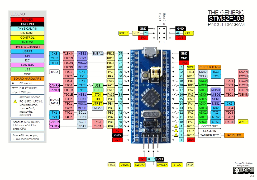

Curious detail on the huge spread "blue pill" boards :
the LED is on pin ..what is to be expected? PC13 !
Tesla DeLorean
Guru
May 27, 2023
Poor choice in general as it's a low power / current pin too.

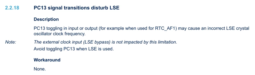

waclawek.jan
March 30, 2024
In the newest STM32F407 errata (ES0182 - Rev 15, 12-Feb-2024 ) the erratum in question has been rephrased (it's the only change in this version of errata):
(I guess other errata have been updated with similar wording, did not check).
