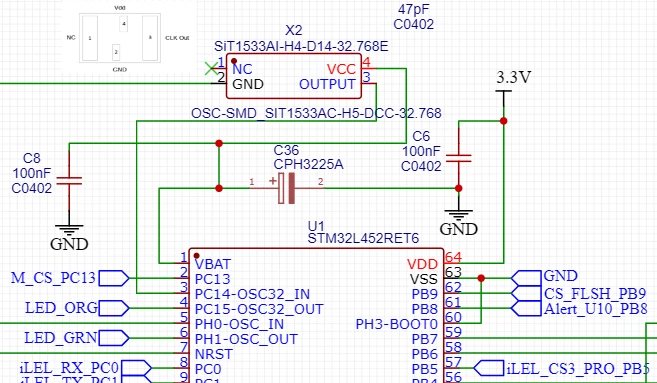

STM32L452 LSE not starting
I have an STM32L452 rigged to use an external clock so we can keep the RTC running. Schematic attached.LSE_schem.png
X2 is a clock from SiTime, programmed to be 32.768kHz. C36 is a supercap acting as battery backup. I used STMCube to generate the startup code to feed into HAL_RCC_OscConfig. When I debug into this function, the LSE never becomes ready (RCC_BDCR_LSERDY bit always zero), and so the code returns HAL_TIMEOUT.
Do I have the correct circuit? Have I set the clock config correctly? It's the same if I run on a Nucleo board.

Turns out that the wrong clock chip had been fitted - they'd used the low-power variant, so the swing on the clock signal was not sufficient for the processor to detect.

where is the vbat power coming from ?? CPHxx is a big cap - and empty. needs some diode or so from vdd -> cap, to charge it. otherwise the 32khz osc never gets power.

My colleagure assures me he can see the 32768Hz clock on a scope. I use VBAT output to pwoer the supercap thus:

AScha.3
Nov 8, 2023 5:51 PM UTC
ok, so cap is charged by cpu internal 1k5.
so maybe you have to wait more time, until 32k osc signal "ok" .
or/and reset restart rtc , when signal "ok".

Wouldn't put a LED on PC15, it low current, and on the battery/low-power domain
RM suggests some sequencing is involved LSEON needs to be zero to enable LSEBYP.
You should be able to a) get the LSE out of a pin, b) measure the frequency with a TIM internally.

I looked at the clock going into the RCC_OSC_In pin (3), and saw a 32.768 pulse. There only looked to be around 1v peak height. What sort of amplitude should it be? LSE.bmp

I mean your config is wrong. For external active clock you in wizard ioc need config BYPASS and in config sysclock then is generated
RCC_OscInitStruct.LSEState = RCC_LSE_BYPASS.

Schematic is wrong???. How is it going to work if you don’t have power on Vbat? You’ve placed a capacitor, and that’s it. You’re missing a diode to 3V3; otherwise, how is the capacitor going to charge?
Maybe that series has the diode integrated into the chip or a different system to provide power from the CPU to the external circuit?
MM..1
Mar 25, 2025 4:49 PM UTC
No diode, but switch internal. Read my forward up...
