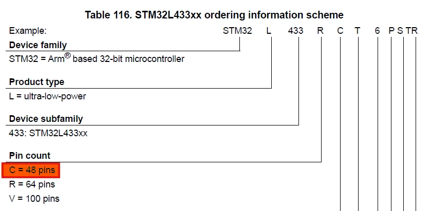

Hi.
For our footprint definition we require a confirmation from you:
  1.  The letter ‘C’ in the Pin Count ordering information is used for both 48 and 49 pins packages.
  1.  The WLCSP package is 49 pins.
Thanks in advance,
Noam
KDJEM.1
KDJEM.1Best answer
Jun 11, 2026 3:00 PM UTC
Hello ​@Noam_MSI ;
The C" refer to 48 pins /49 pins in Pin count and "Y "refer to WLCSP.
These typos will be corrected in the coming datasheet version.
Thank you.
Kaouthar

KDJEM.1
Jun 10, 2026 12:41 PM UTC
Hello ​@Noam_MSI and welcome to the Community;
Thank you for bringing this issue to our attention.
I reported this internally for checking and fixing.
Internal ticket number CDM0063389 (This is an internal tracking number and is not accessible or usable by customers).
Thank you.
Kaouthar
KDJEM.1
KDJEM.1Best answer
Hello ​@Noam_MSI ;
Thank you.
Kaouthar
