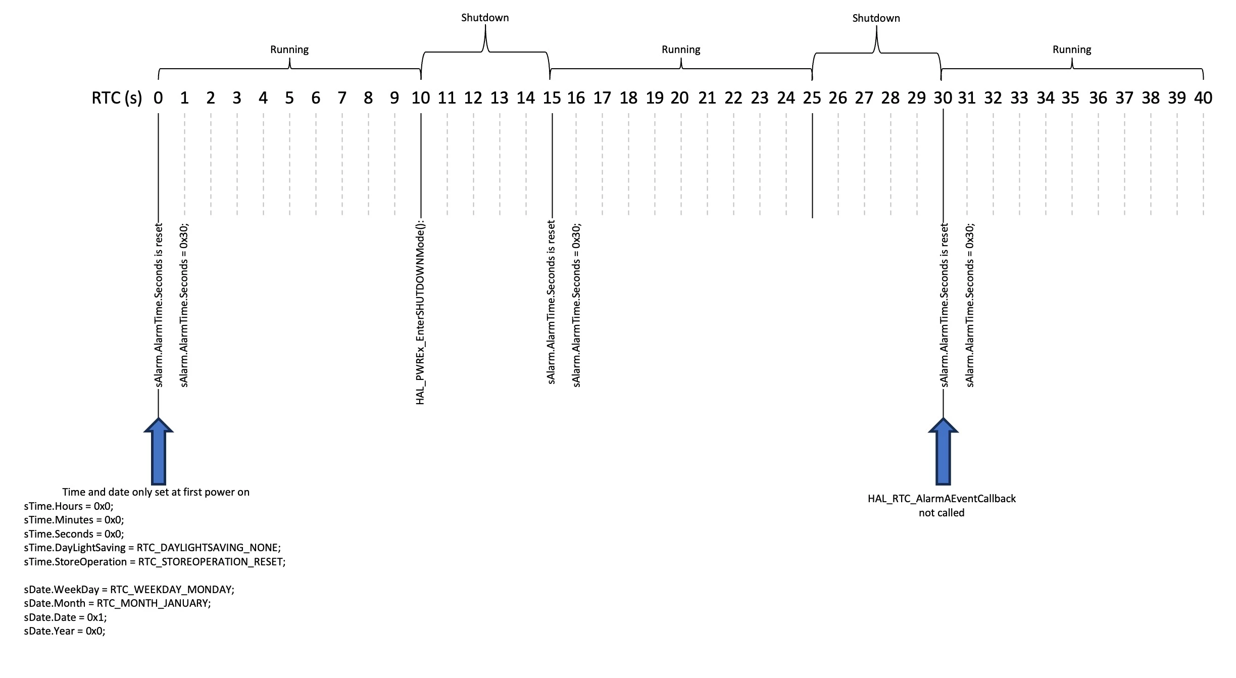

Is the problem caused because sAlarm.AlarmTime.Seconds is reset when shutdown ?
For test purposes, I am using the following settings:
  • RTC Wakeup Timer set to 5 seconds
  • RTC Alarm set to 30 seconds
The MCU runs for 10 seconds, then shuts down for 5 seconds using the functions:
  • HAL_RTCEx_SetWakeUpTimer_IT(&hrtc, 5, RTC_WAKEUPCLOCK_CK_SPRE_16BITS);
  • HAL_PWREx_EnterSHUTDOWNMode)
When the MCU wakes, sAlarm.AlarmTime.Seconds is zero, so I have to set it back to 0x30 (should it be 0x30 or decimal 30, I'm not sure because its BCD ?).
The diagram below explains what I think might be happening, it should fully shut down and not wake again when the alarm is reached (30 seconds).  But maybe it doesn't because sAlarm.AlarmTime.Seconds is reset when shutdown. ?
The application is battery powered and once manually switched on, it is supposed to read a pressure sensor every few minutes then shutdown between each measurement.
After 12 hours of being switched on, it is supposed to permanently shutdown and not wake again until switched manually on again.
I am using shorter times for test purposed, the 5 second shutdown and wake for 10 seconds works.
But the permanent shutdown (set by sAlarm.AlarmTime) is not working.
I have either implemted this wrong or it is not possible ?

I only initialize the RTC once, because I check if the MCU was woken by the RTC as follows...
	if (__HAL_PWR_GET_FLAG(PWR_FLAG_SB)) {
		// Woke from standby
		__HAL_PWR_CLEAR_FLAG(PWR_FLAG_SB);
	else
		 MX_RTC_Init();
I set a breakpoint on the line MX_RTC_Init() and the breakpoint is only hit on the first startup.  When the RTC wakes the MCU, the breakpoint is not hit.
The diagram below shows the behavior I expect...
The diagram below shows what is actually happening, with the following observations made...
  • shutdownRun called at 25 seconds, but it does not shutdown and continues running
  • shutdownFull is not called at 30 seconds (sAlarm.AlarmTime.Seconds was set to 0x30)
  • sAlarm.AlarmTime.Seconds is reset when woken by the RTC
    • is this not to be expected as when the MCU is shutdown all variables are lost, so how is this supposed to be handled ?
The diagram below shows the alarm works if I don't shutdown with RTC wake...

The problem is you cannot use both at the same time for wakeup from Shutdown or Standby without reconfiguring the EXTI line.
Why Your Alarm Doesn’t Work After Wakeup Timer
When you set HAL_RTCEx_SetWakeUpTimer_IT, it configures EXTI line 22.
Then, if you later configure HAL_RTC_SetAlarm_IT, it sets EXTI line 17.
But the STM32 only supports one EXTI wakeup at a time in Shutdown.
So the last one you configure takes precedence, and the other is ignored.
The suggested fix is

Although from your graphic i guess the first wakeup from wakuptimer is happening, isn't it? Make sure the wakup flag is getting cleared properly, usually generated automatically in stm32xx_it.c file. Can you sum up the current issue in 3 lines max clearly please?
