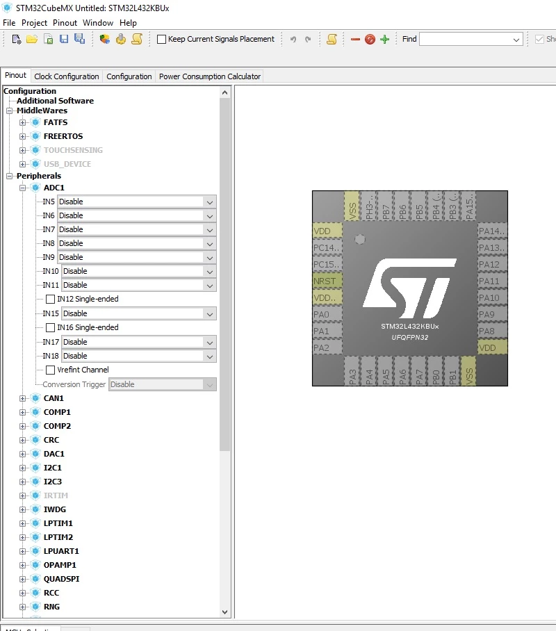

did you check the cube ?
checking now, set PA0 to Analog..
ooops there is no AD0 on this processor, according to the cube...

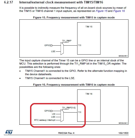

"10.3.5 From HSE, LSE, LSI, MSI, MCO, RTC to timer (TIM2/TIM15/TIM16)
Purpose
External clocks (HSE, LSE), internal clocks (LSI, MSI), microcontroller output clock (MCO),
GPIO and RTC wakeup interrupt can be used as input to general-purpose timer (TIM15/16)
channel 1.
This allows to calibrate the HSI16/MSI system clocks (with TIM15/TIM16 and LSE) or LSI
(with TIM16 and HSE). This is also used to precisely measure LSI (with TIM16 and HSI16)
or MSI (with and HSI16) oscillator frequency.
When Low Speed External (LSE) oscillator is used, no additional hardware connections are
required.
This feature is described in Section 6.2.17: Internal/external clock measurement with
TIM15/TIM16.
External clock LSE can be used as input to general-purpose timers (TIM2) on TIM2_ETR pin, see Section 27.4.19: TIM2 option register 1 (TIM2_OR1).
Active power mode
Run, Sleep, Low-power run, Low-power sleep."
I find this paragraph not to be helpful, I don't see how HSE can clock any of these TIM directly, it is not a routable peripheral clock, and can only act as a source in the sense that I have to use HSE as SYSCLK.
I can measure PA0 (CK_IN) frequency via TIM2_CH1 in External Clock mode, I coded this myself, as NO examples of this TIM mode in the Cube/HAL trees. The casual STM32 user might not even identify this as a possibility, and the section here wouldn't alert the user to such an opportunity.

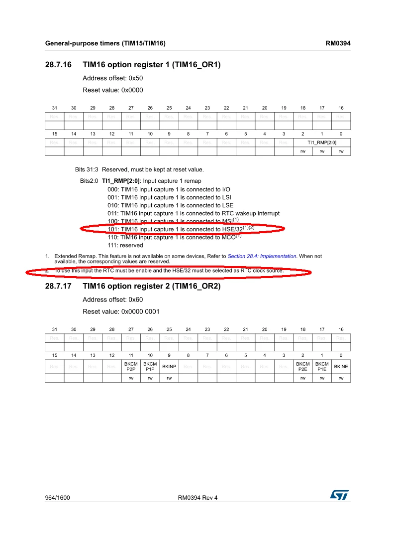

It sill can internally connect to the same node as the output from the "real" HSE; and may have the same treatment as far as GPIO goes, i.e. switching HSE on (RCC_CR.HSE_ON=1) may disable GPIO's PA0.
The idea presumably is, that you clock TIM from a different clock, and use capture to determine their mutual relationship. HSE/32 can be mapped to TIM16 input capture, see TIM16_OR1.TI1_RMP
An interesting remark in chapter 28.4 Implementation of RM0394, which says that "The extended remap [...] is not available on STM32L471xx devices.", while RM0394 is not pertinent to the 'L47xx...
The "Interconnection" chapter can be significantly improved, I agree.

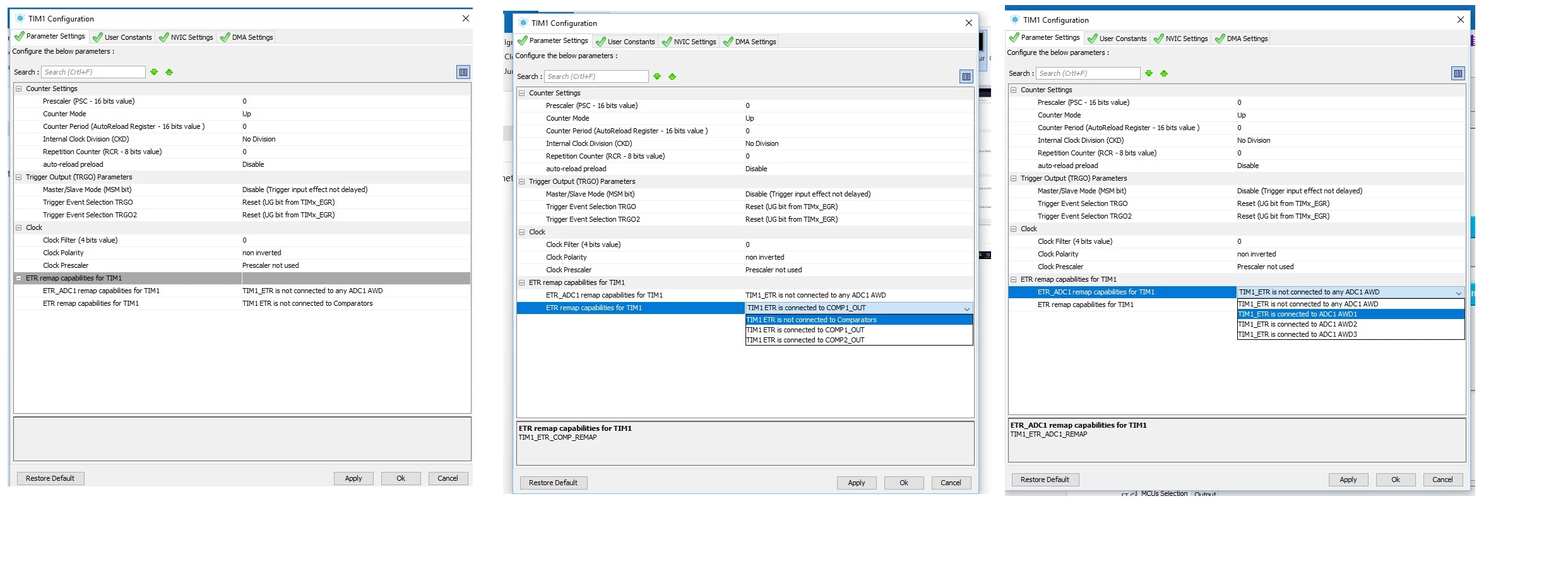

How did you set the clock input ? which timer ?
the cube selections attached:

I didn't see the HSE/32 option for TIM16, I'll look at it again. Perhaps via RTC clocking from HSE divided down. I'm using an L432KC (32-pin QFP) in the context.
If the footnote is true, it's not very useful if you intend to use RTC too.
In the "Big Orca" 'L4 RM0351 rev.5 there is no such note (the HSE/32 is said to be connected to TIM17 there).
Tesla DeLorean
Guru
October 25, 2018
More crappy documentation, the section describing this functionality for the upper bit patterns is missing. The bits are described in the STM32L432xx.h file and the related TIM HAL/LL files via a #ifdef
On other plaforms this is called RTCCLK, because it is only technically HSE/32 under specific conditions. Arrgghh!!

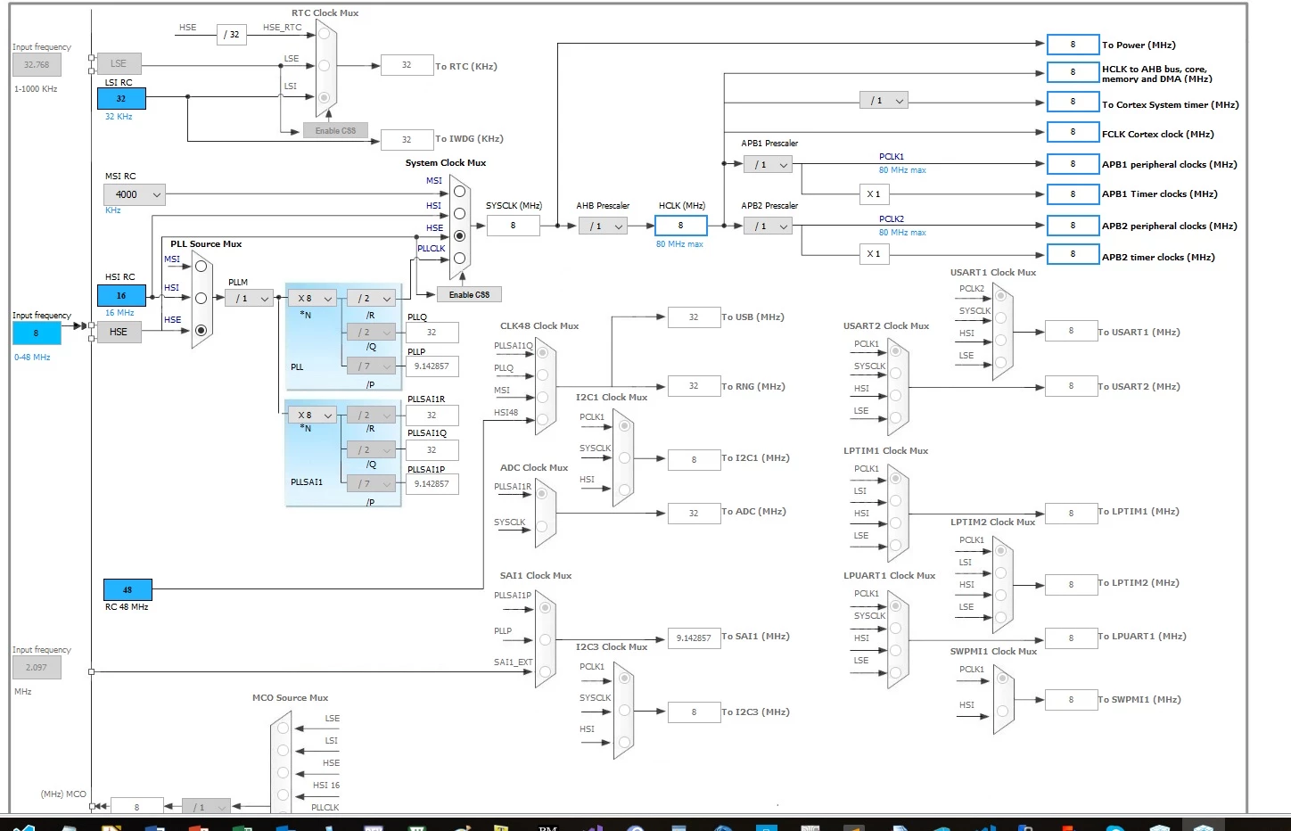

Yes the cube shows, HSE can be routed to the timers by
PLL source HSE -> PLLM to system clock source -> sysclk to APB1 Timer clocks
however,
LPTim1/2 can only be clocked by PCLK1, LSI, HSI, LSE not HSE

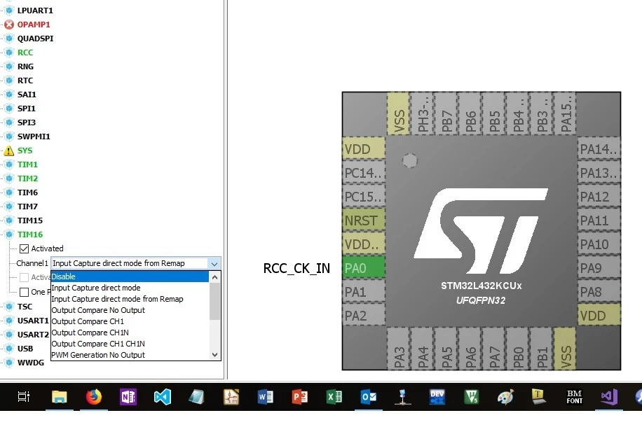

October 25, 2018
Tim16 options from the Cube..
Tim16 can be activated or not... there is no selection for clock source.
Tim16_Ch1 has options shown.
Tim16 runs from HCLK.
LPTimers do not.
 ooops wrong image !
