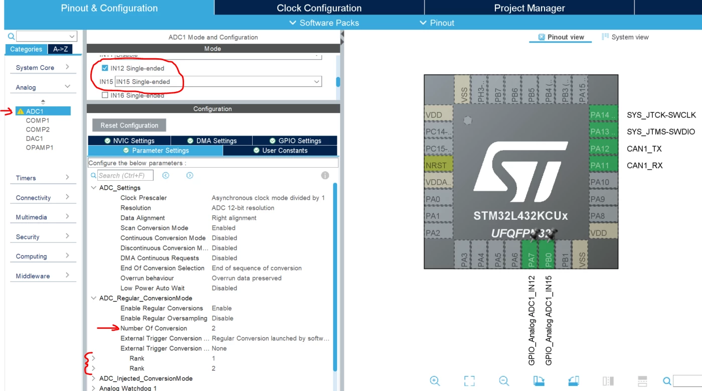

I am trying to get information from two analog sensore (FSRs) by using two seperated data lines (PB0 as IN15 and PA7 as IN12) through ADC1
(Not important note - I created unint32s for debuging and I am willing to transfer the data by using CANBUS as you can see in the main.c)
The problem:
I am getting the information from the sensors, but the data of one sensor gets corrupted by the other one. For example if I pinch the left FSR his data chanegs from 10 to 4095 but if I pinch the right sensor, the left sensor data still changes but from 10 to 800. The exact same thing happans both sides. What could be the problem? How can I make the data line seperated from eachothers?
I am attaching the main.c and the configurations.
In addition its on Circular Mode, Increment address is only Memory and with Data Width of a Word
Thank you,
Raam Kavod

Hello @RKavod​ ,
I ran your main.c in my nucleo and I didn't see any issue with you code. The data weren't corrupted and were independent.
I might come from your sensor. Is it possible to check the voltage by a scope or to test them one by one,

I didn't try with FSRs sensor (I don't have it) just with wire connected to the ADC_INPUTs. However, I just checked your main and confirm at MCU level there is no issue.
Let's check with the scope or even with another ADC_INPUT. It should not come from the ADC as the channel are independents

There is one S&H cap for each ADC, a multiplexor switch connects one channel at a time to the S&H/ADC for conversion.
A hint - the 2cycles_5 sampling time is very short for a resistor network signal. ST has an application note on ADC Accuracy that explains it all.
