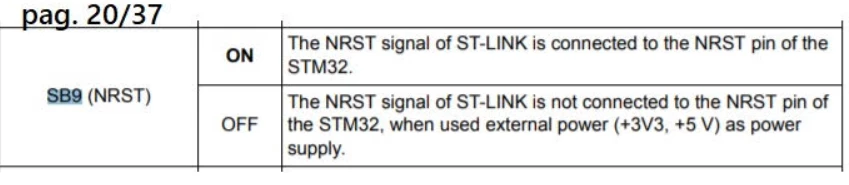

    I just remove jumper SB9 (between STLINK T_NRST and STM32L432 NRST) and both standalone run or STLINK debug run correctly.

    Hi! I considered valid the answer given by @MJean​. He said in this post:
    "I just remove jumper SB9 (between STLINK T_NRST and STM32L432 NRST) and both standalone run or STLINK debug run correctly". Also the NUCLEO manual said:
    You can consider also the possibility to put always high the value of the NRST pin connecting it with a 150 Ohm resistor, but I'm not sure about the correctness of this solution.

    Hi all, I know it'a bit old, but I'm facing exactly the same problem here, with a L432KC Nucleo-32 board: when powered through the +5V (CN4 pin 4), the board won't boot up. Ok, I've seen a few suggestions here, to solve this problem:
    1) close (on) SB9 jumper
    2) short NRST (CN4 pin 3) with 3V3 (CN4 pin 14)
    3) pull NRST up to 3.3V with a 150 Ohm resistor between RST and 3V3
    Solution 1 is permanent and won't allow programming the board through USB, unless physically reverting the SP9 configuration. So, I would go for 2 or 3, but I'm not sure what is the correct one. Pulling with 150 Ohm is a rather strong pull, similar to a short I'd say, so I wonder if anyone has measured the overall current drain in such a configuration, and if it will make the USB programming still possible.
    I still wonder why ST won't fix the User Manual, explaining that and providing a complete solution for an external power scheme. Is there an Errata around, by chance?
