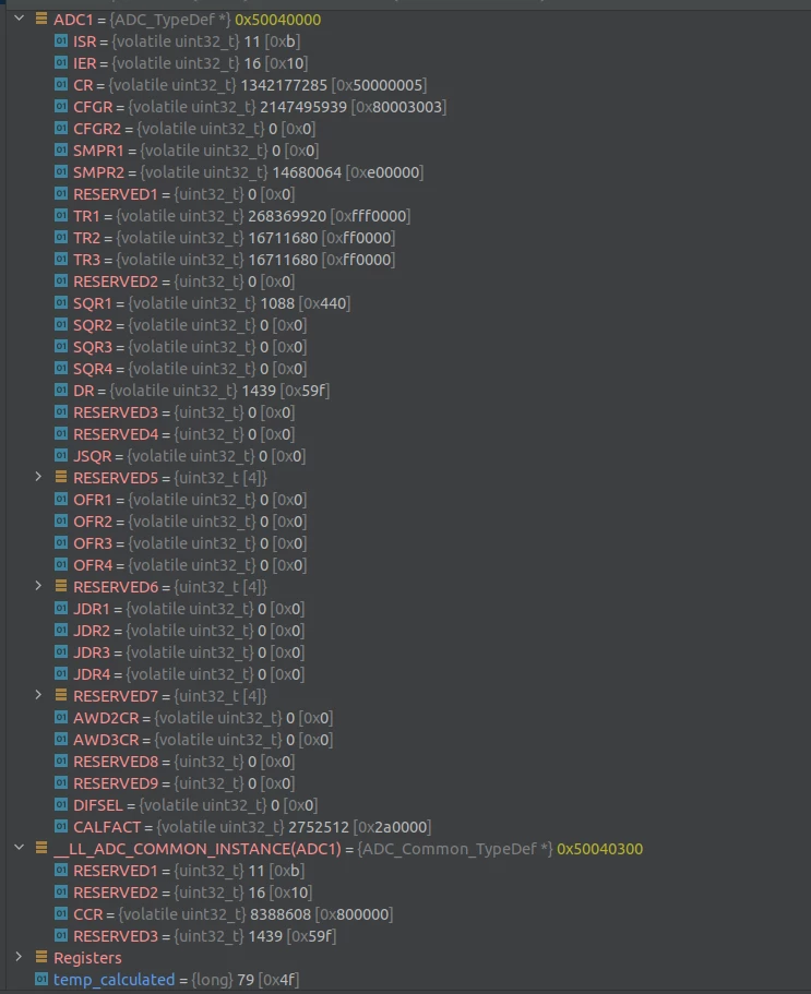

I'm trying to get the internal temperature sensor working on a custom board with an STM32L432KC. VDDA is 2.5V and is stable. The raw readings I'm getting are about 200 counts higher than I would expect on a 12bit config. The reading doesn't change based on temperature, usually I can see a 5 degree change if I shoot compressed air at the chip. I'm guessing I'm somehow reading a different ADC channel but I'm not exactly sure how to debug that. Attached are the register values after boot up.

Also, judging from ADC_CR.ADCALDIF being set, and the fact that ADC_CALFACT contains nonzero value only for the differential field, you probably did not perform single-ended calibration.

12-bit resolution I'm seeing 1714 counts +/- 3 counts. I've set the temp sensor up on STM32G474s, F217s, L475s, and G431s, on all of them blowing compressed air on the chip can cool it down from it's ambient temp of 30C to 25C.
In the screenshot in your initial post I see DR=1439.
PCarn.1Author
June 17, 2024
The one point in that list that does apply can be checked by the photo of the registers posted above. Ch17 is enabled.
