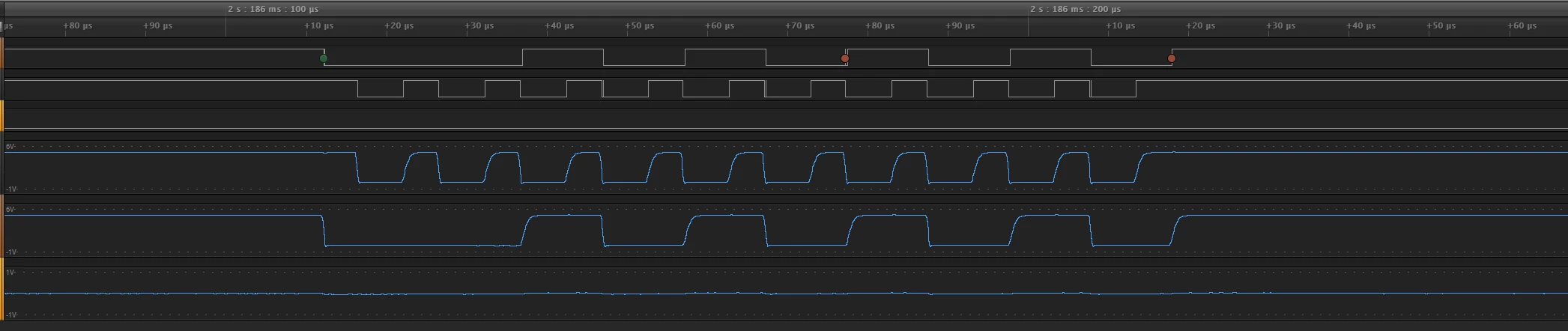

I recently brought up the I2C using the STM32CubeMx(4.0) and STM32CUBE_FW_L4_v1.6.0 and I was attempting to write to a slave device with an address of 0x2A.
I noticed that my slave device was NACK-ing back. Upon further inspection, it looks as if the address is shifted to the right by 1-bit, resulting in an address of 0x15 when transmitted on the line.
To test this theory out, I purposefully used an address that is shifted 1-bit to the left: 0x Doing so registered an address of 0x2A on the physical bus which then I was able to hit the register with some data.
I couldn't find any literature that required me to shift my I2C address left by 1-bit to have it address correctly. Has anyone else run into this issue?
My solution is a work around but I would like to understand the root cause of this issue; whether I introduced it or possibly an inherent issue with the HAL drivers?
Thanks!!

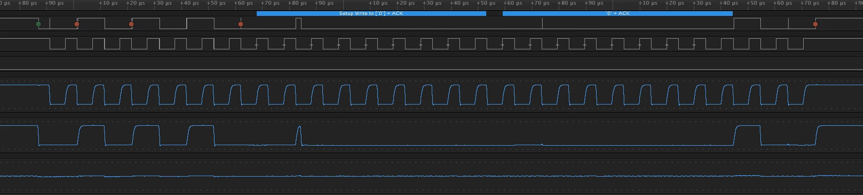

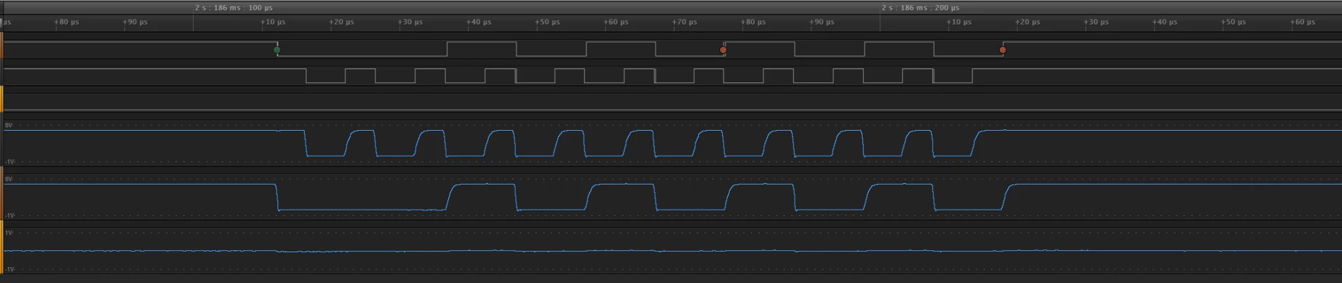

Output Using Slave Address 0x54:
Output Using Slave Address 0x2A:

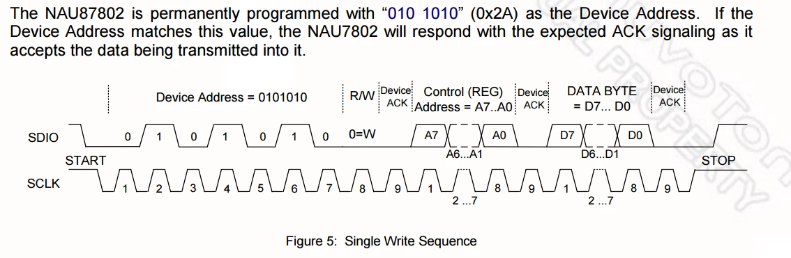

Datasheet I2C Output:

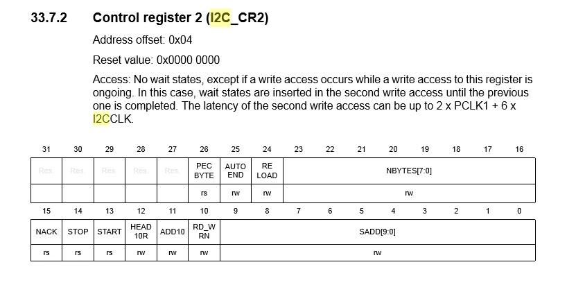

    waclawek.jan
    waclawek.janBest answer
    Feb 24, 2017 8:45 AM UTC
    Posted on February 24, 2017 at 09:45
    Ah,
    ... Maybe it's documented in the Cube functions' documentation, I don't Cube so I don't care to check that, you should.

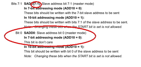

    I'm not exactly too sure if it is an issue with the address as providing it a larger address will still result in the same location within the register. See snippet of the datasheet below.

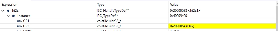

    I took a deeper dive to see where the slave address is being stored against the datasheets register. On the surface, the value at the register seems correct in both instances; 0x2A and 0x

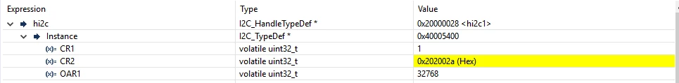

    I2C Slave Address Register Update (stm32l4xx_hal_i2c.c):
    static void I2C_TransferConfig(I2C_HandleTypeDef *hi2c, uint16_t DevAddress, uint8_t Size, uint32_t Mode, uint32_t Request)
     uint32_t tmpreg = 0U;
     /* Check the parameters */
     assert_param(IS_I2C_ALL_INSTANCE(hi2c->Instance));
     assert_param(IS_TRANSFER_MODE(Mode));
     assert_param(IS_TRANSFER_REQUEST(Request));
     /* Get the CR2 register value */
     tmpreg = hi2c->Instance->CR2;
     /* clear tmpreg specific bits */
     tmpreg &= (uint32_t)~((uint32_t)(I2C_CR2_SADD | I2C_CR2_NBYTES | I2C_CR2_RELOAD | I2C_CR2_AUTOEND | I2C_CR2_RD_WRN | I2C_CR2_START | I2C_CR2_STOP));
     /* update tmpreg */
     tmpreg |= (uint32_t)(((uint32_t)DevAddress & I2C_CR2_SADD) | (((uint32_t)Size << 16 ) & I2C_CR2_NBYTES) | \
     (uint32_t)Mode | (uint32_t)Request);
     /* update CR2 register */
     hi2c->Instance->CR2 = tmpreg;
    In the instance of writing 0x2A, the register value is 0x202002A:
    In the instance of writing 0x54, the register value is 0x2020054:
    These values line up with the register content located in the datasheet (DocID027294 Rev 2):
    I have also placed a watchpoint at that memory location and it does not change until the transfer is complete.
    I think my next steps are to obtain a different I2C device and see if I can interface with it there. I shall also attempt this with another NUCLEO board.
    waclawek.jan
    Feb 24, 2017 6:26 PM UTC
    Posted on February 24, 2017 at 18:26
    Read also the description of I2C_CR2:
