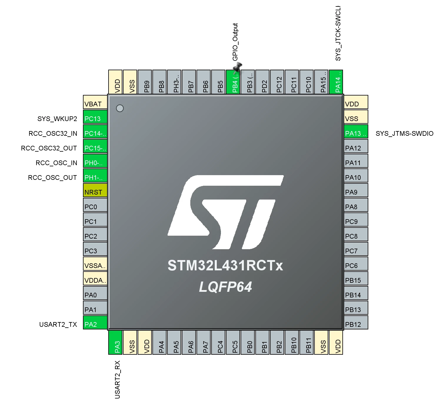

STM32L431RCT6 wakes up immediately after standby
I am trying to use STM32L431RCT6 with STM32CubeIDE and STM32Cube_FW_L4_V1.18.1 for a low power mode application. I tried Sleep mode, Stop mode and they both work OK. But the standby mode does not working. The MCU wakes up instantly after entering standby mode. CubeMX setup is as below, using SYS_WKUP2 as wakeup pin.

The UART terminal receives text:
[01:18:06.402]收←◆STANDBY MODE is ON
Wakeup from the STANDBY MODE
[01:18:10.428]收←◆Wakup from PWR_FLAG_WUF2
About to enter the STANDBY MODE
[01:18:14.190]收←◆STANDBY MODE is ON
[01:18:18.216]收←◆Wakup from PWR_FLAG_WUF2
[01:18:21.979]收←◆STANDBY MODE is ON
[01:18:26.004]收←◆Wakup from PWR_FLAG_WUF2
I have tried STM32L031F6P6, it could enter standby mode and wake up by RTC. What happened with STM32L431RCT6?
Thank you for your help!

The HAL_SuspendTick() and HAL_ResumeTick() are used with SLEEP Mode and STOP Mode functions and work well. In STANDBY Mode, it is like the MCU being Reset then start on with only RTC information and some backup registers preserved.
The same code works with STM32L031F6P6.
NEdom.1
NEdom.1Author
November 19, 2024
I reconfig the clock, the HSE and LSE. After generating the code and flashing, the standby mode is activated.
Try to change HSE and LSE back, or several compositions. Things goes normal.
Try to add back FreeRTOS. All is good.
Very strange STM32CubeIDE behavior. However, I like this IDE tool.
