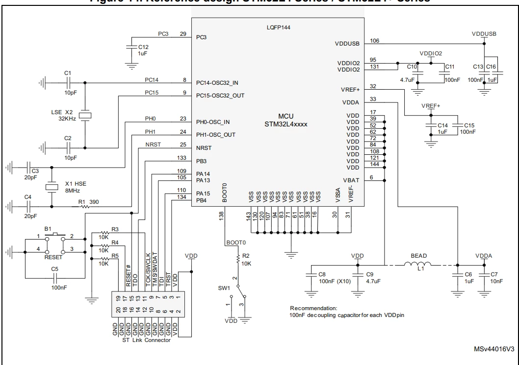

Greetings! I am using STM32 for a very first time. I made my custom PCB with 10MHz oscillator. In the Clock Configuration window I have sellected the PLL and the HCLK is set to 80MHz (max for the uC). The outputs are all 80MHz. So I made a simple blink test program:
 /* USER CODE BEGIN WHILE */
 while (1)
	 HAL_GPIO_TogglePin(LED_1_GPIO_Port, LED_1_Pin);
	 HAL_Delay(1000);
 /* USER CODE END WHILE */
 /* USER CODE BEGIN 3 */
The problem is my code blocks in HAL_Delay(). Here to be precise:
while ((HAL_GetTick() - tickstart) < wait)
I checked with oscilloscope and the quarz is working! I also tried different interrupt priorities for Sys Tick Timer.
Any other suggestions?
I have no experience with these uC.
Thanks!

Is that possible to share the part of the crystal connected to the MCU + the part of the LED connection with the MCU.
When you set a break point at HAL_GPIO_TogglePin(LED_1_GPIO_Port, LED_1_Pin) are you able to reach it?

Sorry for the late responce! It seems my pcb is working correctly in release mode => when I program the uC. So I suppose the problem is in the selected debuger type. I am using ST-Link as a tool and I connected every jtag related pin to the connector. I didn`t know what to expect so I prepared the pcb for everything. I have TRST, TDI, SWDIO, TCK, TDO and NRST connected to ST-link. In the .ioc I have selected JTAG(5 pins). Is that correct? What should I use for this controller?
Thanks!
mƎALLEm
February 25, 2025
Please refer to the AN4555 / Figure 14. Reference design STM32L4 Series / STM32L4+ Series:
And use Serial Wire mode.
stoyanoffAuthor
February 26, 2025
Hi! I fixed it! It seems this uC demands ROM boot mode selected. I selected RAM in the beginning which is common for TI uC. I though I have to switch  to ROM when I am ready, but here this is not the case...
