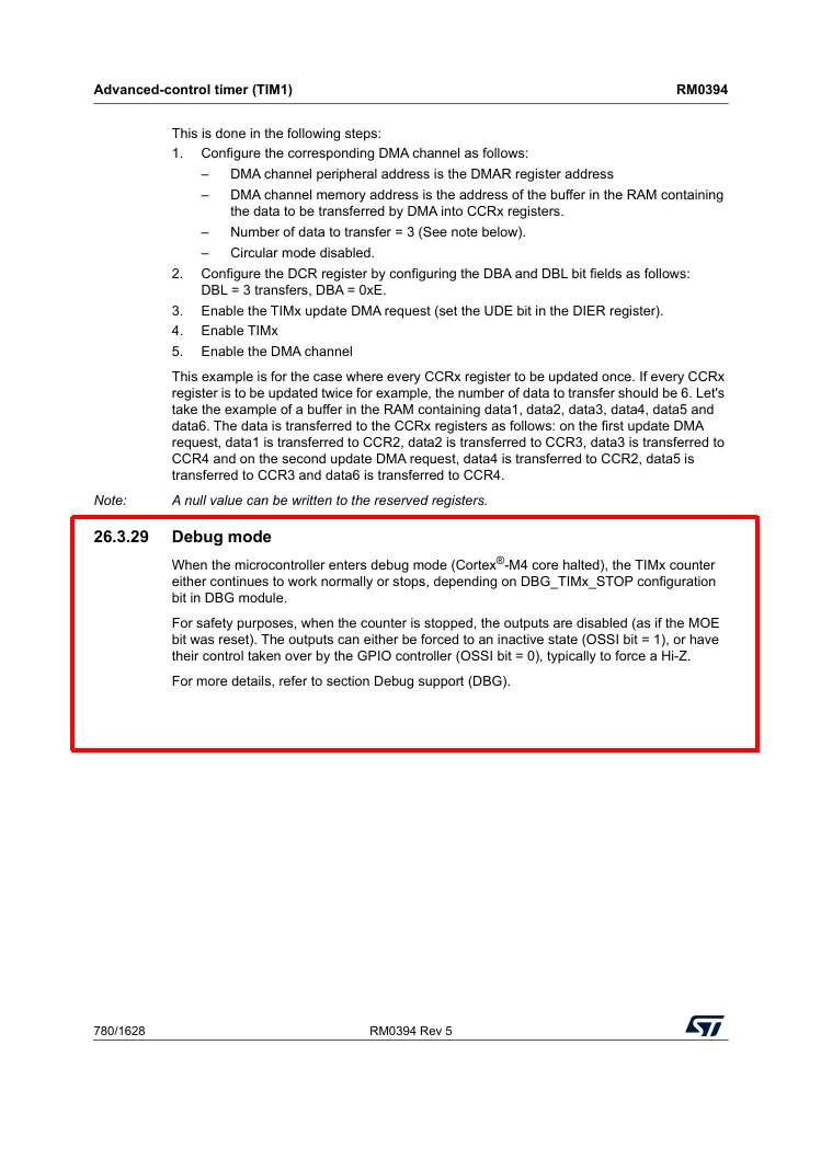

waclawek.jan
waclawek.janBest answer
Jul 16, 2026 8:31 AM UTC
Hi ​@hiroyuki kato ,
I successfully reproduced the described behaviour.
However, turns out, it’s documented:
Yes, it is surprising.

waclawek.jan
Jul 16, 2026 10:18 AM UTC
One more detail: the whole BDTR-related machinery (including MOE) influences only the complementary channels.
In ‘L4, TIM1_CH4 is *not* complementary, so that will probably remain driven also during the debug freeze.
I did not test this one but I believe I am right with this detail.

as ​@waclawek.jan said its documented in 26.3.29 Debug mode section
