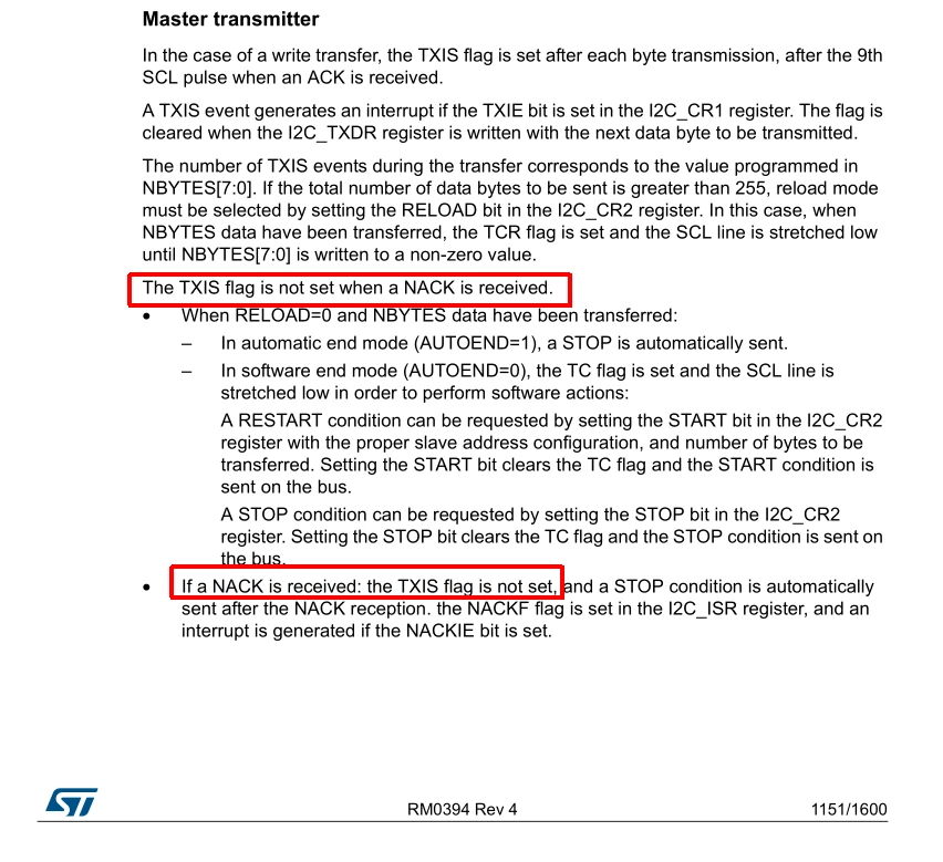

So, after effective NACK from slave, we have NACK+STOP+TXIS.
The documentation says, that NACK won't set TXIS. It says it *twice*:
What did I overlook?

Also, please note, that the observed behaviour contradicts the description in the documentation.

ST in the past few weeks rolled out a bunch of new RMs for STM32 families containing this version I2C, e.g. 'F303 or the mid-range 'L4 (RM0394 pertaining to the low-end 'L4 model from subject of this thread is still in rev.4 from 2016). In the above quoted section, the incorrect statement (i.e. that there is no TXIS after NACK) is now not twice but "only" once...

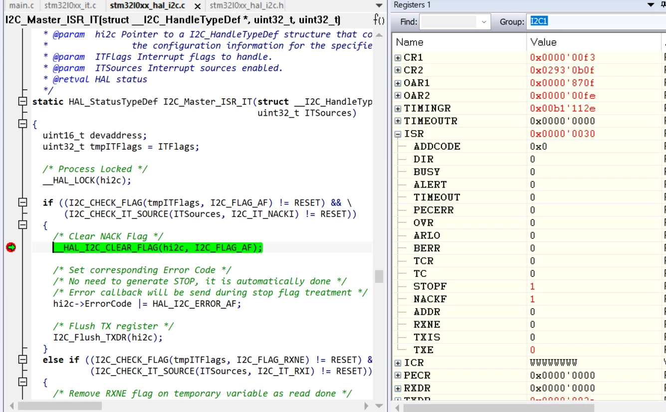

Can you please comment also on what's the original topic of this thread, i.e. that the RM's claim that NACK won't set TXIS is incorrect?

I tried to reproduce the problem you reported, but each time I generated a NACK, the master was like this. I tried different conditions, but I probably couldn't precisely reproduce the disconnection you referred to. would you care to post some screenshot from scope or logic analyzer?
My impression so far is that what you described in the original post is again a behavior violating the I2C standard and we cannot be expected to cover in our documentation every single error condition caused by that.
That's because your ISR already had served the TXIS in question. Proof is, that TXE is 0, i.e. there is already a datum in the holding register, which will never depart, as the internal machine already issued STOP. (This actually is one of the consequences of this whole issue: if you start another I2C transaction without resetting I2C, the byte which is already in the holding register will be immediately transmitted instead of address).
You can easily reproduce the problem according to my description in opening post, in IDE without gdb, by directly manipulating and observing I2C registers in the register view. You don't need to run any I2C-related code (e.g. just use a plain blinky, so that you can run the debugger at all). Stop execution, enable I2C clock in RCC and then follow the steps I've given above (gcc's command "set" means "set this value into this variable/register"; "p" means "print").

Oh, no, no, this is a perfectly legal behaviour, the receiver - here slave - can issue a NAK any time, as it wishes; see UM10204 (the I2C specification), chapter 3.1.6 Acknowledge (ACK) and Not Acknowledge (NACK), conditions 3 and 4.
But my complaint is *not* that ST doesn't document the behaviour upon NACK; contrary: as shown in the initial post, it *does* document it, but incorrectly...
