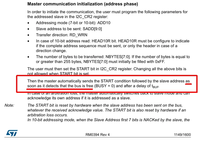

When I2C master transaction (both Rx and Tx) is started while SCL is pulled to 0 externally, it goes into BUSY mode (I2C_ISR=0x8001) and remains there indefinitely, without setting any interrupt-generating flag, even after the external SCL->0 is removed.
This is extremely simple to reproduce, well, just short SCL to ground and write any START-containing "command" to I2C_CR2; and then remove the short, while observing I2C_ISR. It's enough to do it in debugger with stopped processor, the result is obvious enough.
I expected, that either
1. I2C throws a BERR (I would prefer this, but BERR's description says its scope is limited to a very particular bus error involving only STOP and START - and the BERR-related erratum dismisses its real-world usability entirely), or,
2. upon removal of SCL->0 I2C proceeds with the transaction as normally.
Documentation says, it's 2.:
This issue - which I consider to be a flaw - makes implementation of a sturdy I2C master based entirely on I2C interrupts impossible; there must be an additional timeout implemented. Together with TXIS-when-NACK issue, it makes proper I2C software significantly more complex than if the I2C would be correctly implemented according to documentation.

If the SCL is tied to ground while the START is set in the I2C control register, the internal counter that normally brings SCL back high after start condition is not started, leaving the SCL low indefinitely.
The solution is not to set START when the bus is taken (SCL kept low). There are generally 2 ways to do that, on I2C interface with SMBUS features it’s possible to use TIMEOUT with TIDLE bit set to probe the bus, on all products it’s possible to simply look at the respective GPIO IDR bit to see if its value is 1.

Hi @FBL ,
Yes, that's the expected internal mechanism of this hardware bug; but knowing that won't help.
Problem is, that the SCL can be pulled down externally during START by any of the slaves, or due to noise.
In I2C mode, the SMBUS timeout is not available and user has to write code to generate timeouts in some other way; and then reset the I2C module to release SCL.
The second workaround you've mentioned does not work, if the pulldown occurs between reading GPIOx_IDR and writing to I2Cx_CR2 register.
Also, please note, that the observed behaviour contradicts the documentation, as I've highlighted above.
Can you please address these concerns.

A question about GPIO check implementation, indeed, the pulldown should occur between reading GPIOx_IDR and writing to I2Cx_CR2 register, could you check using the timeout feature with TIDLE=0 or implement timeout using for example Systick. If the I2C is detected to be stuck, toggling the PE will release it.
