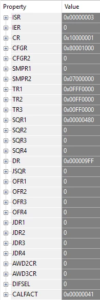

TClar.18
TClar.18Author
Nov 4, 2019 10:14 PM UTC
Please see below the ADC registers content after call to HAL_ADC_GetValue(), real VBAT is 3.0V.
Note that the data value is now DR=0x9ff=2559 (compared to the value 3839 above, for a real value of 3.0V).
Indeed, each time a hard reset occurs, values are changed but I still get linearly linked values (real/measured).
Otherwise, I have checked the registers content and it seems to behave as planned in the code (checked using RM0394).
waclawek.jan
Nov 5, 2019 2:10 AM UTC
I don't understand.
So, the ADC->DR register contains roughly the expected value, it's just that your program returns a different value?
