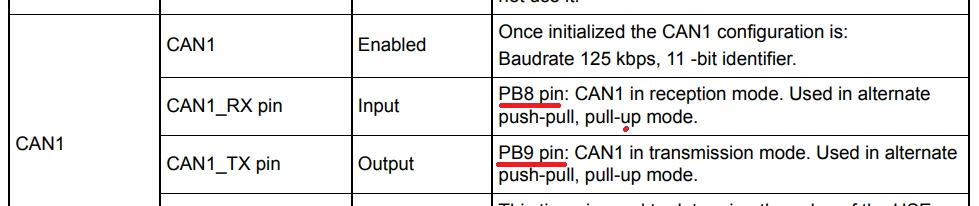

I use alternatives CAN pins PA11&PA12, based on spec standard CAN pins to use CAN bootloader are PB8-9. Is it possible to use PA11-12 to enter CAN bootloader or NOT? so far it does not work.

The CAN config is hardcoded in the bootloader and as per table Table 145. STM32L43xxx/44xxx configuration in system memory boot mode from AN2606 / Rev 63 page 332, the only GPIO resources available for STM32L431 chip are PB8 and PB9:
You may connect PA11 / PB8 and PA12 / PB9 in bootloader mode in your HW (while insuring PA12 pin is kept as input mode) then disconnect them after or using an external MUX.

For the CAN bootloader on the STM32L431, you have to use the PB8 and PB9 pins as indicated on the AN2606.
