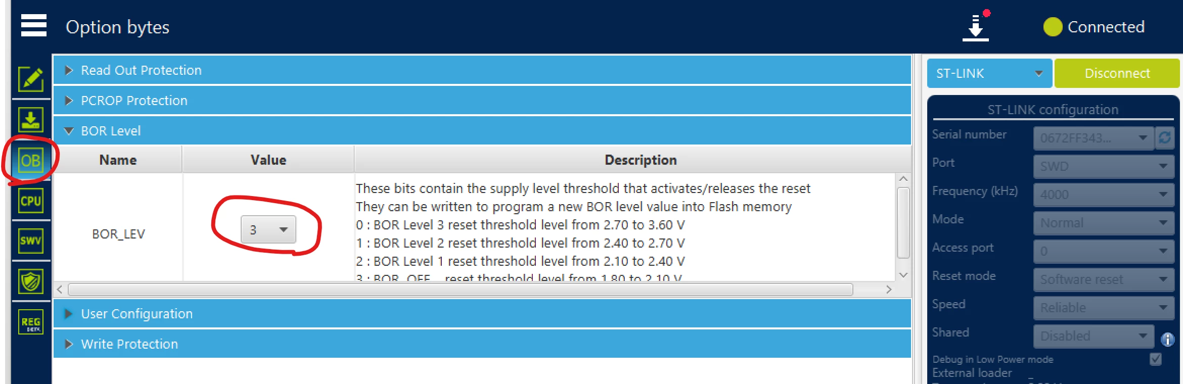

Is the option byte available in Cube IDE? I can't see it.
I've used the above code after initialisation and think it should be before initialisation, or better still in the option byte without a routine to change it.
You can adjust it in STM32CubeProgrammer along with other option bytes.
