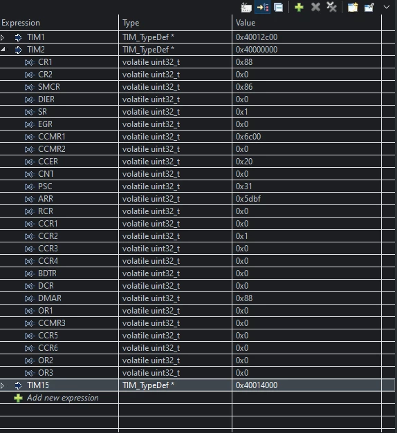

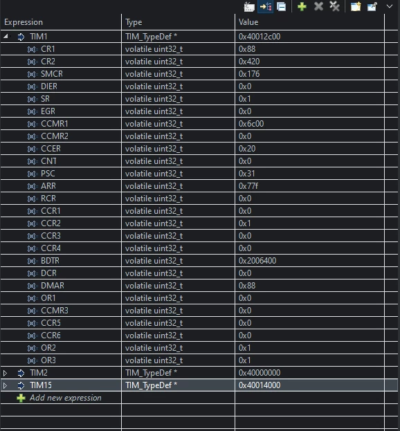

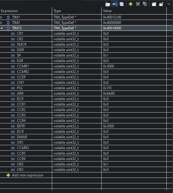

Timer 1
Triggered by external pin, should give one pulse of several ms
Timer 2
Triggered by update event of Timer1
should also give one pulse of several ms
Timer 15
used to generate a rising edge every second to test above 2 timers
I hope this way of sharing the timer registers is ok...
waclawek.jan
October 26, 2020
One-pulse mode is, that the next Update event clears TIMx_CR1.CEN, i.e. stops the counter. Nothing more, nothing less.
(Btw, what I said above is nothing else just rephrased explanation of the OPM bit in TIMx_CR1 in RM. Most of what I say is just that.)
So, I assume your internal timer clock is around 50MHz, i.e. one tick is 20ns. Let's first assume CCMR1.OC2FE is *not* set. For TIM1, you have set PSC=50-1, so timer counter is incremented at 1MHz pace, when enabled. You enable it from the slave-mode controller from ETR, and you've set a 2-clock filter on ETR (bit 8 of SMCR is set), so there's an input sampling uncertainty of 0..1 clock, plus delay of 1 or 2 cycles on the filter (I am not sure how is it exactly implemented), plus some delay in the slave-mode controller, not specified by ST, IMO it will be 1 or 2 clocks; that then sets CR1.CEN and the prescaler and from it the counter start to count. CNT = 0 initially and prescaler is reset from previous action (this detail can be discussed further, but generally after a previous OPM cycle this is true), so it takes 50 cycles of prescaler counting until CNT increments from 0 to 1. At that moment, comparison with CCR2 comes true, and as CH2 is set to Output Compare and PWM1 in CCMR1, the internal OC2REF signal (result of comparison) goes from active to inactive, and as CH2 polarity is inverted in CCER, that would mean the output pin would go from 0 to 1 at that moment - except that channel 2 is not enabled in CCER and also BDTR is set to something not entirely trivial, I'm not sure what's your intention there. In further I assume CCER.CC2E=1 (and CCER.CC2P=1 as is now) and BDTR.MOE=1, so that the output pin reflects the state of the internal logic. There may be some delay from OC2REF to the output pin, presumably 1 clock.
The prescaler+counter continue counting, up until CNT=0x77F=ARR, and prescaler=0x31. One cycle after that, CNT=0, prescaler = 0, Update event is generated, which clears CR1.CEN and both prescaler and CNT stop counting. At the same time, CNT is no more higher or equal CCR2, which means OC2REF goes from active to inactive, thus pin goes from high to low.
In other words, at 50MHz, after the input at ETR pin goes from low to high, the CH2 pin goes from low to high after (2..5 + 50) clocks (i.e. cca 1.04..1.1us), and then after further (50*1919) clocks (i.e. 1.919ms) it goes to low, and stops, waiting for further rising edge on ETR.
Now if CCMR1.OC2FE is set, the incoming edge, after being filtered, goes through a shortcut immediately (more precisely 3 clocks are specified in the RM, although it's not clear from which to which point exactly) to the compare unit and forces the internal OC2REF signal to go as if there would be a match - i.e. for PWM1, it goes from active to inactive, and the inverted output pin goes from low to high. So, the rising edge of CH1 output comes after cca (2+3+maybe 1) clocks (i.e. cca 0.1..0.12us). The prescaler/counter starts counting exactly as in the previous case, and when CNT increments to 1, nothing happens, as OC2REF is already inactive; then after further (50*1919) clocks prescaler/counter stop to count and output pin goes to low in the same way as in the previous case. So, here, the output pulse length is altogether cca 1.920ms (minus the 0.1..0.12us).

But I think you mixed up polarity in the second part:
> CNT increments from 0 to 1. At that moment, comparison with CCR2 comes true, and as CH2 is set to Output Compare and PWM1 in CCMR1, the internal OC2REF signal (result of comparison) goes from active to inactive, [...] output pin would go from 0 to 1
> The prescaler+counter continue counting, up until CNT=0x77F=ARR, and prescaler=0x31. [...] OC2REF goes from active to inactive, thus pin goes from high to low.
Nevertheless I now understand why OC2REF is active during the "idle time" between two triggers. On update event CNT is reset and the comparison result is false again. And this state is maintained until the next compare match occurs.
So the heading for my question is wrong, the output actually resetting is what troubled me ;)
