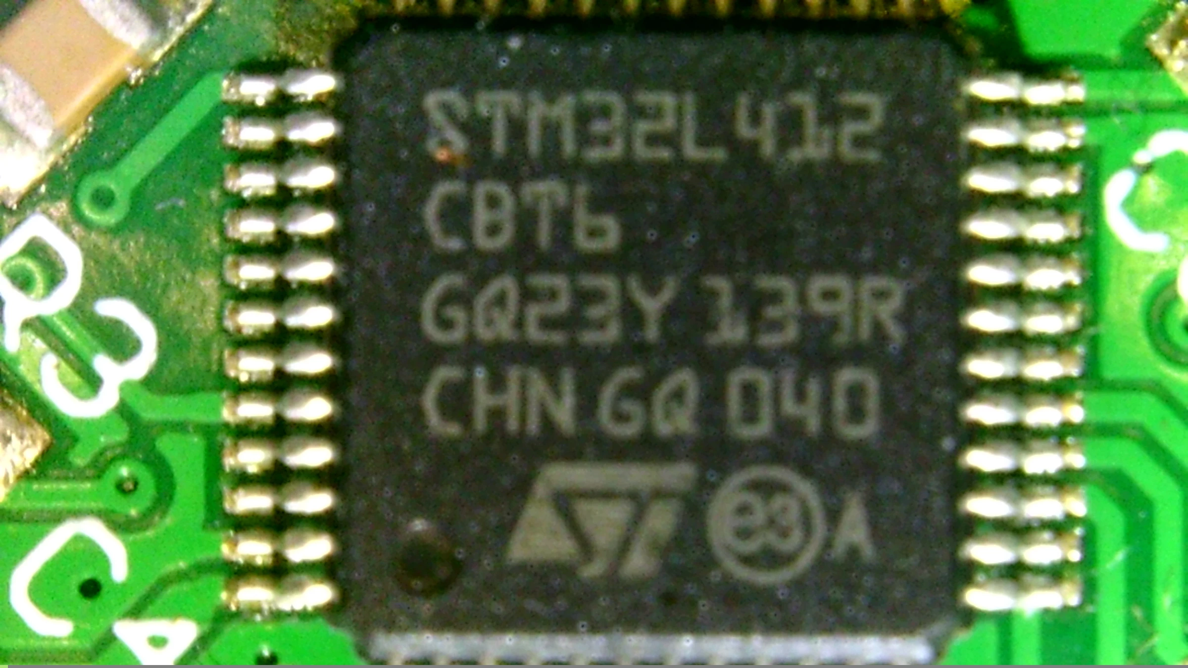

The soldering looks pretty good. This is a picture of the patient that I took with a different purpose than to show the soldering. (So that's why half the pins are out of frame)0693W000006HFOGQA4.jpg
Yeah. I should check VDD with a scope. :) Lemme do that.
waclawek.jan
December 31, 2020
What's that yellowish substance at the left upper edge? Maybe a quick wash would change things.
re.wolff9
re.wolff9Author
Senior
January 2, 2021
DId I report back about the "yellowish stuff"? IRL it was "nowhere to be found" . I cleaned the PCB with IPA anyway.
re.wolff9
re.wolff9Author
Senior
December 31, 2020
It's some solder-paste remnants. Apparently some solderpaste got plastered across this board. This is in fact my spare that I tried, but it behaves very much the same as the first one. (I populated all the through-hole componnets on the first, not expecting any problems with the CPU. )
I'll clean the paste off, it is thin enough not to cause problems, but, yeah, you never know. I didn't see it with the naked eye: It's that thin, the light on the microscope brings it out: "how can you miss that!?!!??"....
