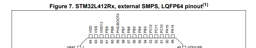

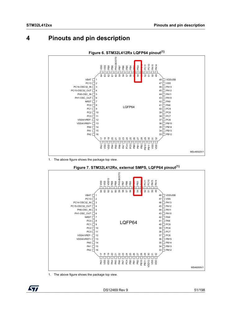

Please refer the code. All other GPIO pins are working fine, except PD2.
I can't share my custom board schematic. it is confidential. PD2 is connected with LED through a resistor. Nothing is connecting with PD2.
We referred the NUCLEO-L412RB schematic. I have attached that also here.

Pin 54 is either PB3 or PD2, depending on which particular model of STM32L412 are you using - the suffix is important.
So, post a photo of the chip you are using.
Also, for testing, stop execution in debugger, and toggle given GPIOx_ODR pin manually directly in the debugger (of course after checking that the respective GPIOx_MODER is set properly for GPIOx Out).
VasuManiVAuthor
Jun 17, 2024 5:58 AM UTC
Yes exactly @waclawek.jan . I found that and i tried to toggle PB3 pin, it is working fine and i can able to see the pulses at 54th pin. So finally our ordered part is wrong.
AScha.3
Jun 17, 2024 6:18 AM UTC
So look at your chip, to see, what you have:
with P or not ? (you should find the P ...)  :)
