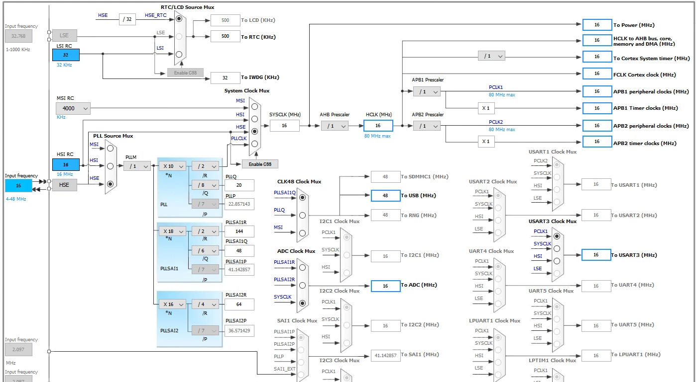

On STM32L476 Discovery and TrueSTUDIO 9.0.1, USB CDC fails on Windows 10, if code is generated by STM32Cube MCU package of STM32L4 version 1.12.0. Back to version 1.11.0, it works fine. Furthermore, at 48 MHz USB clock, if SYSCLK = 48 MHz, the USB code is OK. But if SYSCLK = 16 MHz, the USB code fail. Why ?

    I observe the same problem with 1.12, I was on 1.8.1 and it was working fine, but after update I could not make it work. I will try 1.11 to see if it also solve my problems.
    For the USB, make sure the clock is precise to 48 MHz for the USB part. If this clock is not precise enough the USB will not work. You can give a look at the clock documentation to see if this is supported.
    Jerome Godbout
    September 13, 2018
    Here is my setting with a SysClock of 16 MHz that work for USB if that might help:
