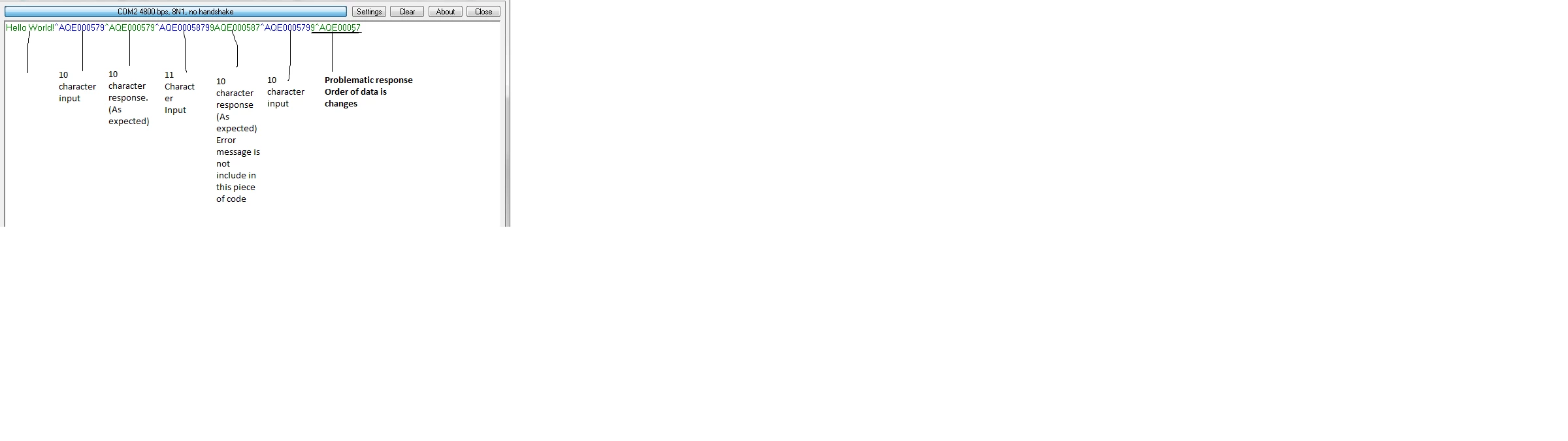

I am using Nucleo-32 board in my project. I am programming USART to receive 10 character data and then transmit this 10 character data back.
Problem that I am observing is that if accidentally 11 character it is suppose to display error message after that every time I enter 10 character string, my response character shift right+1. Can someone

Here is image of what I am sending and receiving

You were right I should not have  "while(HAL_UART_Receive_IT( &UartHandle,&aRx_Buffer[0],10)!=HAL_OK);" As I using interrupt method and not polling method. Thank for that
I made a copy of array and then used that copy for Tx,
But I Still see the same issue when I send more than 10 character
