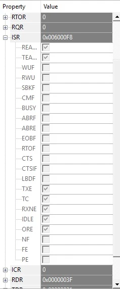

I always receive what I have to receive but together with a non-expected character at the beginning.
In the way I'm working, I send a command via UART and then I have to read something. Every time I send a command, the status of the ISR register is as depicted in the attached picture (it has been catched being stopped at 'HAL_UART_TxCpltCallback' function): always I have Overrun Error after sending a command....

Posted on September 27, 2017 at 12:27
Have checked with a scope, i.e. is this a real received character ?
The callback routines do run in the interrupt context, don't they ?
As said, Cuba/HAL is not for me ...
I suspect you spend too much time in an interrupt routine, be it a differnt interrupt, the send callback, or even the receive callback itself.
If a character is received while another unread character is still in RX, the overrun flag is set, and reception stops - until you explicitly reset the OR flag.
Do as few as possible in the interrupt (including callbacks) itself, rather use flags or other mechanisms to delegate it to your synchronous main code.

The other thing is that if you send dozens of characters the receiver can expect to see a similar number of characters in the same time frame. So you can't just ignore the RX when doing a TX, these thing need to occur in parallel, and if you sit in a call-back blocking execution other interrupts may be ignored.
