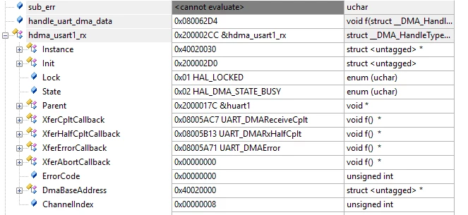

Ihave a similar problem withUART DMA transfer complete/half transfer callback function using CubeMx and HAL.
I use UART with DMA on UART RX. I have enabled DMA transfer complete and half transfer interrupts in usart.c:
/* USART1 DMA Init */
/* USART1_RX Init */
hdma_usart1_rx.Instance = DMA1_Channel3;
hdma_usart1_rx.Init.Direction = DMA_PERIPH_TO_MEMORY;
hdma_usart1_rx.Init.PeriphInc = DMA_PINC_DISABLE;
hdma_usart1_rx.Init.MemInc = DMA_MINC_ENABLE;
hdma_usart1_rx.Init.PeriphDataAlignment = DMA_PDATAALIGN_BYTE;
hdma_usart1_rx.Init.MemDataAlignment = DMA_MDATAALIGN_BYTE;
hdma_usart1_rx.Init.Mode = DMA_CIRCULAR;
hdma_usart1_rx.Init.Priority = DMA_PRIORITY_LOW;
if (HAL_DMA_Init(&hdma_usart1_rx) != HAL_OK)
 _Error_Handler(__FILE__, __LINE__);
__HAL_LINKDMA(uartHandle,hdmarx,hdma_usart1_rx);�?�?�?�?�?�?�?�?�?�?�?�?�?�?�?�?
HAL_DMA_RegisterCallback(&hdma_usart1_rx, HAL_DMA_XFER_HALFCPLT_CB_ID, handle_uart_dma_data);
HAL_DMA_RegisterCallback(&hdma_usart1_rx, HAL_DMA_XFER_CPLT_CB_ID, handle_uart_dma_data);
__HAL_DMA_CLEAR_FLAG(&hdma_usart1_rx, DMA_FLAG_HT3); // DMA CH3
__HAL_DMA_ENABLE_IT(&hdma_usart1_rx, DMA_IT_HT); // enable Half transfer flag
__HAL_DMA_CLEAR_FLAG(&hdma_usart1_rx, DMA_FLAG_TC3); // DMA CH3
__HAL_DMA_ENABLE_IT(&hdma_usart1_rx, DMA_IT_TC); // enable Transfer Complete interrupt�?�?�?�?�?�?�?�?�?�?�?�?�?�?�?�?

void handle_uart_dma_data(DMA_HandleTypeDef *hdma){
 LED_1_ON();
Problem is, this function is never executed.
HAL_DMA_RegisterCallback executeswith HAL_OK status, while debugger shows different pointer, to UART __weak functions. 0690X00000607qDQAQ.png
Why are called this functions instead of my registered callback?
void HAL_UART_TxCpltCallback(UART_HandleTypeDef *huart);
void HAL_UART_TxHalfCpltCallback(UART_HandleTypeDef *huart);
void HAL_UART_RxCpltCallback(UART_HandleTypeDef *huart);
void HAL_UART_RxHalfCpltCallback(UART_HandleTypeDef *huart);
void HAL_UART_ErrorCallback(UART_HandleTypeDef *huart);�?�?�?�?�?

If you did call HAL_UART_Receive_DMA(...), then the HAL library do the following
/* Set the UART DMA transfer complete callback */
huart->hdmarx->XferCpltCallback = UART_DMAReceiveCplt;
/* Set the UART DMA Half transfer complete callback */
huart->hdmarx->XferHalfCpltCallback = UART_DMARxHalfCplt;
/* Set the DMA error callback */
huart->hdmarx->XferErrorCallback = UART_DMAError;
/* Set the DMA abort callback */
huart->hdmarx->XferAbortCallback = NULL;
schperplata
Aug 17, 2017 11:18 AM UTC
Posted on August 17, 2017 at 11:18
yes, I figured it out, but I don't see the point - are there any good  reasons that HAL library re-sets this callback to this predefined callback?
Thank you!
