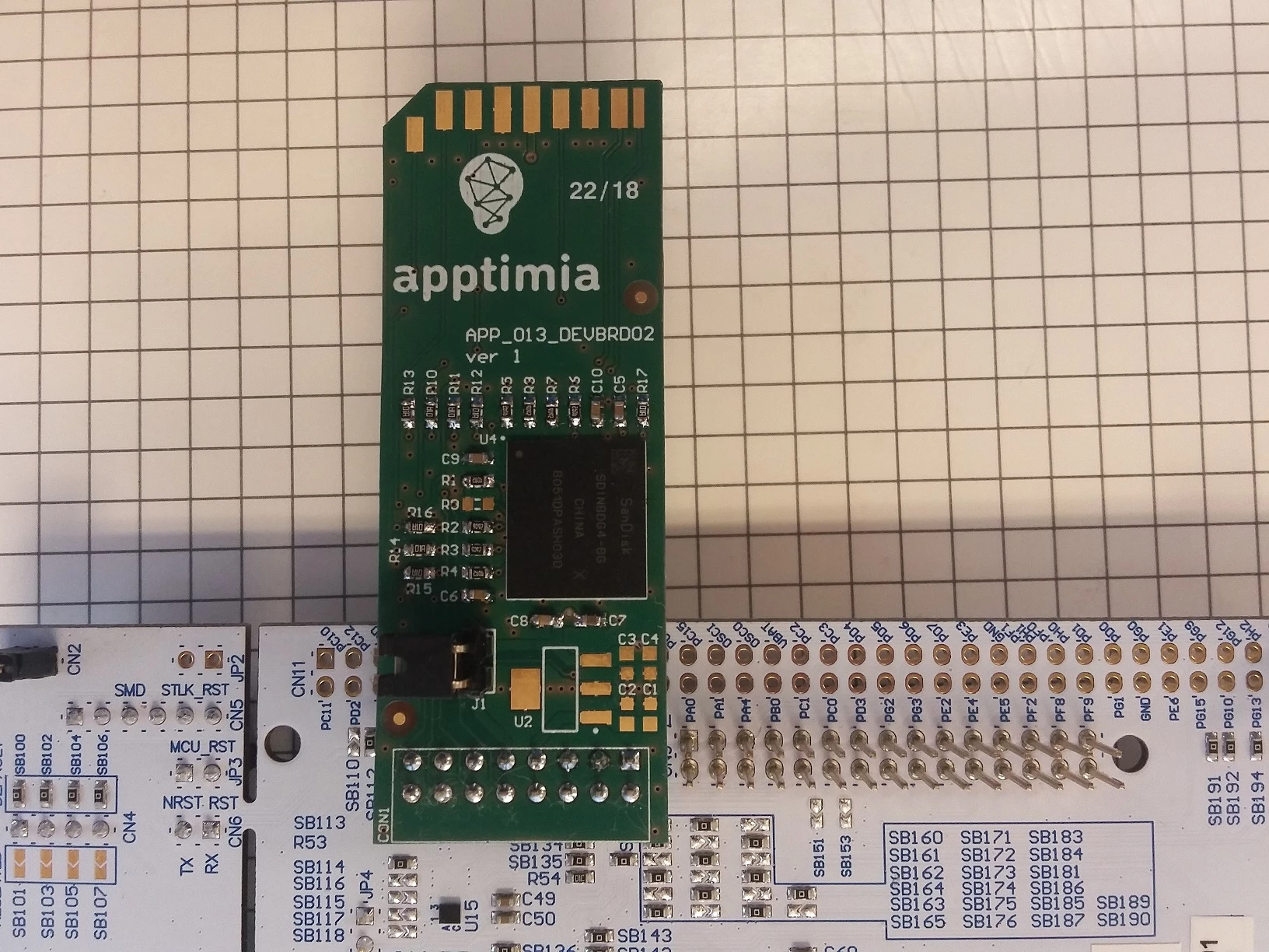

    I have these board from
    Przenioslo.Lukasz

    I'm currently working on the same boards and I was looking forward to make eMMC work with it.
    Do you manage to make it work ?
