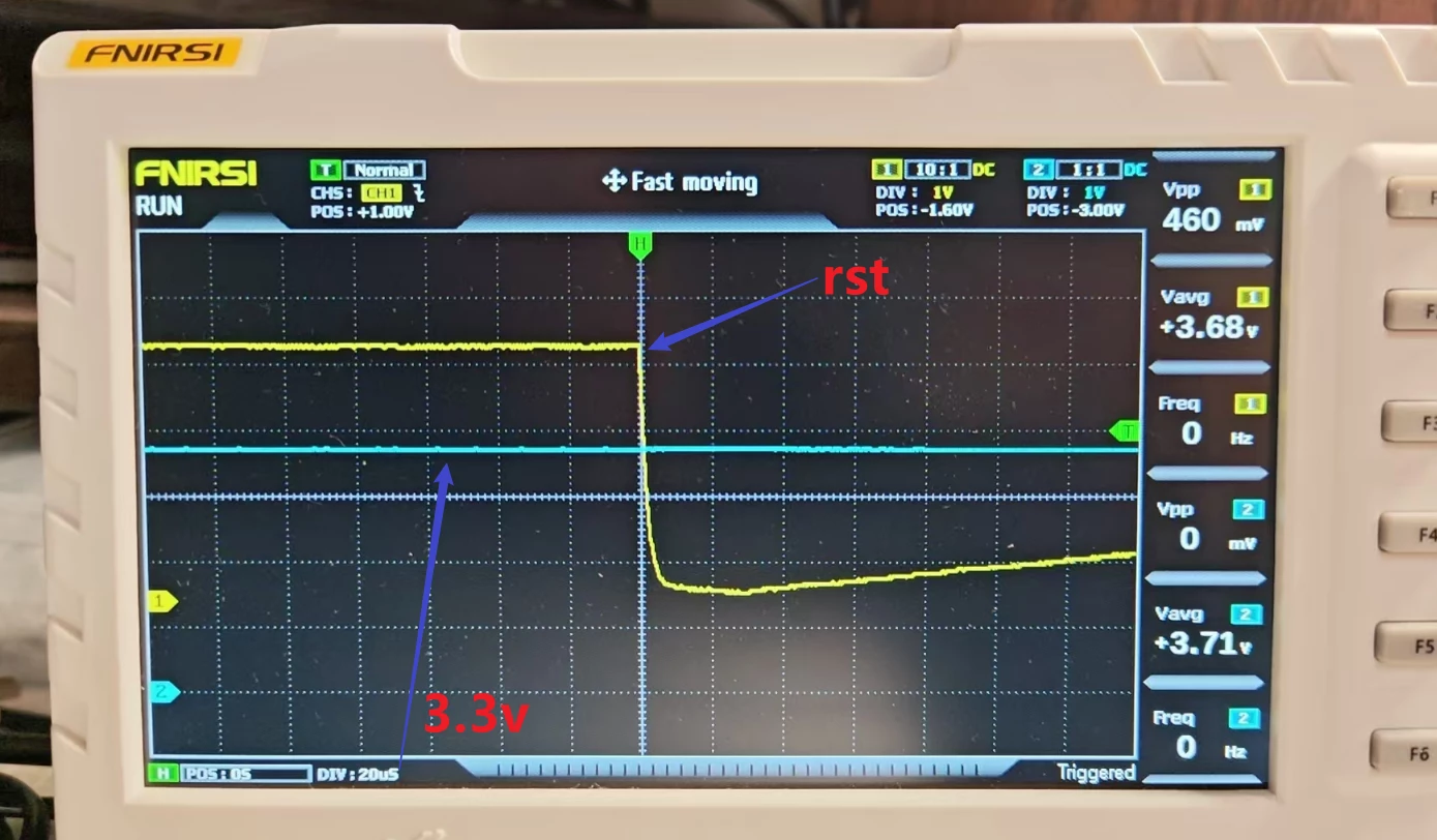

Current debugging progress: When the device restarts, the nRST pin has a low-level time of less than 1ms. The 3.3V power supply pin of the MCU is stable as observed by the oscilloscope. The TP5010_DONE_Pin has a 40ms high-level time during each ten-minute wake-up period (HAL_Delay(1) --> SystemCoreClock configured at 80M, after low-power wake-up, it switches to the default 4M of MSI, reducing by 20 times, plus the HAL_GPIO_WritePin time, which is exactly 40ms), but during the first low-power entry, it has a high-level time of over 20ms (caused by unstable PLL switching to MSI?).

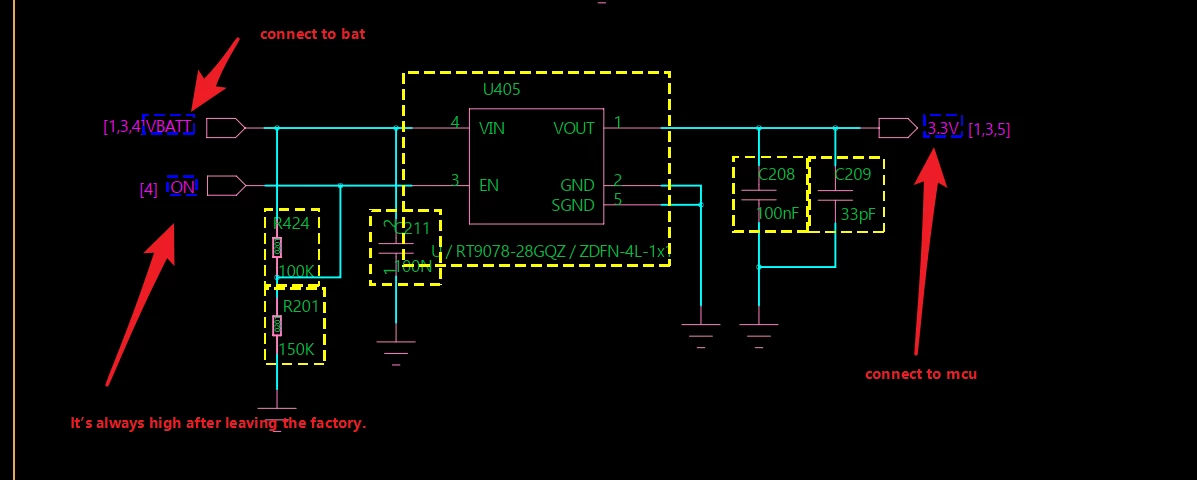

  • Our LDO can only supply a peak current of 300 mA.
  • There is approximately 10 µF of capacitance on the 3.3V power rail.
  • The 4G module’s datasheet specifies a peak current requirement of 1 A. During RF transmission, significant voltage droop occurs—oscilloscope measurements show the 3.3V rail dropping as low as 2.4V.
  • The GPS module draws about 100 mA during operation, causing ~100 mV voltage pulses visible on the oscilloscope.

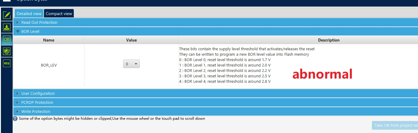

  • The Brown-Out Reset (BOR) threshold is configured at 1.7V.

  1. Power supply IC limitation: Although we haven’t captured the exact 3.3V waveform at the moment of reset, we have observed dips down to 2.4V. It’s reasonable to assume that under real-world outdoor conditions—especially with poor cellular signal requiring higher 4G transmit power—the voltage could drop even further. (See image showing a 2.8V dip: https://community.st.com/t5/stm32-mcus-products/stm32l4-stop2-system-abnormal-restart/m-p/875903/highlight/true#M292050.)
  2. Power cable issue: The current wiring uses approximately AWG16 gauge, which may be too thin, contributing to additional voltage drop.

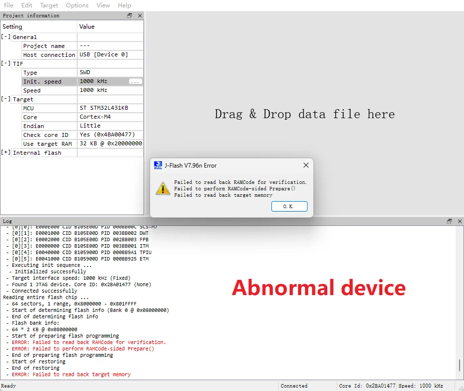

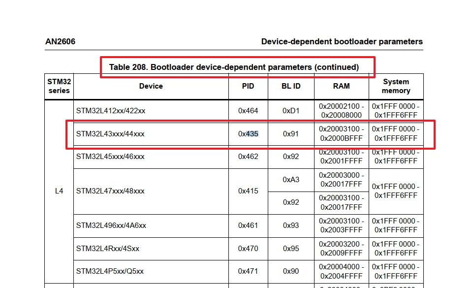

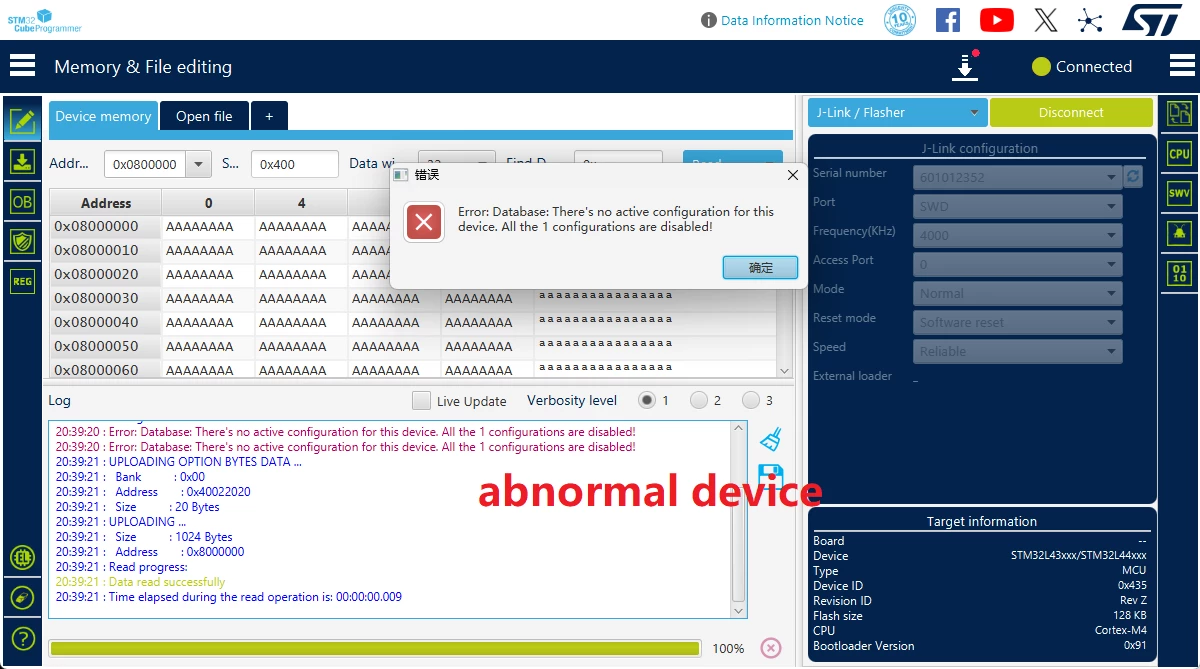

  3. Investigate and resolve the STM32CubeProgrammer read failure—either recover the root cause or implement mitigation strategies (e.g., robust Flash write protocols, power monitoring before writes).

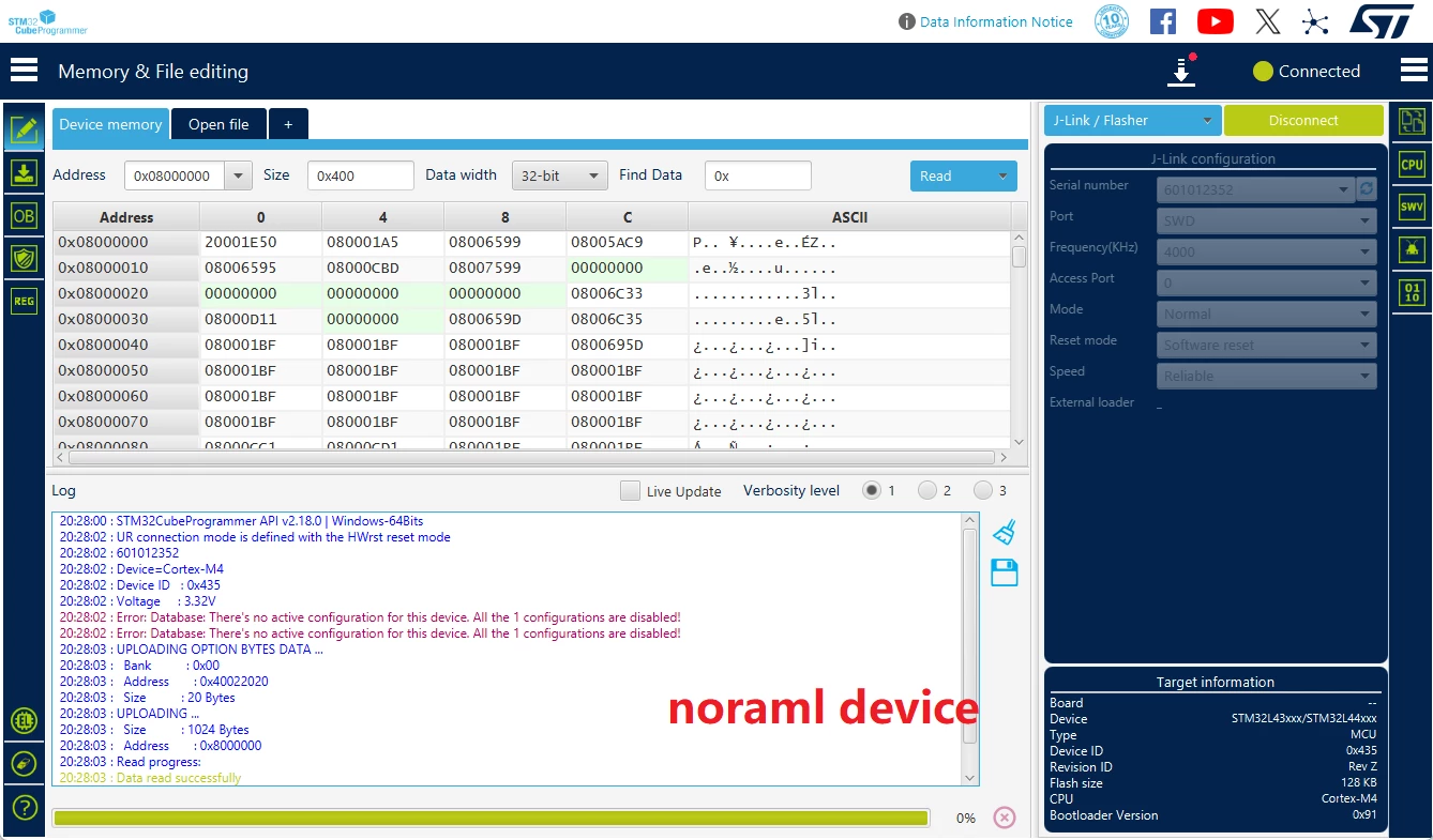

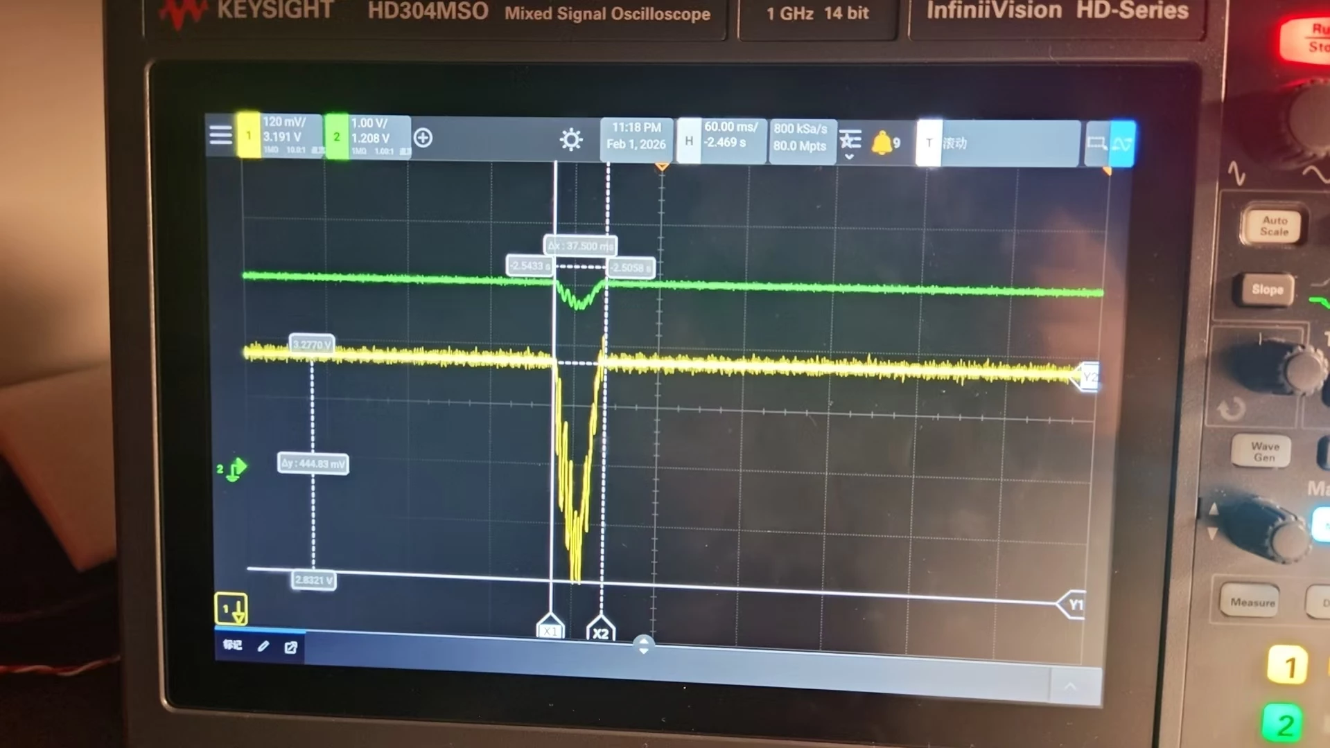

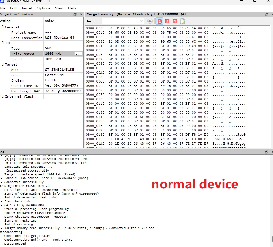

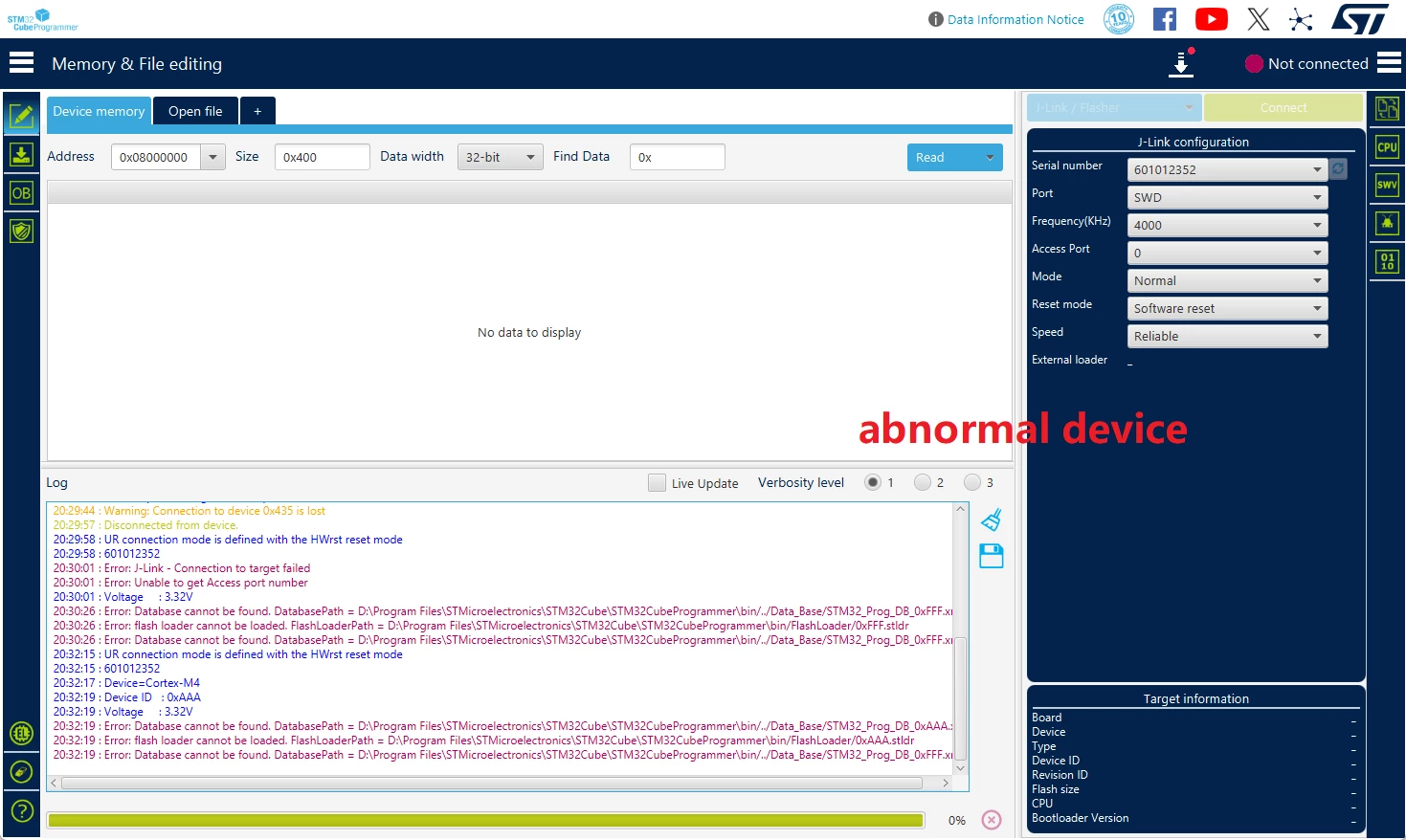

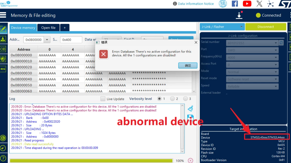

daniaodayBest answer
February 2, 2026
We re-examined the current issue and found that the power supply problem is indeed more significant. However, the original oscilloscope truly couldn't detect any anomalies. Therefore, we borrowed a higher-end oscilloscope, and the test results were excellent! Although we didn't capture the voltage level during the reset event, we did successfully capture waveform dips at certain moments!
The voltage dropped to around 2.8V. Although it didn’t reach the BOR  threshold, this is very likely the root cause of the issue!
Therefore, we've decided to redesign the power supply and fabricate a new PCB. We hope the next revision will resolve the issue.
P.S.: But why can't we read the flash memory on the failed devices—has it been locked or physically damaged?

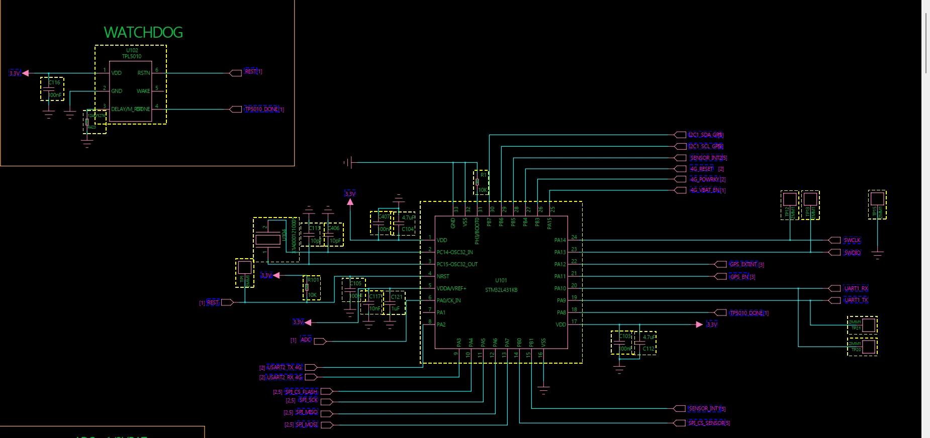

This is the latest version.
this is power .

> A low level on the NRST pin (external reset) → No external reset signal was captured by the oscilloscope.
> However, actual measurements show that the low-level duration on the nRST pin is less than 1 ms.
I'm having trouble reconciling these two statements. You measured the NRST pin was low less than 1 ms (and presumably more than 0s?) but "no external reset signal" was captured? Isn't that the same thing?
If you have a scope capture of NRST when the reset happens:
Create a new project where IWDG is enabled and let it cause a chip reset. That will trigger the same internal pulse generator on NRST. Capture NRST during this event and compare the two. If they're the same, likely it was an internal reset, not external.
daniaodayAuthor
January 28, 2026
—> This specifically refers to the absence of the TPL5010’s 320 ms wide reset pulse.
I didn’t test using the IWDG; instead, I directly called HAL_NVIC_SystemReset(), and the observed behavior was identical.
The ~1 ms pulse width might be due to the RC time constant: τ = R × C = 10 kΩ × 100 nF (marked as "104") → τ ≈ 1 ms?
January 28, 2026
Ahh, okay, so likely an internal reset then.
Floating SWD pins will not cause a reset, nor will they affect system stability.
I'm afraid all the potential reset causes are what you listed above. Given your scenario, I think BOR reset is the most likely, though of course this will not happen if power is sufficient.

> The oscilloscope captured 3.3V on one channel and nRST on the other, with the nRST channel set to trigger mode. It was found that when the nRST signal had a falling edge, there was no fluctuation on the 3.3V line.
It would always be good to see actual scope plots with this information rather than just text. Sometimes things are left out or misinterpreted.

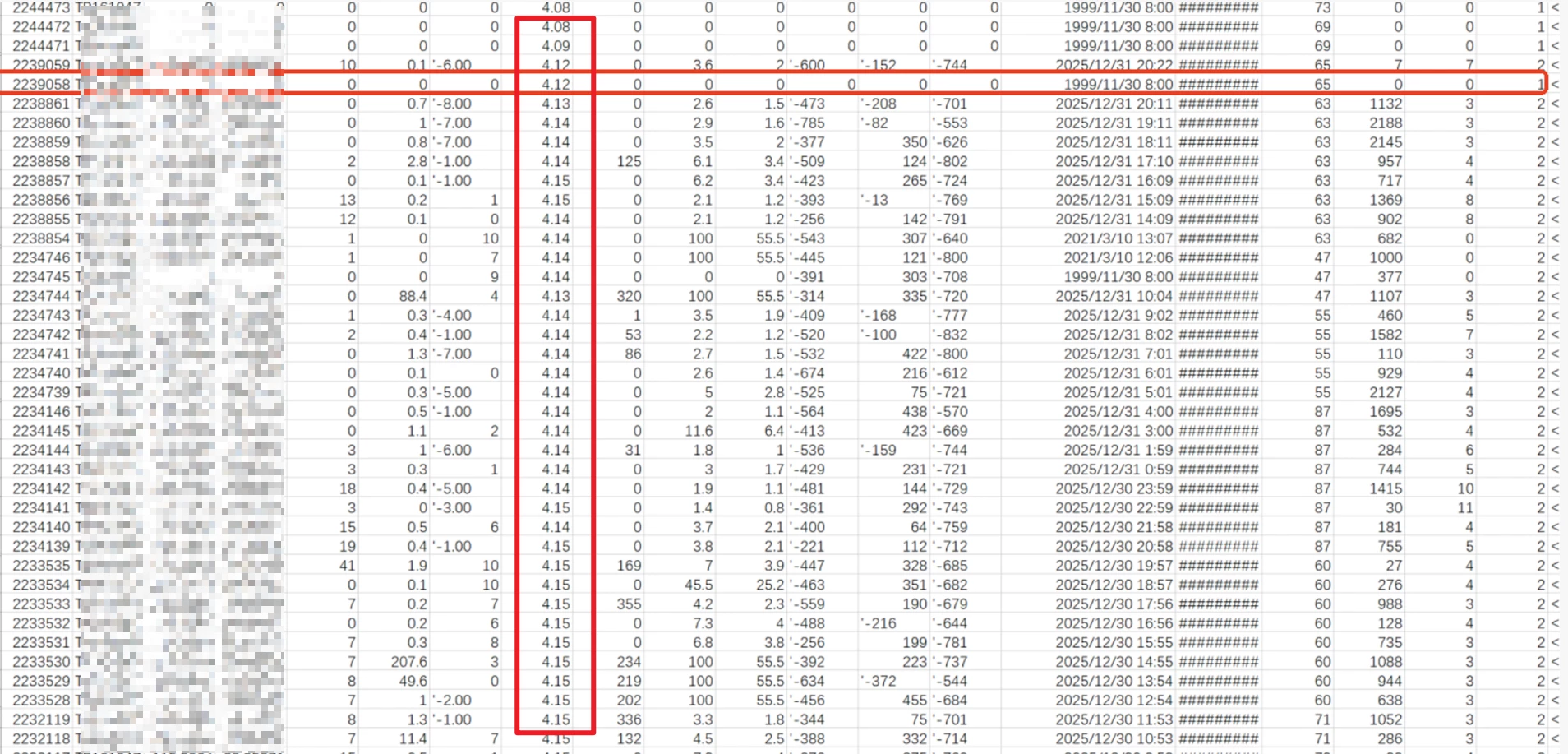

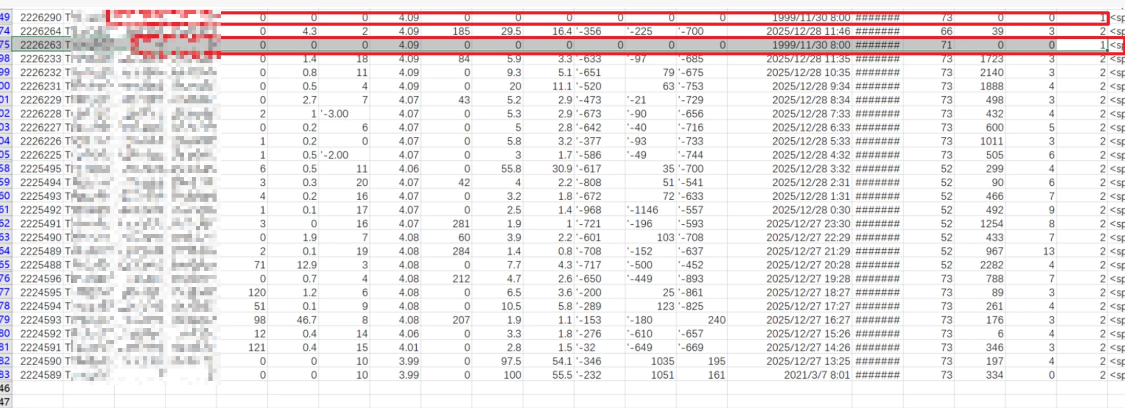

Failed device issue:
We currently have two pilot customers, each with approximately 20 devices.

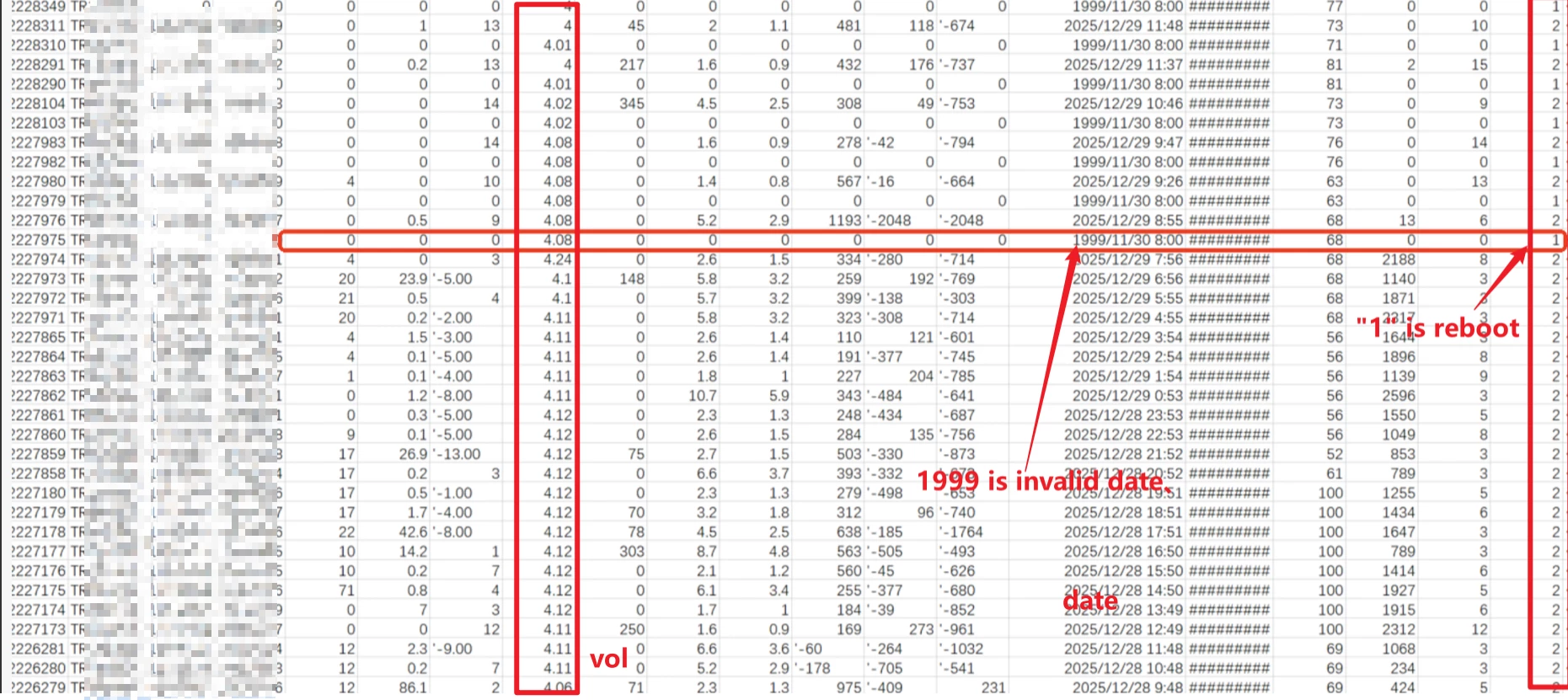

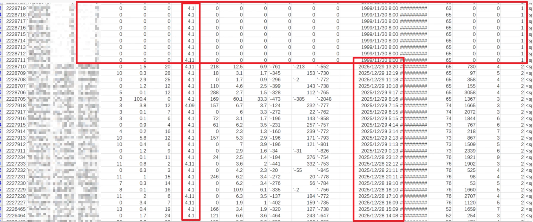

  • Scenario 1: The first customer has already deployed the devices on birds. Within three days, about ten devices exhibited anomalies one after another, followed by occasional additional failures in the subsequent days. The failures occurred too rapidly to identify any clear pattern.
  • Scenario 2: According to feedback, the second customer has not yet deployed the devices on birds (they may still be in storage). On a certain day between 4:55 and 7:26, nine devices rebooted. Afterward, they began rebooting every few hours. After some time, the reboots became irregular again.
  • Scenario 3: We conducted our own test with devices placed on a balcony, and two units showed anomalies, named test1 and test2:
    • test1: Tested by colleague J. Confirmed as an internal reset with stable 3.3 V power. A new firmware version with added RCC status logging was reflashed, and the issue did not reoccur within three days—still under monitoring.
    • test2: Tested by colleague K. Also confirmed as an internal reset with stable 3.3 V power. I will now read the MCU’s internal status via J-Link.
All lab-test-related information I’ve shared with you so far is based on testing results from test1 and test2.
In all three scenarios, when anomalies occurred, our platform reported battery voltages between 4.0 V and 4.2 V.

The “1-hour sleep” is implemented via the device_enter_lowpower function, which internally splits the hour into six 10-minute intervals. The relevant code has already been shared previously.
At the time of reboot, logs from both test1 and test2 indicate that the reset occurred inside the device_enter_lowpower function. Similarly, for Scenario 1 and Scenario 2, reboots observed on the platform also follow this pattern—i.e., the interval between reboots and logged events is always a multiple of 10 minutes.
scope plots -->
MM..1

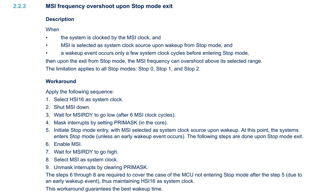

OK then forget to Vdd issue. Trouble is sw. Check PLL recovery waiting is ok in your sw.
Good practice use only MSI without PLL.
Check if some code on fail dont have sw reset call in code etc. For example stack fail...
daniaodayAuthor
January 30, 2026
PLL? This is an unexpected possibility: the PLL derived from HSI, and the repeated switching between PLL and MSI when entering and exiting Stop mode—could this cause a reset?
I only saw in the reference manual that MSI may exhibit overshoot during clock switching, and that it needs to stabilize before being used. In practice, however, I started using it without waiting for it to stabilize.

Everyone, latest update:
  • When using J-Link with STM32CubeProgrammer or J-Flash to read a normal device, communication works fine and Flash can be read successfully.
  • However, when attempting to read a faulty device with the same setup, various errors occur.
Additionally, STM32CubeProgrammer occasionally crashes when connecting to the faulty device.
daniaodayAuthor
January 30, 2026
Regarding the issue where STM32CubeProgrammer cannot read the Flash, I came across a forum post mentioning that the problem is often due to the chip not being correctly selected. However, in my case, the chip has already been properly recognized.
https://community.st.com/t5/stm32cubeprogrammer-mcus/missing-database-files/td-p/81261
SWD communication should be fine.
And the device has already been correctly identified.
daniaodayAuthorBest answer

I don't think you've mentioned it but, presumably, your system has some sort of radio link to upload its data?
It is typical of radios to have large current spikes when they transmit - so I guess that's what's happening here?
These things can, indeed, be hard to spot - the pulses can be narrow and infrequent.
Well, the one you captured didn't.
You need to check what happens in a worst-case scenario - probably when the battery is low, and the solar cell isn't charging.
Again, does your system log the battery state-of-charge?
BTW: Please use your scope's screen capture facility - it will be much better that photos of the screen!
daniaodayAuthor
February 2, 2026
--->  Yes, there is a 4G module.
---> Yes
---> Yes, but at that time the battery voltage was still quite high. 4.0~4.2V .
These are the monitoring logs from several devices on the platform.

  1. Redesign the power circuit: Replace the current LDO with one capable of handling higher peak currents, then conduct further testing.
So is the same LDO currently powering both microcontroller and 4G module?
Might be better to separate them?
Some cellular modules car run direct off a lithium battery...
Also add some capacitance to keep the microcontroller supply up, separate from the 4G module.
daniaodayAuthor
February 3, 2026
Yes, the power supply for the 4G module and the MCU should be separated—most likely, the 4G module will use a dedicated LDO or MOSFET for power delivery.
