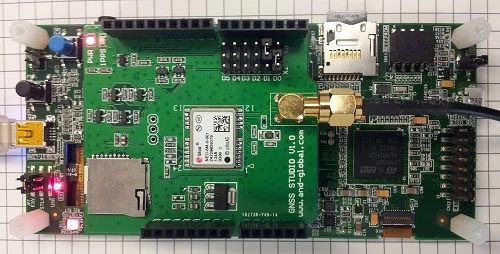

Hi, I just wanted to connect a STM32 to a GPS using a SPI with DMA. Here is my setting :
la : LOGICPORT LA1034
board : NUCLEO-L476RG
mcu : STM32L476RGT6
gps : EVA-7M
cube : 4.13.0
lib : HAL 1.3.0
clock : 80 MHz
spi : SPI3, master, full duplex, 2 wires, prescaler 256 (312 kHz), no NSS
dma : DMA2_Rq3_Ch1 as Rx, DMA2_Rq3_Ch2 as Tx, BYTE

As a matter of fact, I used STM32cubeMX to create my initialization code and I'm using the brand new HAL library to perform some basic data transfer.
I don't see what's so complicated to perform, I could provide you with my initialization and callback routines.

OK, looks like after HAL_Init(); and MX_SPI3_Init(); I have to perform a first HAL_SPI_TransmitReceive(&hspi3 of 4 bytes set to 0xFF in order to initialize the FIFOs and the TxRx register, setting MOSI and MISO high.
After that everything now looks working well. Polling or DMA. Obviously just an initialization issue that MX should have added automatically to completely set up the SPI.
