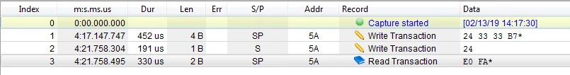

    thomasFromBrittany
    Visitor II
    February 13, 2019
    Hey Franz,
    Where do you find this snippet code ?
    For me, this does't work..
    When I send a new emissivity value (ex : Ke= 0x3333 => emissivity = 0.20), I read the EEPROM after (Ke = 0xFAE0 => emissivity = 0.98), this is not what I set !
    uint8_t i2cdata[4];
    i2cdata[0] = 0x24; //EEPROM-address
    i2cdata[1] = 0x33; //Delete-Byte, low
    i2cdata[2] = 0x33; //Delete-Byte, high
    i2cdata[3] = 0xB7; //PEC -> CRC8-checksum for 243333, calculation: http://www.sunshine2k.de/coding/javascript/crc/crc_js.html
    HAL_I2C_Master_Transmit(&hi2c1, 0x5A<<1, i2cdata, 4, 0xFFFF);
    If you have any idea about my problem, it's with pleasure !!

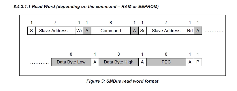

    dinamitemic
    Visitor II
    May 26, 2019
    Hi Thomas, Can I ask you how did you managed to read back from EEPROM.
    I've tried the same as reading from RAM but it didn't work. It seems like is performing a write instead of a read and after I've to reprogram some regs to make it works again.
    ty.locke
    May 28, 2019
    Be sure to change the op code when reading from EEPROM and you should be able to read the register values without issue. If you're trying to change the values be sure to erase the EEPROM address first before setting the new values
