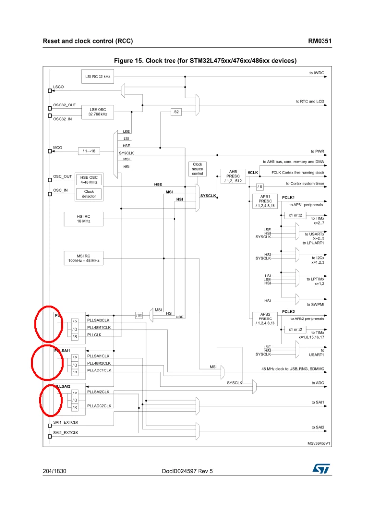

There seems to be something I don't quite get.
In the reference manual it says 'The PLLs input frequency must be between 4 and 16 MHz.' and 'The selected clock source is divided by a programmable factor PLLM from 1 to 8 to provide a clock frequency in the requested input range'.
Also all other PLL parameters are described to be dividers.
How do you get 80 MHz?

    Ah, there's 'N' that's the multiplier. It was just not shown in the clock trees...

    You'll achieve a 80MHz configuration with the following settings:
    - HSE 8MHz PLLM=1, N=20, R=2
    - or MSI 4MHz, PLLM=1, N=40, R=2

    Hi Bruno,
    the block schematics in the RMs are perfectly understandable, except that those in the L4 RM miss the PLL ''multiplication'' element itself.
    That was what turbo was talking about initially (and I misunderstood his question).
    Please, re-instate the ''xN'' (even if  the multiplication sign is factully incorrect there), as is in other families' RM (e.g. in RM0090):

    You are right!
    Thank you for bringing this issue to our attention.It is noted and will be fixed in coming release of the documents
