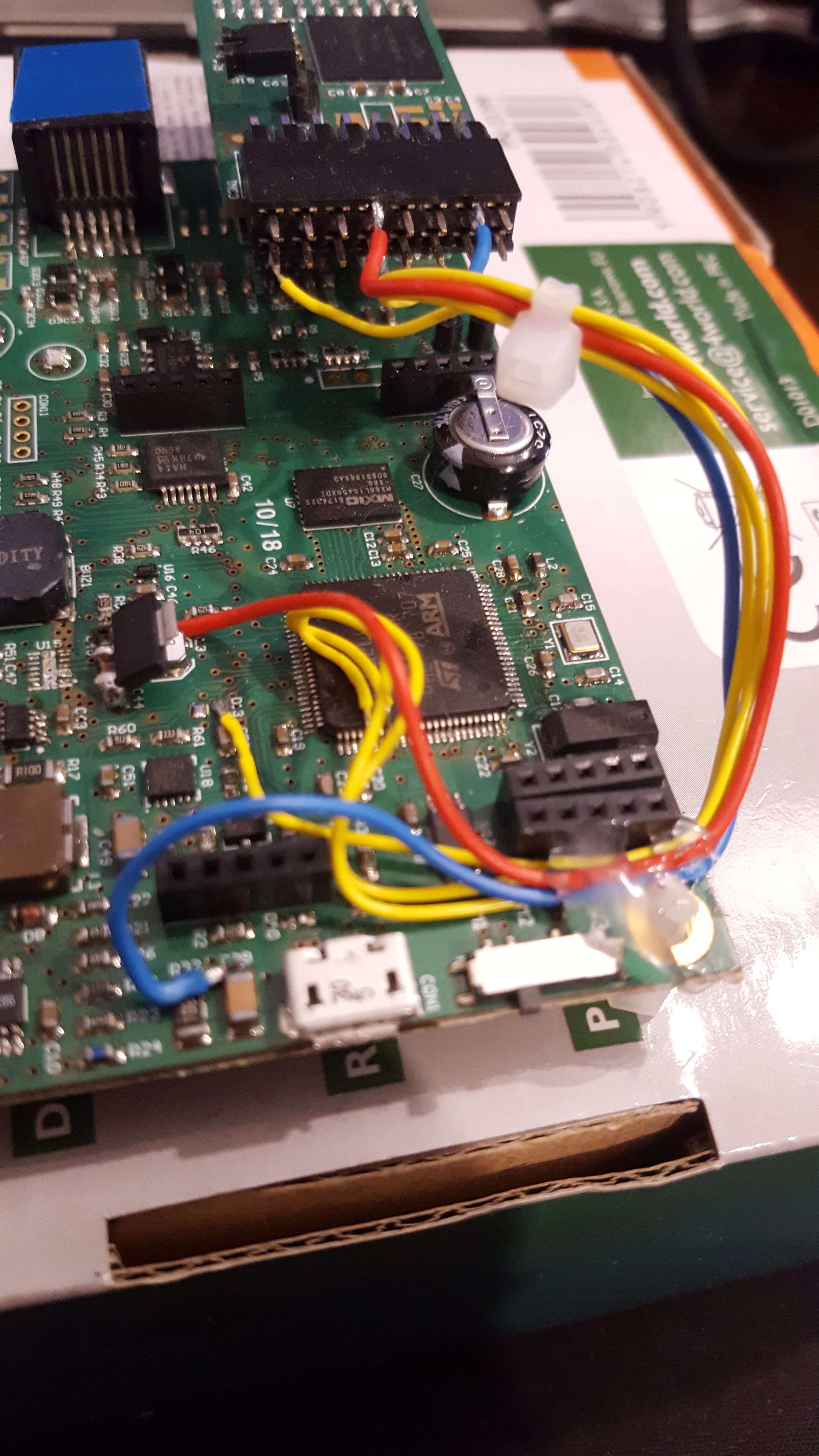

Hi, pretty sure this is a newbie type question. I'm using the SDMMC interface on an STM32L476. Right now it is just wired to a Nucleo board so I can do some benchmarking before committing it to a layout. I'm using STM32CubeMX and following the example in section 3.3 of UM1721 (Fatfs on CubeMX). After learning the hard way pullup resistors *are* necessary (some other posts said not), I am able to talk to a card, but only if I use polled mode ("Use DMA Template" set to disable in STM32CubeMX Fatfs settings). When enabled, the code hangs in the sd_diskio_dma.c SD_Read() routine right after the BSP_SD_ReadBlocks_DMA() call.
The note for "Use DMA Template" says to ensure that DMAs are properly configured but no more info. In the SDMMC configuration I've tried tried selecting SDMMC1 and then both SDMMC1_TX_SDMMC1_RX. I always get the stall. I am sure there i something basic I'm missing, but been at it for a couple days now and deciding to ask. Since this seems a very basic "follow the app note", rationalizing it might be useful for others too.

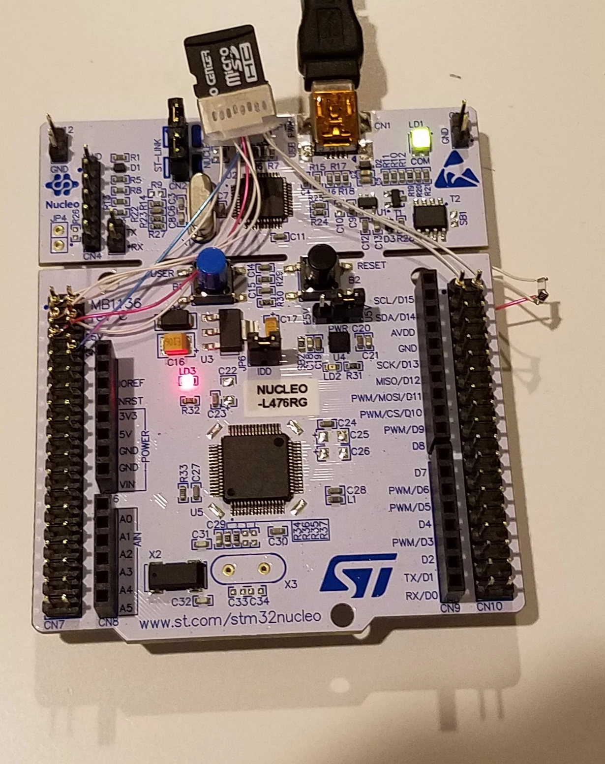

    The board I got a while back was the Adafruit one that had an SPI-wired SD card and LCD to warm me up for another project for which SPI-based SD card comms was fine. They are handy. For this test I already had reader sockets left over from that project so opted to just sky-wire it (see picture in post to Clive below). I didn't have pullups on any lines after reading some posts saying they wern't necessary. Seeing scope traces made me wonder. It took a couple days to get to the right combination of pullups plus non-DMA to finally see things working. I'm getting there, just taking a bit longer than I had expected.

    That is some serious speed. My sky wires are even shorter (see picture) and I was seeing some not-so-great signals and errors at 24MHz. I'm not terribly worried just yet, I'm sure a good layout will help considerably. That is good to know, though.
    I've been wondering if my DMA-not-working issue may be something that STMCube32MX didn't have quite right specifically with the STM32F476, but see that you are using the exact same chip/board? Can I ask what revision CubeMX software/drivers you are using and FatFS/SDMMC settings you used? I'm sure there is something simple I am overlooking as a new CubeMX user. I'm mostly a hardware guy and only recently moved up from the bare bones SdtPeriph class libraries.

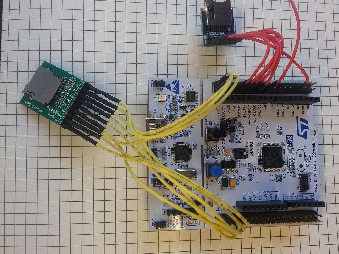

    One can certainly do a much better job with a PCB design. The trace lengths on some of ST's EVAL boards are longer than I'd like. @Community member​ is working on some socket dongles for the NUCLEO-144 series that plug in compactly on the back-side. @Community member​ made a eMMC dongle when we were working on that.
    Keeping trace lengths short and equal is desirable. For short runs, 27 or 33R series resistors should be used to stop ringing (backing off slew rate also helps), and 33 or 47K pull-up at the socket for the data and command lines.
    In retrospect I should have used the shorter schmartboard wires for the SDMMC rather than the SPI, but it photographs well, works well, and can be handed around a conference table without getting broken, or in a car ride to/from home in a box. I've used wire-wrap a lot in the past, and that is more reliable than the dupont wires people use for bread boarding.

    Just to let folk know: I'm still working on the root issue. I have confirmed that the stall is because there is no DMA happening at all, not because the DMA finished and the end isn't somehow being flagged. I also need a DMA-driven DAC for this project. Since I am pretty sure the "something basic" I'm missing has to do with DMAs, I'm going to fiddle withe the simpler peripheral (the DAC over SDMMC) to see what is wrong. Hopefully any lesson learned from the DAC DMA setup wil be applicable to the SDMMC DMA setup.
