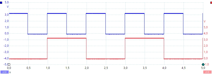

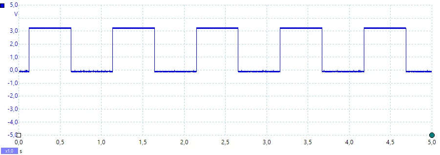

Is only only the TimeStamp function configured, then it works also as expected. Blue is a clock with e.g. 1 Hz and the red signal is a gpio which will be toggled by the TimeStamp callback function. It works also as expected.

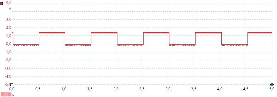

If I try both together, the calib out will work, but I won't get any TimeStamp events anymore. The signal at the TS input has only a voltage of 1.4 volts. Only the COE and COSEL bits are changed by the pin calib out. What happens here?

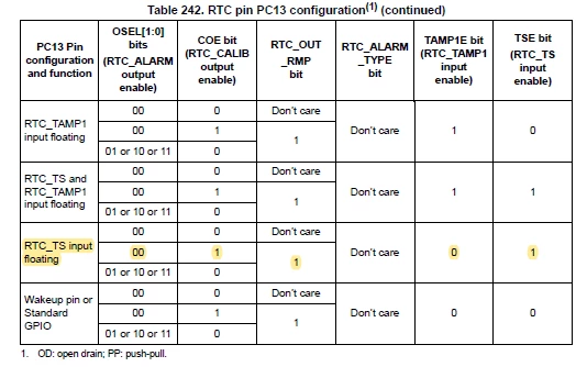

Can someone explain what changes to PC13 when the COE bit is set to 1?

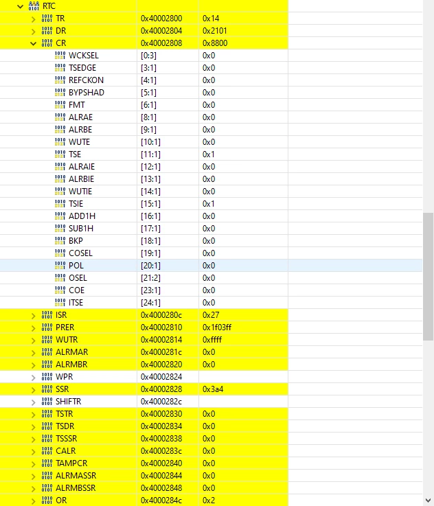

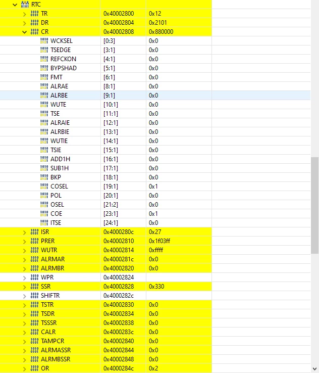

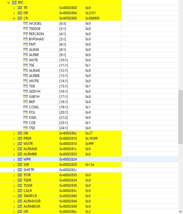

OK so if you read out the RTC registers, what exactly do you see in those bits, in all three cases?
PK.2
PK.2Author
June 27, 2020
I guess i see what i expect.
Case 1
waclawek.jan
June 27, 2020
Indeed looks logical.
Pity you did not show us the registers when the external 1Hz signal is connected to PC13/RTC_TS - according to your description, at least in case 2 that should have effect on the registers.
I wonder, whether in case 3 that does or does not have similar effect on the registers.
[case 3]
I don't understand. Isn't that your external 1Hz signal? How is it different from case 2?
PK.2
PK.2Author
June 29, 2020
The external signal is the same in case 2 and case 3.
The only difference between case 2 and case 3 is that in case 2 only the RTC_TS is configured (see TSE and TSIE bit).
In case 3 RTC_Calib_Out is also active (see COE and COSEL bit).
In case 3 the voltage is 1.4 V instead of 3.3 V. That's the question. This happens when PB2 is active, but why does it change PC13.

This sounds like PC13 is turned to output, in spite of TSE bit being set.
Sounds much like a hardware bug.

I wouldn't hold my breath and would work out of the premise that the given combination is simply unavailable. Maybe combination of retaining the tamper function and toggling a pin in RTC interrupt might provide something close to what you intended?

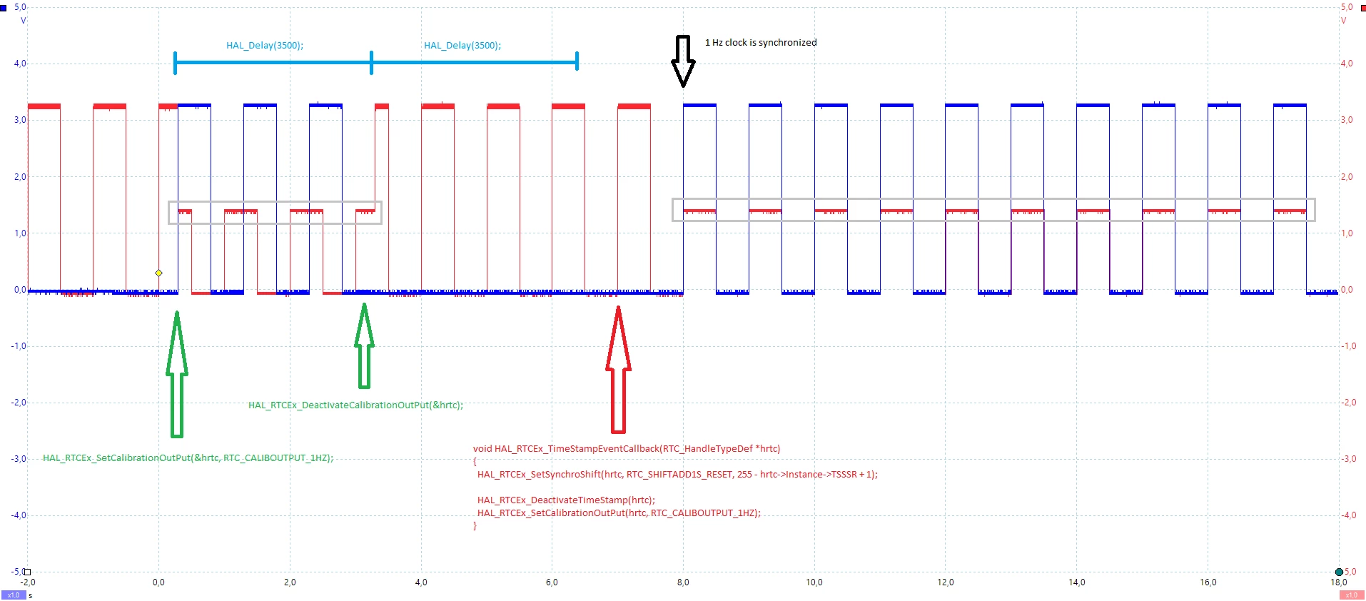

I wanted to use the RTC_TS for time synchronization because a rising edge triggers an interrupt and at the same time the current time is transferred to the TS register.
With the timestamp I would know how many sub-seconds the RTC of the L4 deviates and could correct this with the shift function.
void HAL_RTCEx_TimeStampEventCallback(RTC_HandleTypeDef *hrtc)
 HAL_RTCEx_SetSynchroShift(hrtc, RTC_SHIFTADD1S_RESET, 255 - hrtc->Instance->TSSSR + 1);
 HAL_RTCEx_DeactivateTimeStamp(hrtc);
 HAL_RTCEx_SetCalibrationOutPut(hrtc, RTC_CALIBOUTPUT_1HZ);
Example
 HAL_RTCEx_SetCalibrationOutPut(&hrtc, RTC_CALIBOUTPUT_1HZ);
 HAL_Delay(3500);
 HAL_RTCEx_DeactivateCalibrationOutPut(&hrtc);
 HAL_Delay(3500);
 HAL_RTCEx_SetTimeStamp_IT(&hrtc, RTC_TIMESTAMPEDGE_RISING, RTC_TIMESTAMPPIN_DEFAULT);
The blue signal is the calibration output and the red signal is the 1 Hz clock with the RTC is to be synchronized.
So that I get an RTC_TS interrupt, I always have to switch off the caliboutput. If the COE bit is set, as you said, the RTC_TS may be configured as an output.

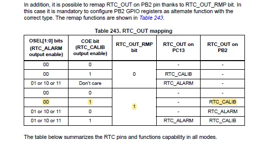

I have assigned PB2 with RTC_Caliboutput and PC13 as exti input with rising edge.
PC13 cannot be used. The input signal is always 1.4 V.
waclawek.jan
July 3, 2020
And what's in the RTC registers now?
