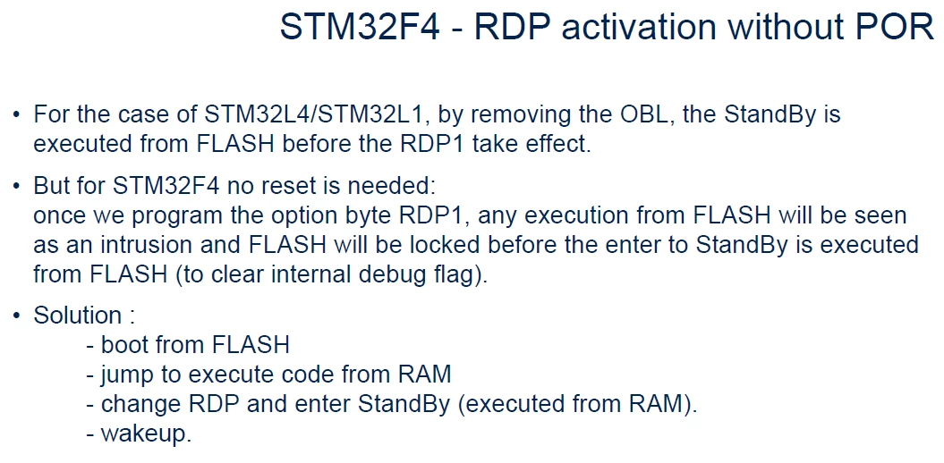

Hi @mwp ,
In the materials provided with this video, you find explanation and tips to change RDP level without POR. Video is about STM32F4, but in the materials, you will find explanation for L4.
To make it short: To be able to achieve a RDP level increase ( level 1 or 2 ) without POR, you need to do a transition to StandBy state and then wakeup with RTC.

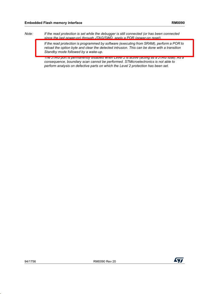

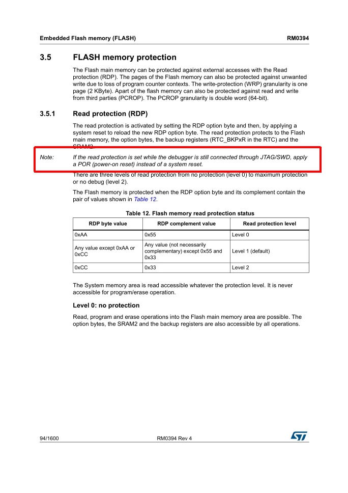

Hi @Amel NASRI ,
while the workaround using Standby/wakeup is in the 'F4 RM,
it is not mentioned in the 'L4 RM (see my previous post).
So, are you sure it *is* pertinent to 'L4?
And if yes, shouldn't it be present in the 'L4 RM?
Also, while in other instances the OBL_RELOAD operation appears to be equivalent of power-on reset, in this particular case it doesn't appear to be the case. Could this be please documented, too? Perhaps a table of effects of various types of resets on various features for each STM family could be illustrative, perhaps as an appnote or @KB-IDEA .

Hi @waclawek.jan ,
Thanks for your feedback.
What you ask for is explained in the document dedicated for STM32F4 (in the previously shared materials):
Isn't the case?
I'll nominate this discussion to make the subject of a new article.
