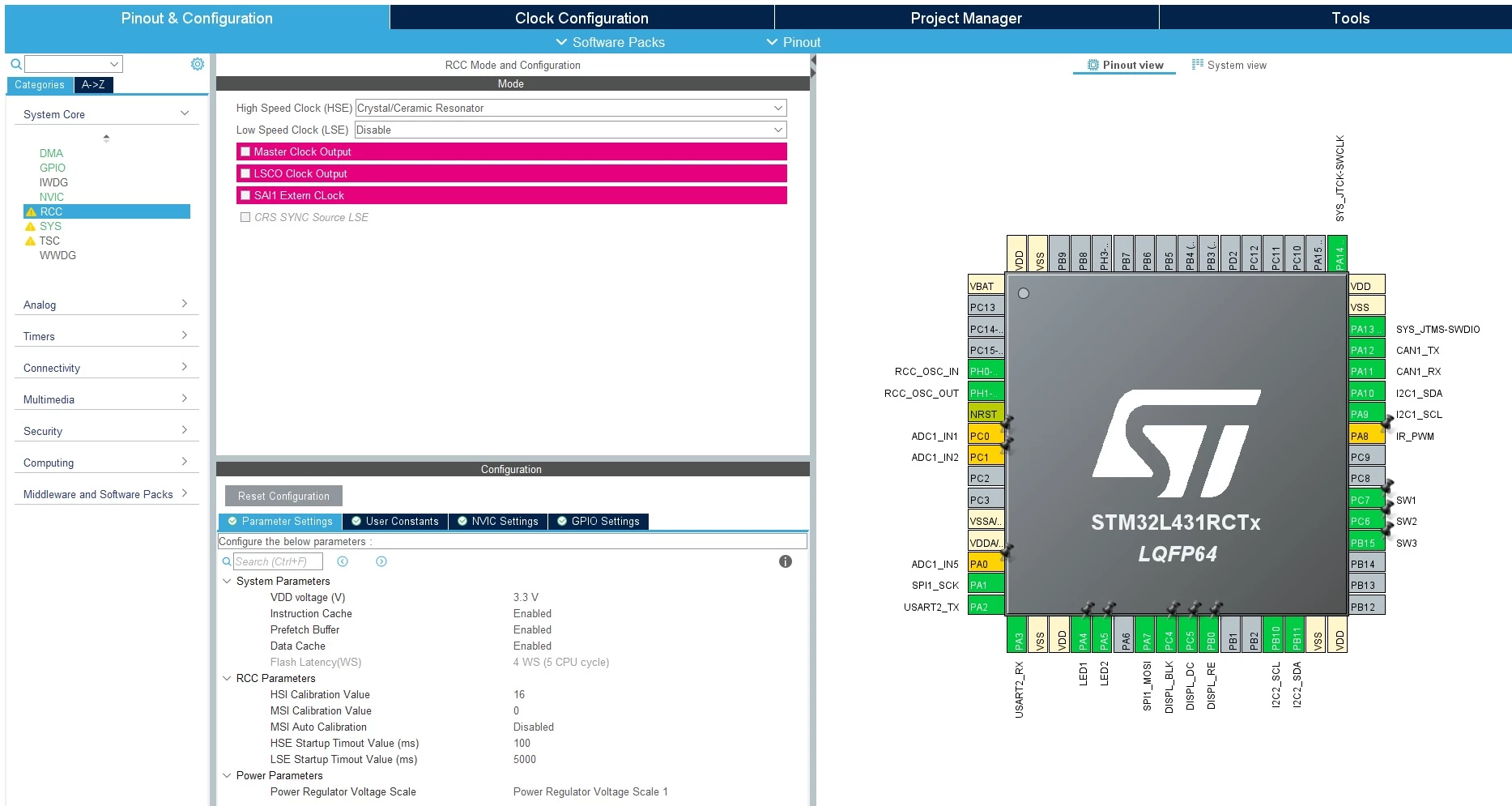

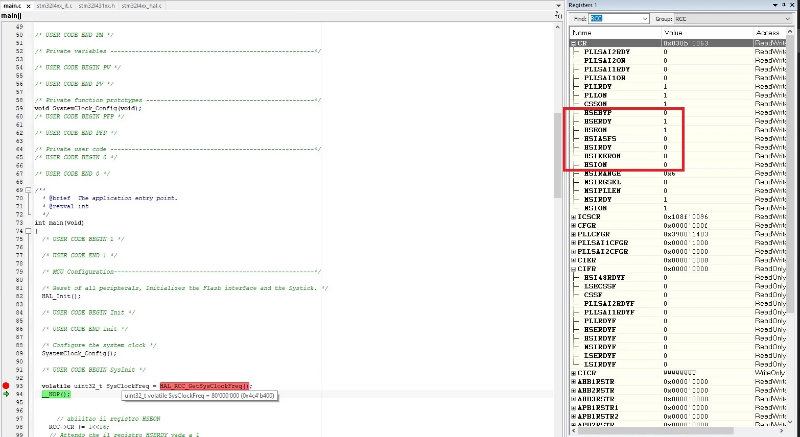

I developed my first board with a STM32L431RCT6 (80Mhz) but sometimes I have problems with an external 8MHz crystal (HSE switches to HSI).

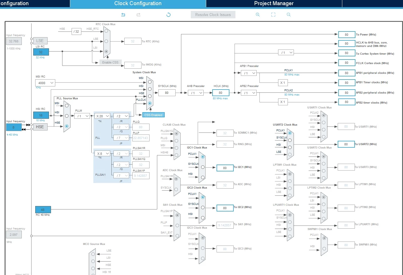

I configurated the peripherals and the clock with STM32CubeMx.
This is a clock configurator page (I enabled CSS):
This is a RCC page:
The 8Mhz crystal is connected on the pins PH0 and PH1 with two capacitors of 20pF.

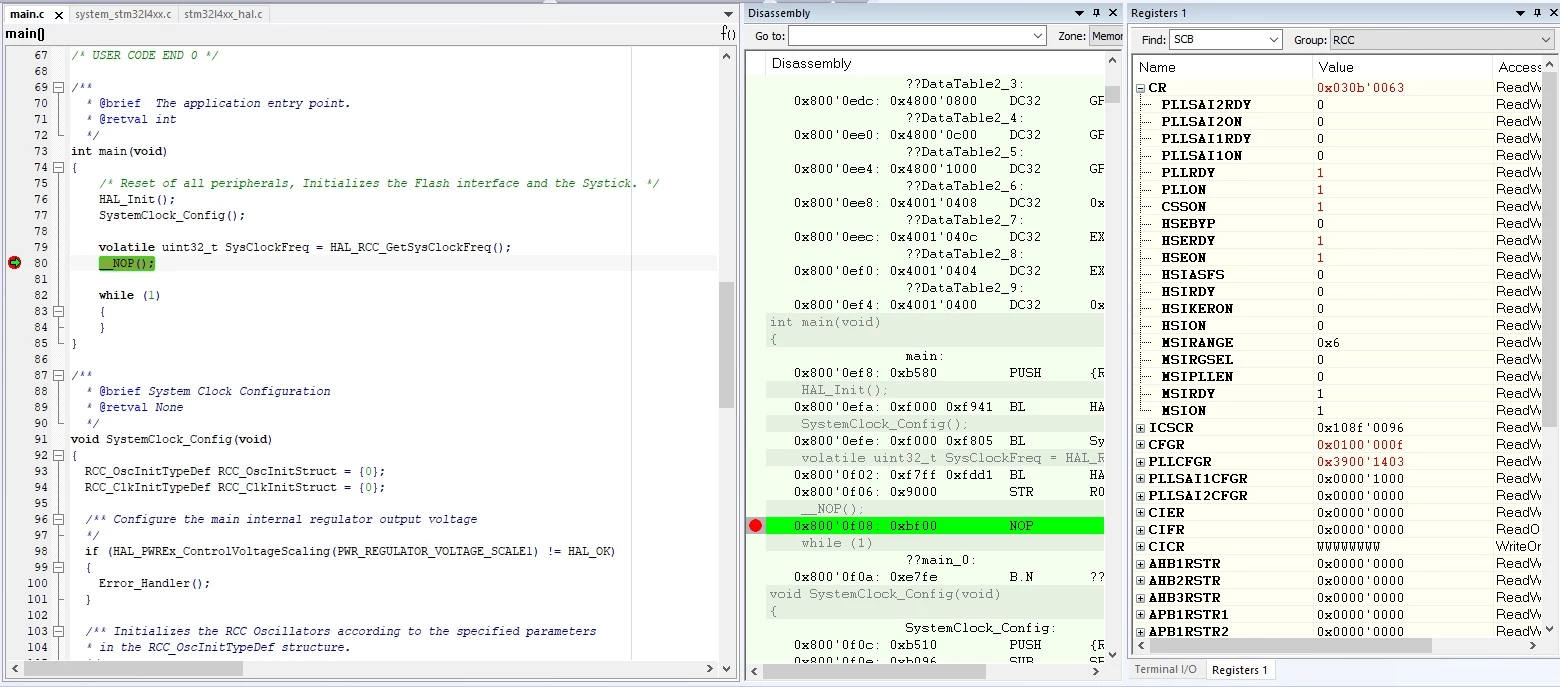

When I stop the firmware after the System Clock configuration the HSEON and HSERDY registers are set to a corrent value (set to one).
Then a few lines of the code after (at the beginning of the while loop) the board switches to HSI clock.
Many times the board fail to startup (HSE switches to HSI) but sometime it work fine (HSE without switching to HSI).
The CSS interrupt is never trigger..
I don't understand the error. Can someone help me?

Best answer by waclawek.jan
Your program runs in the System memory (built-in bootloader, 0x1fffxxxx).
Check BOOT0 pin. If you don't use the built-in bootloader, you can prevent entering it by programming option bytes appropriately.

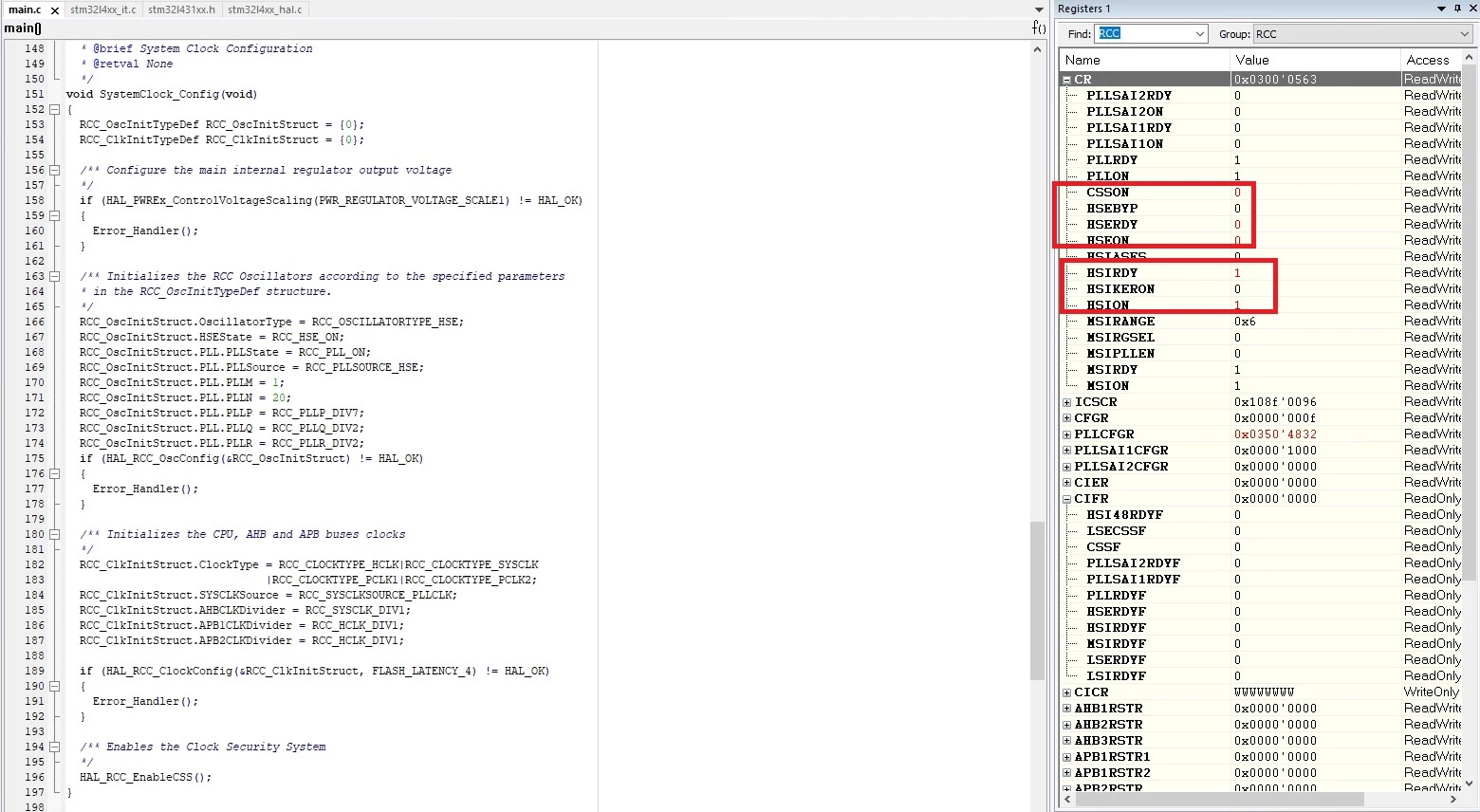

If you place an infinite loop just after the place where you've shown HSE working, will it switch to HSI?

Thanks @Tesla DeLorean and @waclawek.jan for your reply.

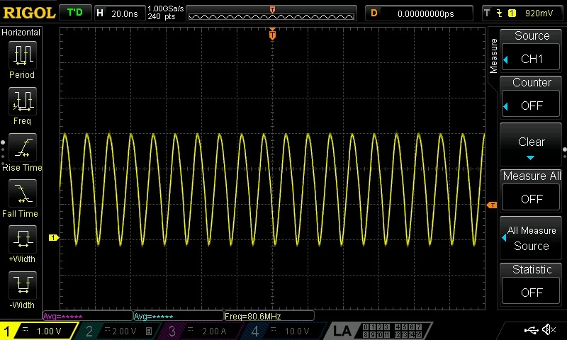

I enabled the MCO clock output Pin.
I did some tests with HSE and HSI, but the result is the same.
With this code and HSE enable:
int main(void)
 HAL_Init();
 SystemClock_Config();
 volatile uint32_t SysClockFreq = HAL_RCC_GetSysClockFreq();
 __NOP();
 while (1)
When I stopped at the breakpoint I saw the 80 MHz clock output:

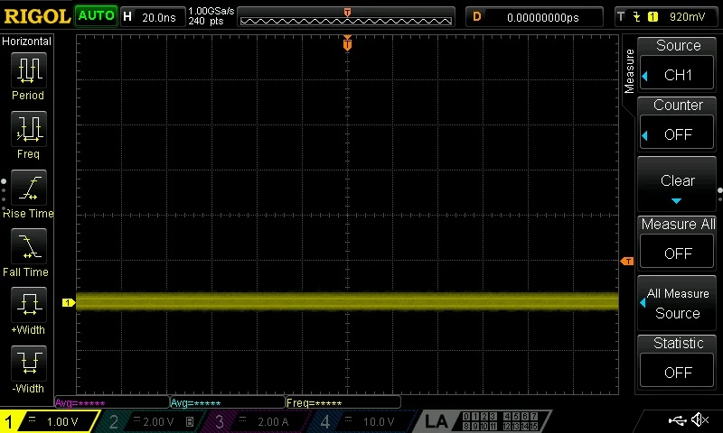

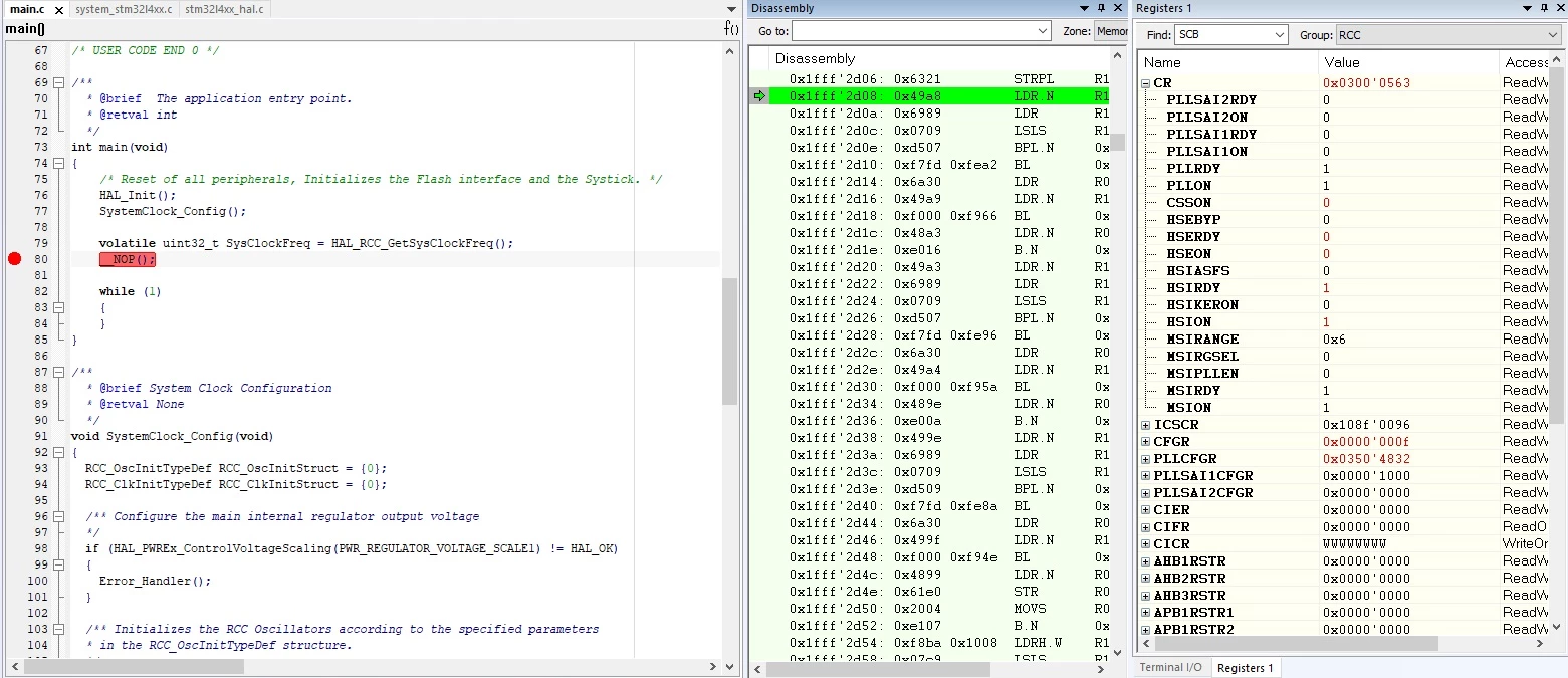

When I run the program the MCO clock output stops:
The function SysTick_Handler(void) is never called..
Any ideas?
Edodm85Author
October 24, 2023
Thanks @waclawek.jan
I forgot the pulldown resistor in the BOOT0 pin.
