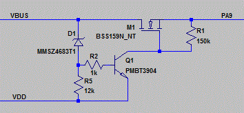

    Posted on September 02, 2015 at 22:30
    Regarding the first problem, here is what I came up with. I must say I am quite proud of it...
    When VBUS > VDD + ~3.6V, the zener triggers to the NPN which shuts the MOSFET off (this is a depletion MOSFET). This results in the PA9 PIN being kept at the threshold voltage of the MOSFET (max 3.5V) until the voltage difference between VDD and VBUS goes back to a safe level. At normal operation, this circuit leaks 1µA only through the zener, and the only other consequence is the Rds(on), so about 4 ohm, between VBUS and PA9.
    But I can't help thinking that it is overengineered, since that problem is certainly quite common, as it can easily happen on both bus-powered devices (during the time the regulator turns on), and self-powered devices (when it is shut down). Am I missing something ?
    EDIT: Except that if VDD > VBUS (batteries but no USB cable plugged), VDD seriously leaks through the 12k resistor. So instead of the 12k resistor, we need a lower value (like 5.6k) and a schottky with low leakage (BAS40 or something) with the cathode towards VDD... I told you this was overengineered...
