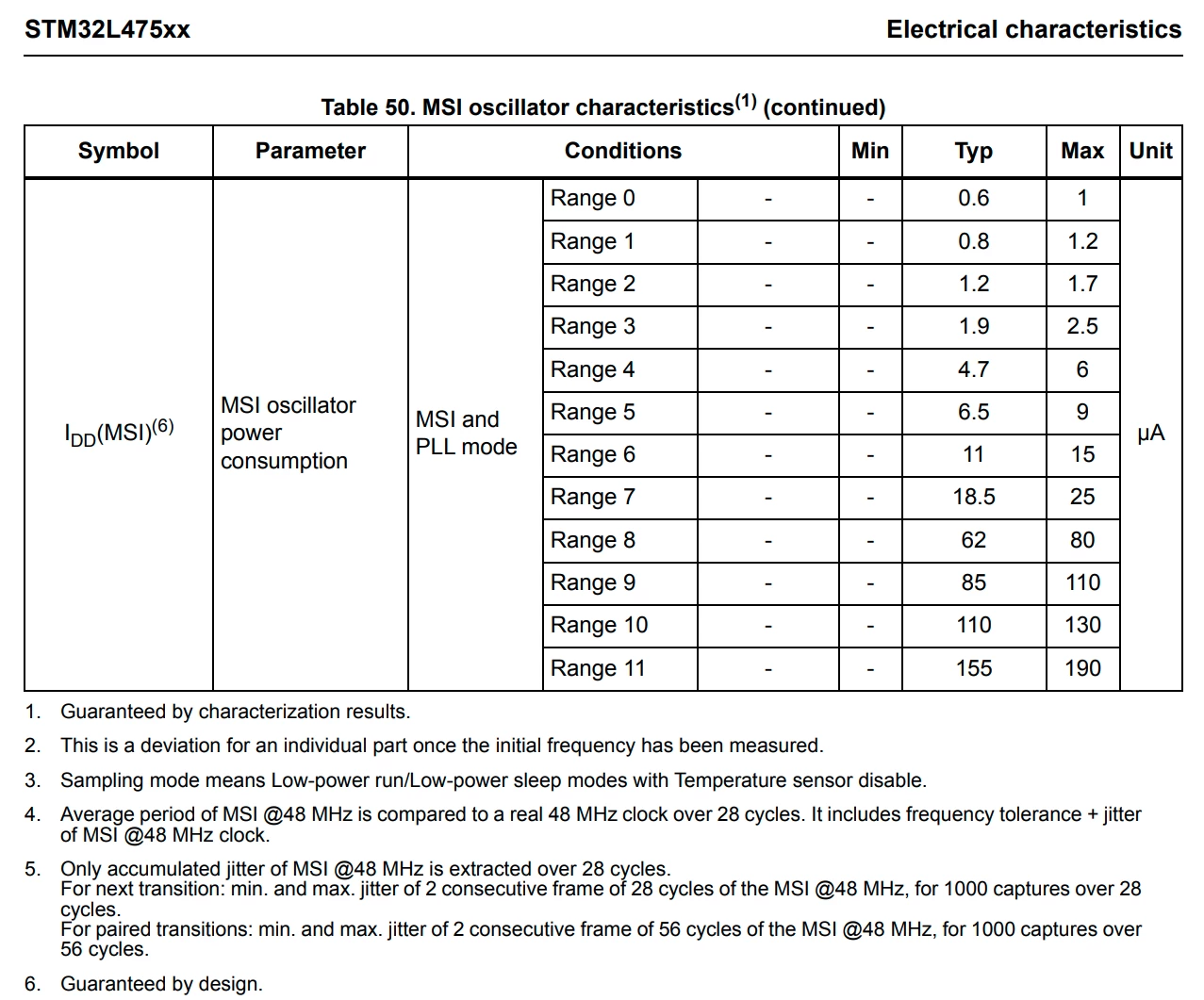

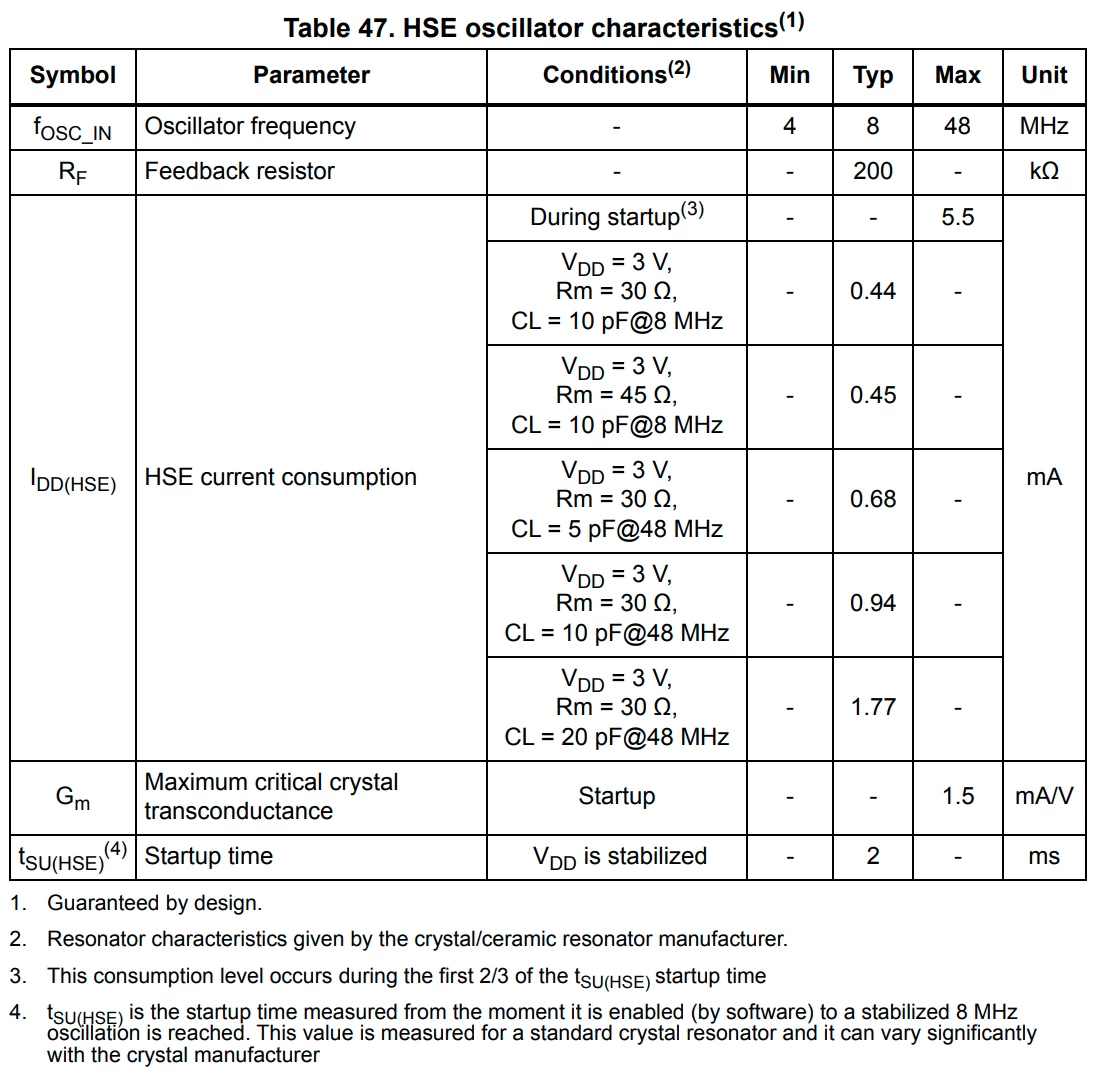

  1. Would it be better for power consumption to change HSE for MSI, and is it reliable for peripheral I use to work with MSI?
The datasheet includes detailed breakdown of current consumption by MSI and HSE. In general, MSI uses less power.
