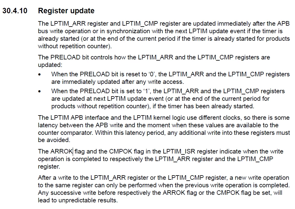

Troubleshooting, I found where it's timing out. On stm32l4xx_hal_lptim.c,, HAL_LPTIM_Counter_Start function, you can find this code:
 /* Load the period value in the autoreload register */
 __HAL_LPTIM_AUTORELOAD_SET(hlptim, Period);
 /* Wait for the completion of the write operation to the LPTIM_ARR register */
 if (LPTIM_WaitForFlag(hlptim, LPTIM_FLAG_ARROK) == HAL_TIMEOUT)
 return HAL_TIMEOUT;
There's application note AN4865 related to use LPTIM as a pulse counter and it doesn't say anything about LPTIM_ARR register neither LPTIM_ISR waiting for ARROK flag (4th bit). Also, on the example code, they expect a constant pulse signal arriving so this problem never happens.
If I comment if (LPTIM_WaitForFlag... block, it works perfectly.

The reference manual explains the logic happening here.
Code seems to be doing exactly what it should be doing, per the RM.

To what I understand than, the if block commented can cause "unpredictable results".
Would you have a recommendation to my use case? I'm not by far an electronics specialist, it's just a hobby for me, and I ran out of ideas.
I thought on an extra pin attached to the anemometer pin, I bit-bang some pulses (or get another timer to generate a slow PWM), starts the LPTIM, stop the pulses after the successful start and I would be good to go. But I think this is a very ugly hack.
