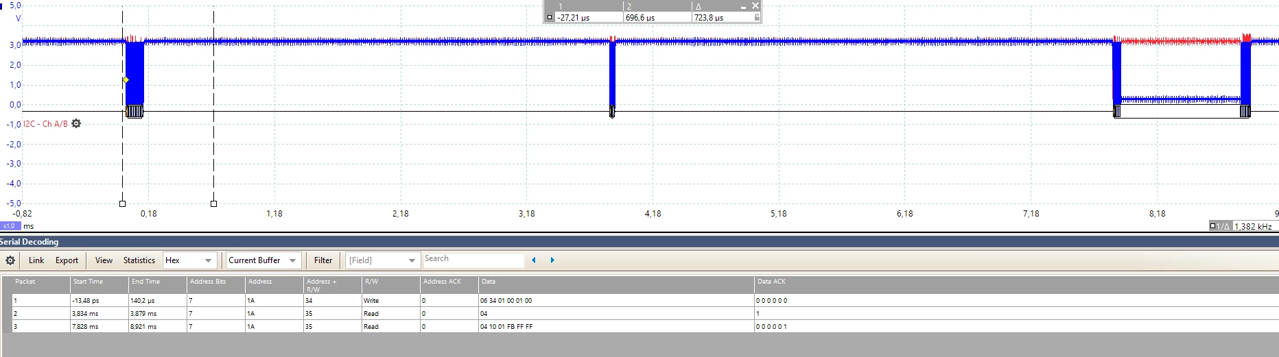

I am having an issue with I2C and hope someone can point me in the right direction.
I have an I2C master and two I2C slaves on a bus. The master sends a message to the slave and then reads back the response from the slave, which works.

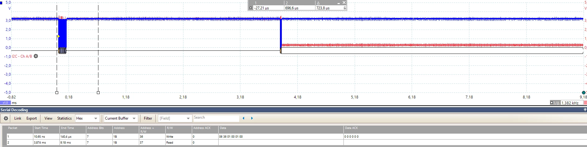

If I add the second slave to the bus, the Master can still talk successfully to the one slave, but with the second slave it can only transmit the message, when it tries to read the response the slave Acks its address, but then doesn't send back the data, keeping the clock low until a timeout is detected.
If I plug out the first slave, communication to the second one works without an issue.
I have set the Slave Addresses to 0x1A and 0x1B, which after left shifting equates to 0x34 and 0x36.
It seems like when wanting to communicate with second slave, the Write succeeds, then when wanting to read the response, the Address is Acked, but thereafter there is no clock being generated.

    I have resolved the issue, I have changed the second slaves' Address to something different (0x28<<1 = 0x50) and also changed to a Start - Restart rather than Start-Stop-Start sequence for reading.
