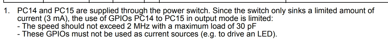

I want to use the OSC32_OUT Pin (PC15) of the STM32L432KC as general purpose output. Moreover i connected a FET with a pullup to this pin and want to control them. I do not use any LSE oscillator functionality. The datasheet states that upon reset this pin already can be used as GPIO if not configured as LSE and or controlled by the Backup domain.
If i use the generated CUBE IDE init code, i always face a Hard Fault in the HAL_GPIO_Init routine.

waclawek.jan
November 25, 2020
Try to set the given pin as outputting High (1) *before* setting it as output.
Visitor II
September 24, 2024
This is an old thread, but it appears on google searches.
Long story short, PC14 and PC15 can sink barely any current. Sink more and it causes glitches!
I've been battling a similar issue where toggling PC14 causes severe PC corruption and often a fault. The datasheet mentions once that PC14 and PC15 are connected to the internal power switch. This means that they can draw substantially less current. In other words, draw too much current from one of these pins and the CPU can glitch out causing faults, skipped instructions or corrupted registers.
