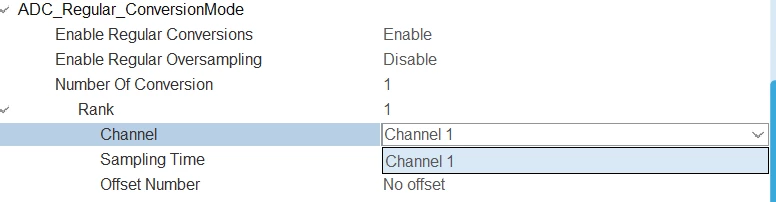

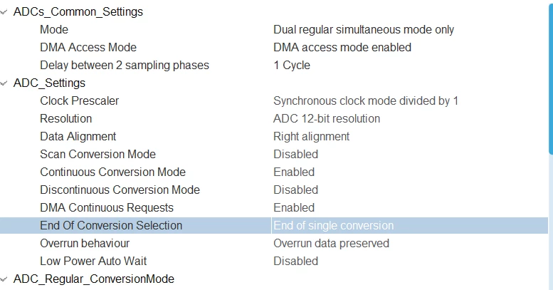

STM32L4 dual regular simultaneous mode using dual DMA as I don't want overrun of data. I want to know correct IOC setting for this mode.
I wanted to know how to configure the ioc setting for dual regular simultaneous mode. I want to use ADC1 and ADC2 together. After the correct ioc setting, how to know to code for this mode. I took help of the available resources but getting an error in

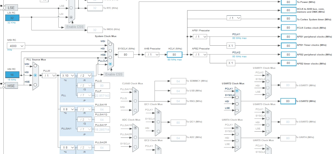

void PeriphCommonClock_Config(void)
 RCC_PeriphCLKInitTypeDef PeriphClkInit = {0};
 /** Initializes the peripherals clock
 PeriphClkInit.PeriphClockSelection = RCC_PERIPHCLK_ADC;
 PeriphClkInit.AdcClockSelection = RCC_ADCCLKSOURCE_PLLSAI1;
 if (HAL_RCCEx_PeriphCLKConfig(&PeriphClkInit) != HAL_OK)
  Error_Handler();
When I run the code in debug mode it goes in this error handler. I am not able to figure out why this is happening.
