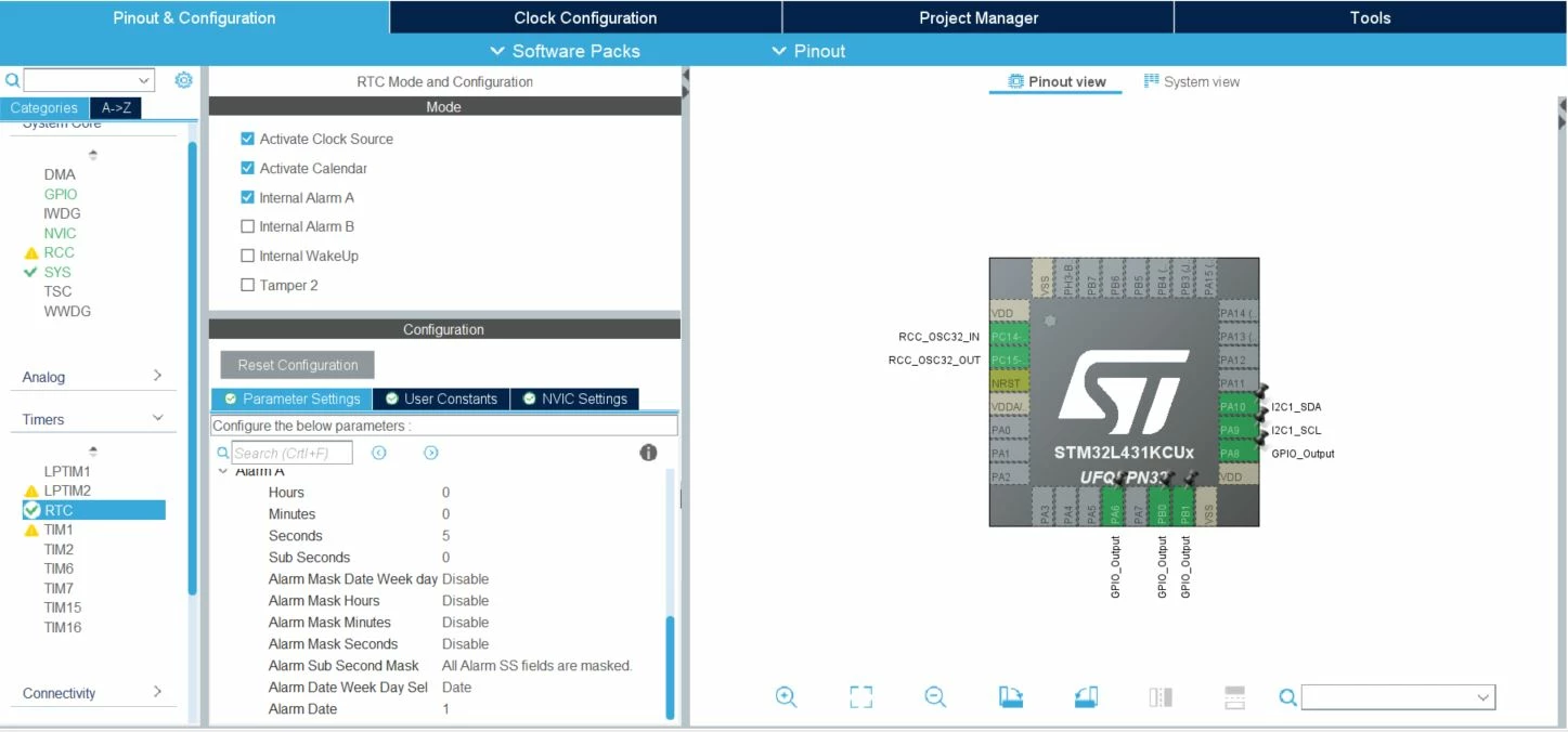

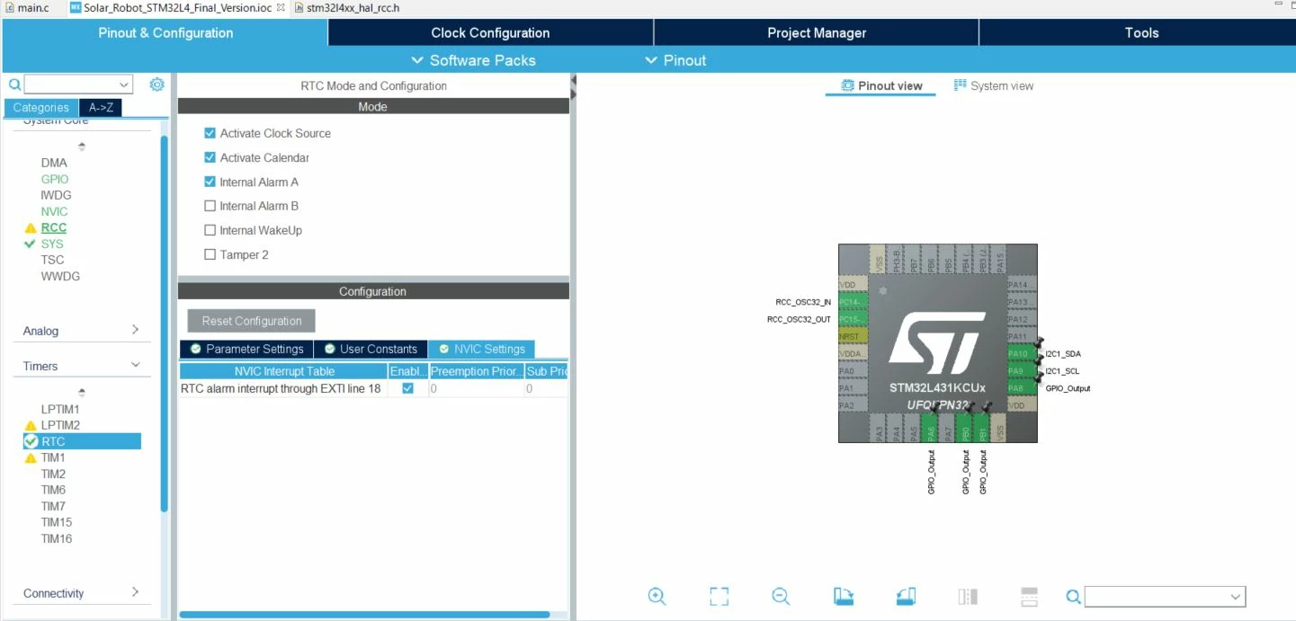

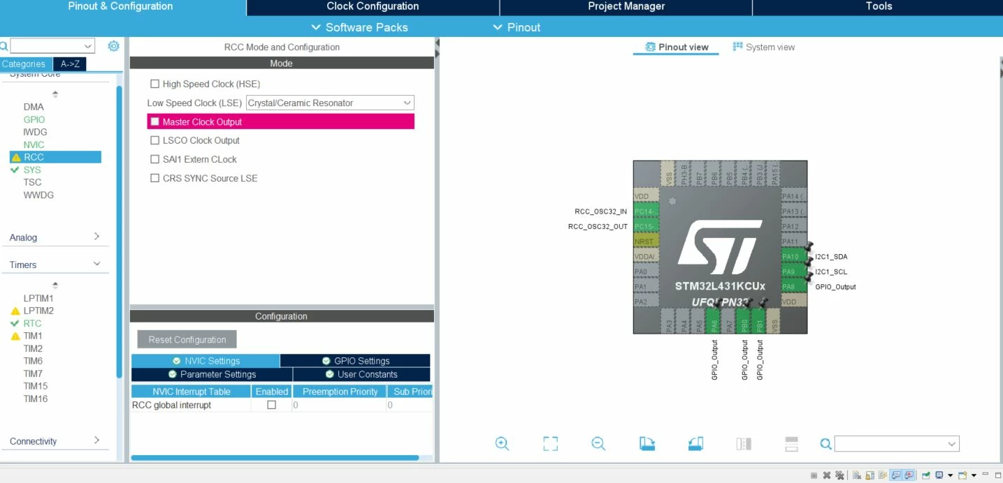

I am using STM32L431 and the device is not waking up from STOP mode with an RTC alarm interrupt. Can somebody pinpoint where my issues are?
My configurations in the code configurator:
I am enabling the crystal oscillator, enabling the calendar, alarm, and the interrupt through EXTI18, the only parameter I change is the time of the alarm set to 5 seconds.
This is what the code of the configurator looks like:

/** Configure LSE Drive Capability
HAL_PWR_EnableBkUpAccess();
__HAL_RCC_LSEDRIVE_CONFIG(RCC_LSEDRIVE_LOW);
RCC_OscInitStruct.OscillatorType = RCC_OSCILLATORTYPE_LSI|RCC_OSCILLATORTYPE_LSE
|RCC_OSCILLATORTYPE_MSI;
RCC_OscInitStruct.LSEState = RCC_LSE_ON;
RCC_OscInitStruct.LSIState = RCC_LSI_ON;
RCC_OscInitStruct.MSIState = RCC_MSI_ON;
RCC_OscInitStruct.MSICalibrationValue = 0;
RCC_OscInitStruct.MSIClockRange = RCC_MSIRANGE_6;
RCC_OscInitStruct.PLL.PLLState = RCC_PLL_NONE;

/** Enable the Alarm A
sAlarm.AlarmTime.Hours = 0x0;
sAlarm.AlarmTime.Minutes = 0x0;
sAlarm.AlarmTime.Seconds = 0x5;
sAlarm.AlarmTime.SubSeconds = 0x0;
sAlarm.AlarmTime.DayLightSaving = RTC_DAYLIGHTSAVING_NONE;
sAlarm.AlarmTime.StoreOperation = RTC_STOREOPERATION_RESET;
sAlarm.AlarmMask = RTC_ALARMMASK_NONE;
sAlarm.AlarmSubSecondMask = RTC_ALARMSUBSECONDMASK_ALL;
sAlarm.AlarmDateWeekDaySel = RTC_ALARMDATEWEEKDAYSEL_DATE;
sAlarm.AlarmDateWeekDay = 0x1;
sAlarm.Alarm = RTC_ALARM_A;
if (HAL_RTC_SetAlarm_IT(&hrtc, &sAlarm, RTC_FORMAT_BCD) != HAL_OK)
Error_Handler();
/* USER CODE BEGIN RTC_Init 2 */
/* USER CODE END RTC_Init 2 */
}And this is where I enter the stop mode:
