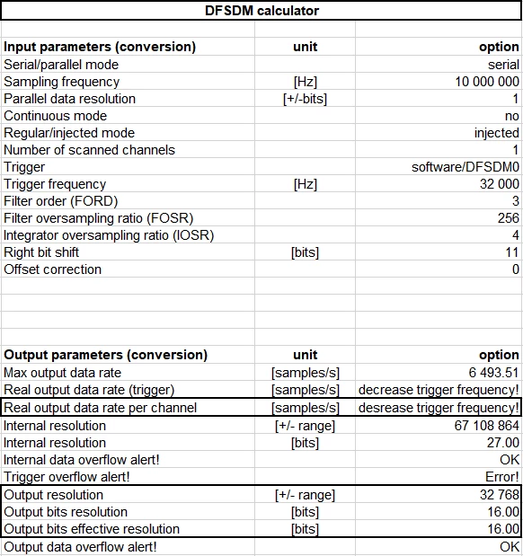

Any ideas why values would be non linear in the approximately the upper 1 to 2 bits?
For the setup below, it is linear to between -17000 to +14000. Doubling the + output only yields around +18000. These are raw values. This really acts like an overflow somewhere it seems to me. Test input is DC, in this case using an AMC3336 TI modulator.
What am I missing here?

The problem was that the common mode input range was exceeded on the Texas Instrument AMC3336 part, nothing to do with ST micro, but we can leave this alive it doesn't matter.
