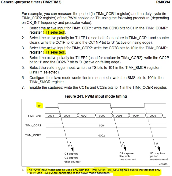

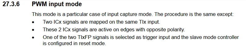

Hello Mete!
which pin should I connect the demodulated infrared signal at STM32L4 so I can use TIM2 as PWM input to capture the data stream.
You may use TIM2_CH1 or TIM2_CH2 as PWM inputs.
Inside of your device's DataSheet, you will find the exact pins which are connected internaly to theese TIM2 channels.
The next example is from RM0394
In same RM,   TI1 is the TIM2_CH1 pin and TI2 is TIM2_CH2 pin.
 this example uses  TI1 as the PWM input .
There are also working examples how to use PWM input at L4
https://my.st.com/content/my_st_com/en/products/embedded-software/mcus-embedded-software/stm32-embedded-software/stm32cube-embedded-software/stm32cubel4.html
Regards
vf

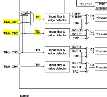

Atilla Mete Turedi
September 28, 2017
Posted on September 28, 2017 at 07:36
Dear Vangelis,
Thank you very much for your detailed response. I understand that the adjacent signal to the selected channel is also used for the PWM input because both edges need to be detected.
Does this mean that the pin the adjacent channel is connected cannot be used for other purposes?
Best Regards,
Mete
Vangelis Fortounas
September 28, 2017
Posted on September 28, 2017 at 15:20
Hello again.
It can used for other purposes yes. except TIM2_CHx because this functionality is connected internal to the other pin
x is the non used input.(1, or 2).
E.g. it can used as normal GPIO pin.
Regards
Vf
