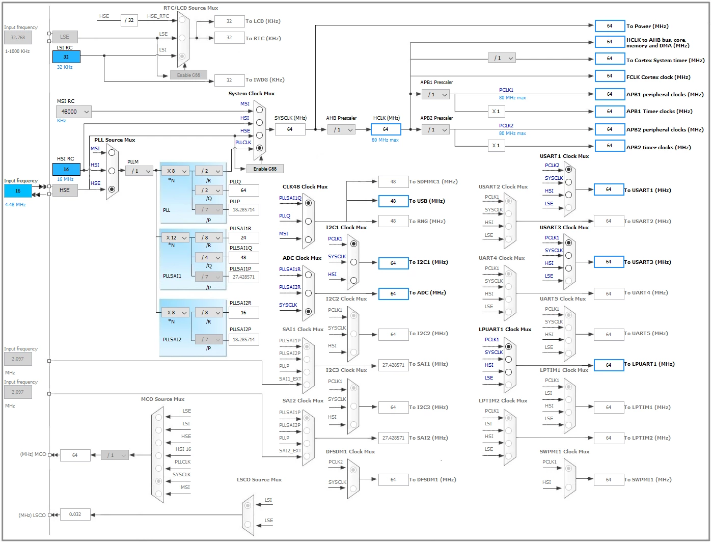

Hello All,
I am using STM32L486RGT, CubeMX 4.25 STM32L4 lib 1.11.
At the STM32 I have a 16MHz crystall connected.
Now I run into problems setting up the clocktree. It works under certain combinations but not under the ones I want.
I want to use the 16MHz crystal, HSE, PLL, USB and CPU running at 64MHz.
not working: 16MHz Crystal, PLLSource:HSE, PLLM:1, PLLN:8, PLLR:2, Sysclock:64MHz, PLLSAI1N:12, PLLSAI1Q:4, USB:PLLSAI1Q:48MHz

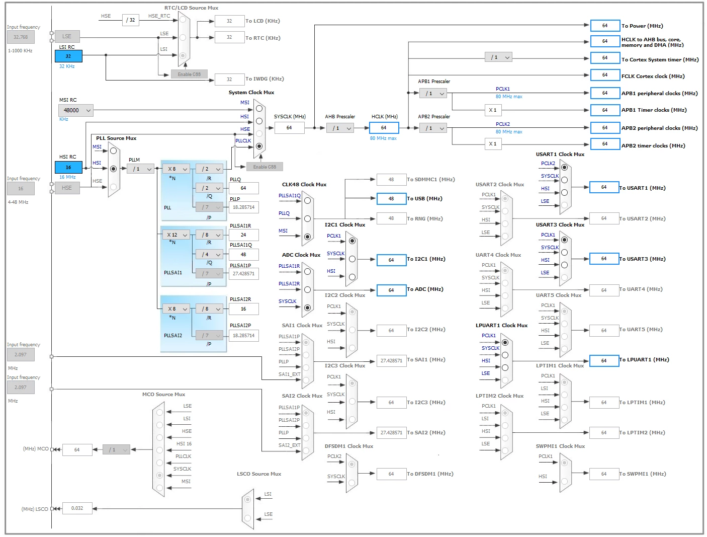

working: switching the PLL source to HSI

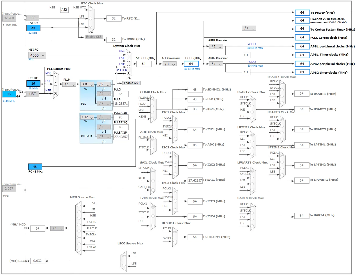

I tried also with Nucleo Board STM32L452 and found the combination does initially does not work.
I put an 16MHz crystal to the board.
not working: as above, plus USB, PLLSAI1N:2, PLLSAI1Q:4, USB:PLLSAI1Q:48MHz
On all examples: AHBPrescalers are 1 so all peripheral/core/sysclock clocks are 64MHz
Here is the example SysClock Init from the generated not working sample:
the failing function is:
Can anyone confirm those problems?
Regards, Adib.
