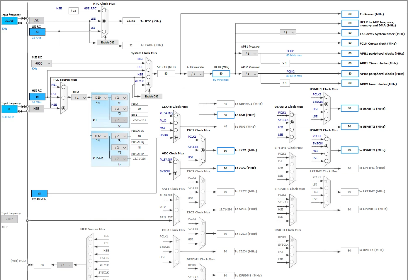

Hello there,
I am using STM32L452VET. I have generated the startup code using latest STM32CubeMX 4.22.1. Here is my clock config:
My problem is the following:
If I turn switch the compiler optimization flag to either:
  • -O1
  • -O2
  • -O3
The generated clock config works and the program starts.
If I turn the following flags:
  • -O0
  • -Os
  • -Og
The generated program will not work. The problem is with the PLL config part. The program (when debugging) will stop at this line and not move further, the MCU has to be reset:
MODIFY_REG(RCC->CFGR, RCC_CFGR_SW, RCC_ClkInitStruct->SYSCLKSource);
The SYSCLKSource is 3, meaning it is trying to make the PLL the main clock source. This is called from the  HAL_RCC_ClockConfig function which is located in stm32l4xx_hal_rcc.c file. Here are the parameters:

What could be the problem in here? Why cant the program run when using weak or no optimization?
I would appreciate all help, this is an urgent case for me.
PS: For the clarification, I did not write any code yet, everything is autogenerated from CubeMx.

what does your   RCC_OscInitStruct  look like?  Does it define PLL.PLLM?  this is a bug in the current CubeMX application.

You are right. The initialization of RCC_OscInitStruct.PLL.PLLM was missing in the generated code. After adding the line:
RCC_OscInitStruct.PLL.PLLM = 1;
Before the HAL_RCC_OscConfig, everything works. I am wondering why was it working on better optimization levels....
Anyways seems like it is a bug indeed. Thank you very much for help.

This is known bug
raised internally
and it will be fixed in our next release.
