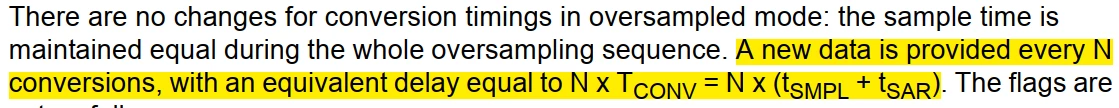

March 22, 2022
I did read the AN4629, but the way it is written does not make it clear for me the information you're providing. Also, the section from RM0394 below makes me think that the oversampling ratio (that in RM0394 is called N and in AN4629 is called OSR, great) does affect the effective sampling rate of the ADC. It takes longer to get a value, so with higher oversampling rate, the longer it takes to obtain a reading in the register.
I did some testing and indeed that is what happens, I could not correctly build a waveform when increasing the oversampling rate.
Thank you.
