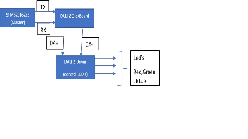

Thank you so much for your quick response. It helps me. I referred almost all the details given by you but i have a confusion let me explain my requirement.
i mentioned my req in previous post also .Please find the below image just for high level understanding
Kindly clarify me below points.
  • I am using STM32L162ZE using as a master and slave can be LED dimmer/DALI driver(as shown in image) but i found Slave_DALI library of STM32L152EVAL board from link provided by you in above post.
Do we have separate Master Library ...??? or Slave library only and its also just kind of application not Complete DALI library it seems is it right..???
  • We found the Libstock supported from Microelcetronika but for that we need to purchase MicroSDK IDE it does not suits for my requirement as i am using development in KEIL(MDK-ARM) already and here my basic question was
  • Does ST have all DALI Library Source code which works for my requirement(like master and slave complete DALI protocol) to develop my
application (like having HAL library) .....??? if available well and good i can go nearest office(as you provided link) and buy...please let me know technical contact.
  • If ST have Complete DALI library(DALI protocol)supports STM32L1xx we are planning to purchase and kindly provide the details.
  • meanwhile trying to contact sales team unfortunately no one picking call if any mailid please provide
  • Hope you understood my sincere concern kindly revert me asap.

Igor Cesko
Igor CeskoBest answer
Sep 11, 2020 12:14 PM UTC
The DALI library is only for the Slave - because master is more complex. DALI Slave device should support only limited functionality which is required for given function - usually some lamp dimming. In our DALI Slave library is implementation for the slave of type "LED" or "bulb" device with all necessary functions. Those slave device was tested in final customer application.
The DALI master should cover all possible DALI slaves and commands (for all DALI slaves - as: dimmers, switches, all types of light sources, ... ). DALI master is more application specific and usually integrates user interface (keyboard, display, ... ) with given application specifics. It is usually more complex and it is not included in the STM32 DALI Slave library.
Our DALI Slave library was originally written for lower end STM8S devices and then ported to STM32 devices. The source codes can be downloaded after login/register. The porting to another devices is simple - because the DALI stack is the same and what need to be ported is the hardware layer (HAL) - which controls the communication through GPIO pins: transmit/receive. Code is not using STM32 HAL - because at development time the STM32 didn't exists yet (but HAL layer should be used only for the hardware layer, the DALI stack is pure software).

Igor Cesko
Sep 16, 2020 12:15 PM UTC
We have only DALI Slave implementation (not a master).
The source files can be downloaded from this webpage:
https://www.st.com/content/st_com/en/products/embedded-software/evaluation-tool-software/stsw-dali002.html
... after registration.
Can you download those source files?
The DALI Slave implementation can be used as starting point to start implementation of DALI master. Simple DALI master is possible to implement by modification of the DALI Slave source files. But you must study DALI master requirements in the DALI specification.
