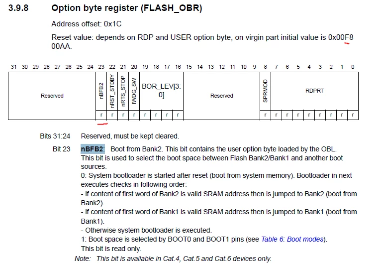

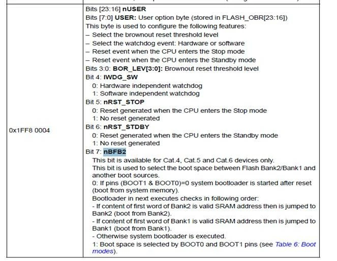

STM32L151VE optionbytes "nBFB2" bit question
Hi sir,
I ask a question about optionbytes nBFB2 of STM32L151VE.
I checked User Manual and wanted to confirm some information about nBFB2.
1) Option byte register (FLASH_OBR) : bit nBFB2 default value = 1 , see attached file optionbytes_1.png
2) Option byte memory address 0x1FF8 0004H : read bit7 = BFB2 value, but there is no default value describtion about this bit.
My question:
1) Which default value is nBFB2 ? 0 or 1 ?
2) If user read address 0x1FF8 0004H to get bit7(nBFB2) = 0, then try to write 1 using FLASH_OB_BORConfig(), MCU should does a reset behavior , right?
After MCU reset, then read this address again, user should get bit7(nBFB2) = 1, then code execute users app code.
Is my understanding right or not? If right, where i could get this information description on ST spec? Would you mind give me the link?

I'm having the same issue.STM32L151RET6,nBFB2,default value maybe is 1, but some is 0, so the mcu reset and rest.
