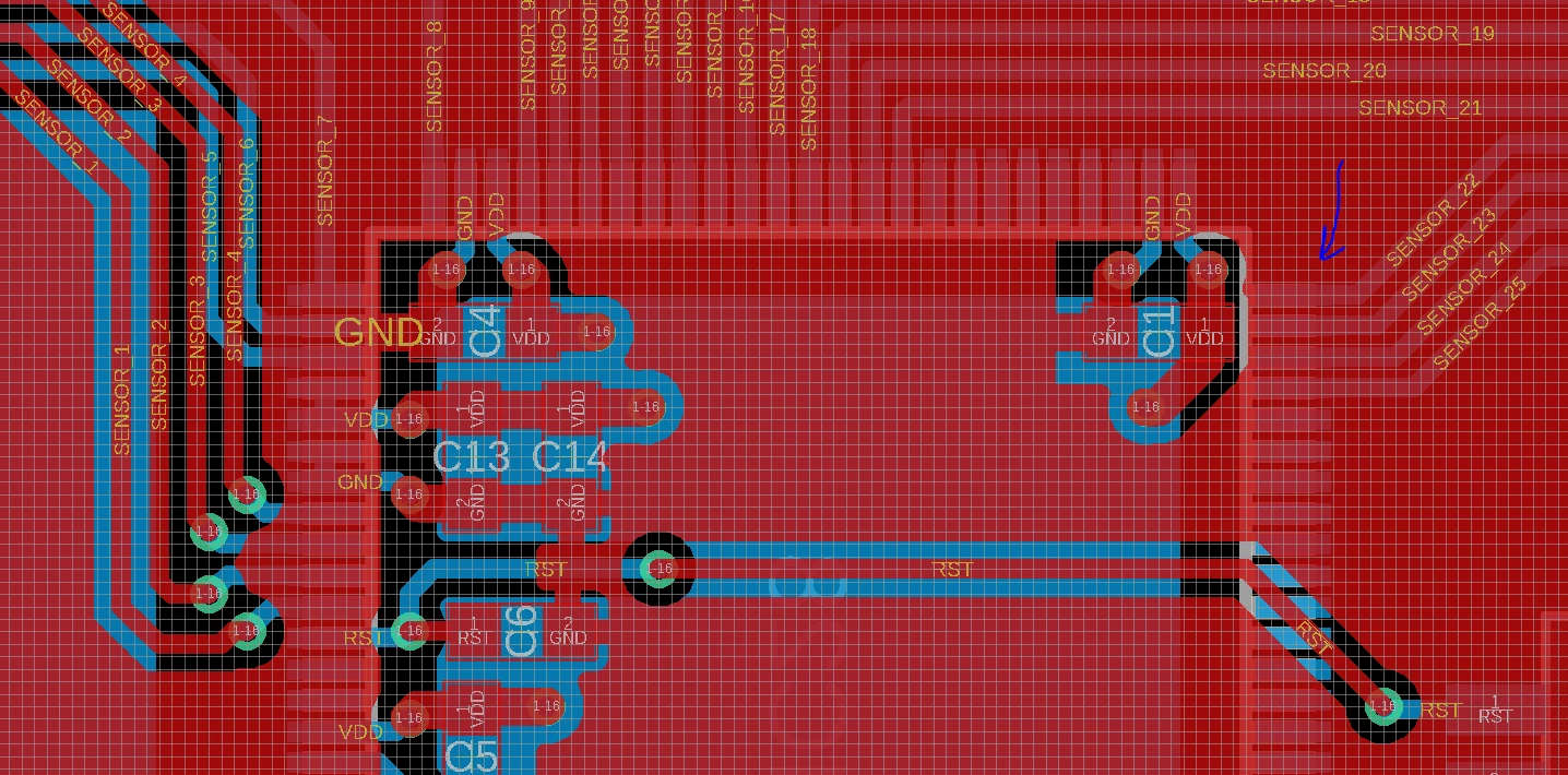

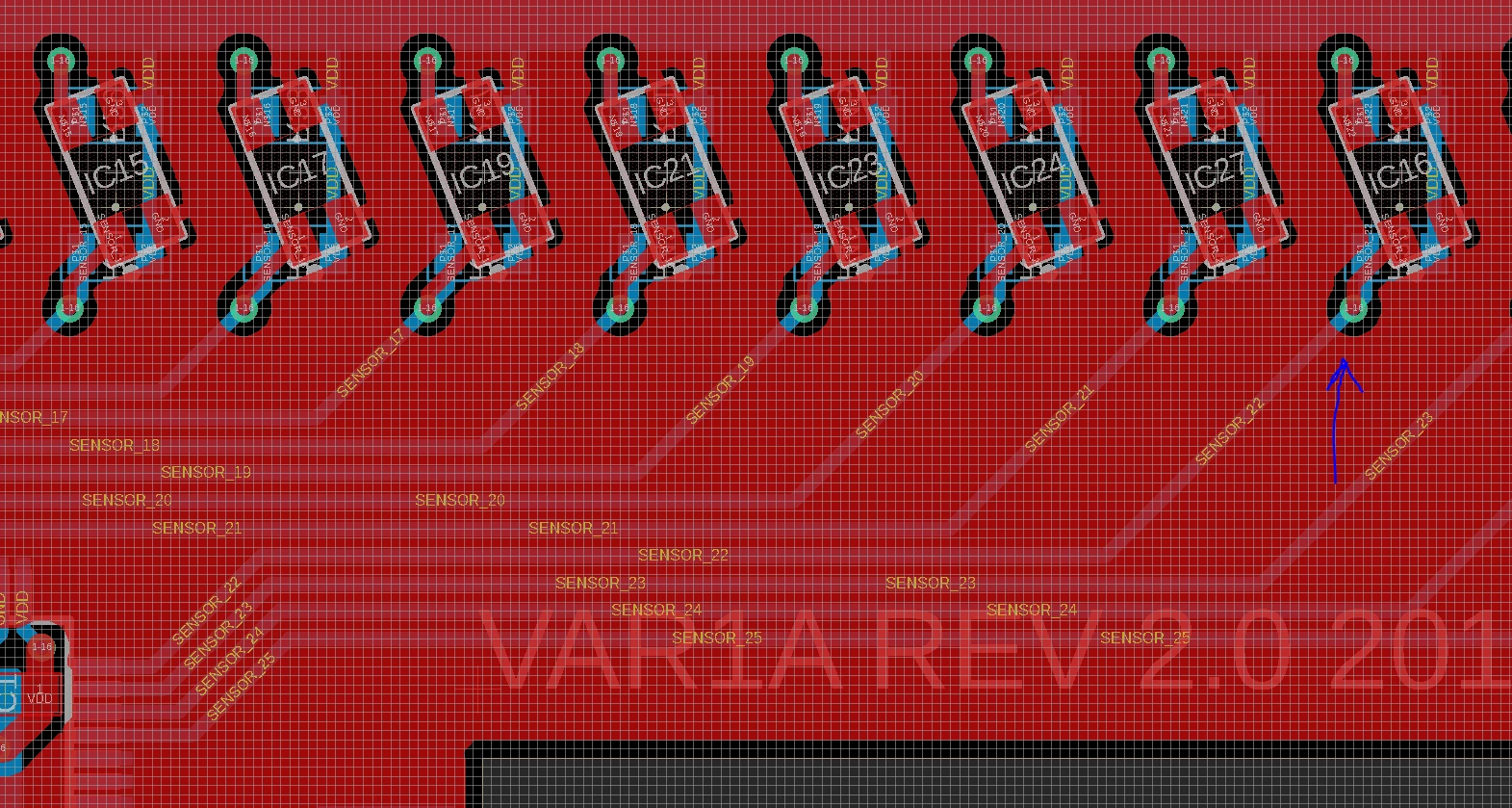

STM32L151VE ADC reads 20% lower value on one of the ADC inputs (channel 18, pin B12)
Not sure if I messed something up. Signal is okay (on the pin). No differences with layout compared to other inputs. ADC is at full speed (16 MHz).
On image it is sensor 22 (reads ~2500). Sensor 23, 24, 25 all read normal values (~3000).
Voltages on all those pins is ~2.8V.
VREF, VDDA, VDD = 3.3V.

Uwe Bonnes
Chief
Mar 13, 2019 10:04 AM UTC
Your layout does not help to identify what Port Pins you use. How fast is your sampling? Maybe this is some issue with fast versus slow channels when sampling fast.

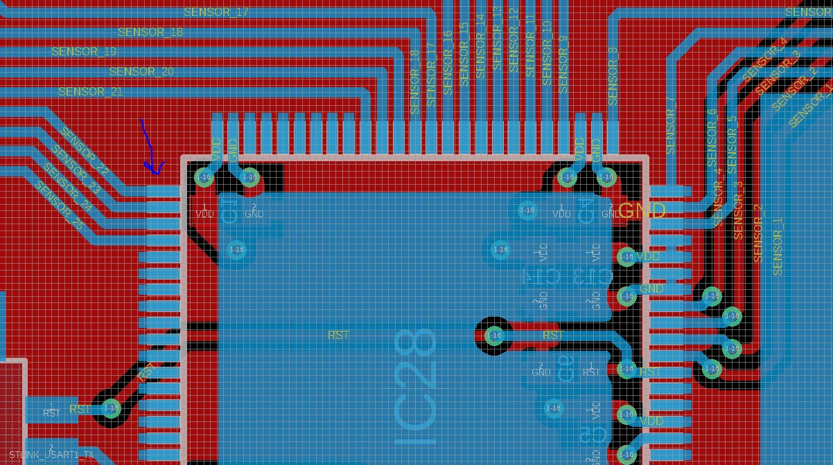

Can we see the top side of the PCB ?
Pavel Krupets
Mar 13, 2019 8:15 PM UTC
MikeDB
Senior II
Mar 13, 2019 8:17 PM UTC
Actually that's the best connected of the lot. Something the other end of the track maybe ?

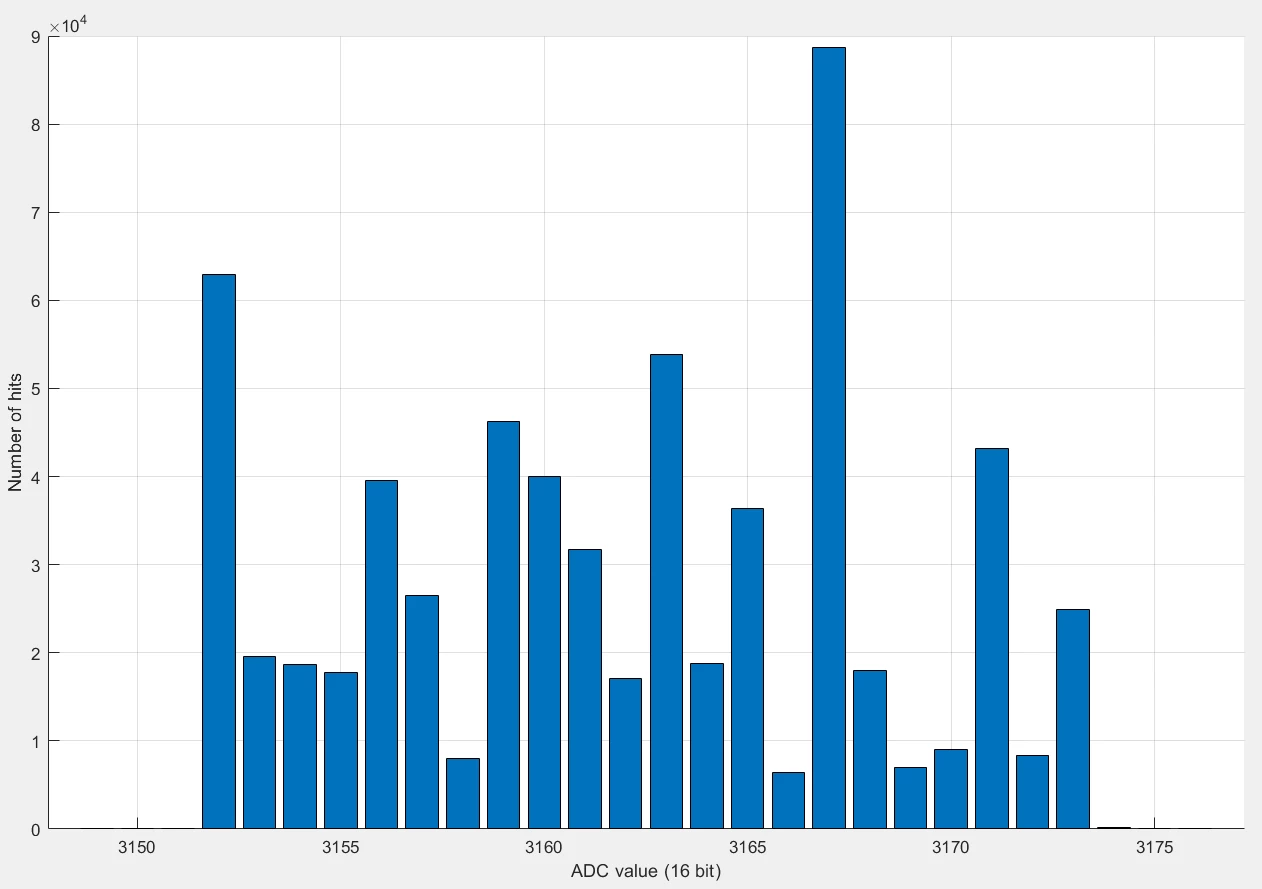

Was curious why this stuff can happen, might read it multiple times, it seems 2nd read is better than 1st. Similar to how 1st channel in sequence reads high consistently (10% higher than it should be). This is solved by reading the same channel again immediately after 1st read.
