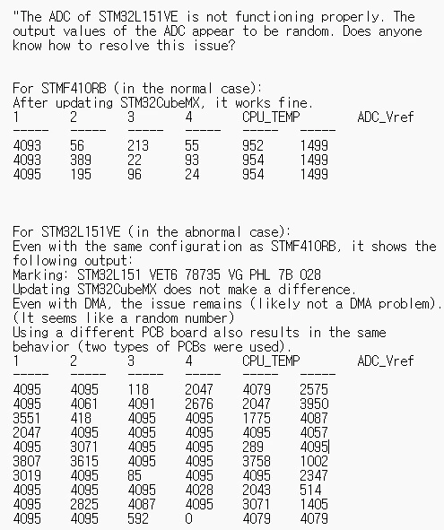

STM32L151VE ADC
"The ADC of STM32L151VE is not functioning properly. The output values of the ADC appear to be random. Does anyone know how to resolve this issue?

June 27, 2023
void MX_ADC_Init(void)
/* USER CODE BEGIN ADC_Init 0 */
/* USER CODE END ADC_Init 0 */
ADC_ChannelConfTypeDef sConfig = {0};
/* USER CODE BEGIN ADC_Init 1 */
/* USER CODE END ADC_Init 1 */
/** Configure the global features of the ADC (Clock, Resolution, Data Alignment and number of conversion)
hadc.Instance = ADC1;
hadc.Init.ClockPrescaler = ADC_CLOCK_ASYNC_DIV4;
hadc.Init.Resolution = ADC_RESOLUTION_12B;
hadc.Init.DataAlign = ADC_DATAALIGN_RIGHT;
hadc.Init.ScanConvMode = ADC_SCAN_ENABLE;
hadc.Init.EOCSelection = ADC_EOC_SEQ_CONV;
hadc.Init.LowPowerAutoWait = ADC_AUTOWAIT_DISABLE;
hadc.Init.LowPowerAutoPowerOff = ADC_AUTOPOWEROFF_DISABLE;
hadc.Init.ChannelsBank = ADC_CHANNELS_BANK_A;
hadc.Init.ContinuousConvMode = ENABLE;
hadc.Init.NbrOfConversion = 6;
hadc.Init.DiscontinuousConvMode = DISABLE;
hadc.Init.ExternalTrigConv = ADC_SOFTWARE_START;
hadc.Init.ExternalTrigConvEdge = ADC_EXTERNALTRIGCONVEDGE_NONE;
hadc.Init.DMAContinuousRequests = ENABLE;
if (HAL_ADC_Init(&hadc) != HAL_OK)
Error_Handler();
/** Configure for the selected ADC regular channel its corresponding rank in the sequencer and its sample time.
sConfig.Channel = ADC_CHANNEL_19;
sConfig.Rank = ADC_REGULAR_RANK_1;
sConfig.SamplingTime = ADC_SAMPLETIME_384CYCLES;
if (HAL_ADC_ConfigChannel(&hadc, &sConfig) != HAL_OK)
Error_Handler();
sConfig.Channel = ADC_CHANNEL_20;
sConfig.Rank = ADC_REGULAR_RANK_2;
Error_Handler();
sConfig.Channel = ADC_CHANNEL_21;
sConfig.Rank = ADC_REGULAR_RANK_3;
Error_Handler();
sConfig.Channel = ADC_CHANNEL_23;
sConfig.Rank = ADC_REGULAR_RANK_4;
Error_Handler();
sConfig.Channel = ADC_CHANNEL_TEMPSENSOR;
sConfig.Rank = ADC_REGULAR_RANK_5;
Error_Handler();
sConfig.Channel = ADC_CHANNEL_VREFINT;
sConfig.Rank = ADC_REGULAR_RANK_6;
Error_Handler();
/* USER CODE BEGIN ADC_Init 2 */
ADC_sConfig=sConfig;
/* USER CODE END ADC_Init 2 */
